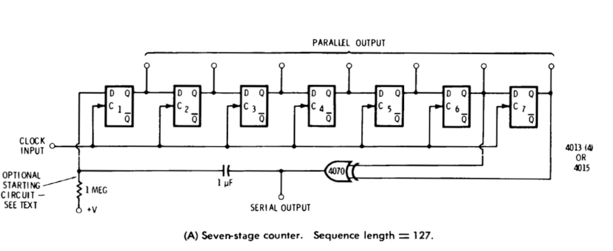

PostPosted: Wed Jun 21, 2023 2:08 pm    Post subject: Reply with quote  Mark this post and the followings unread
I used this circuit. Instead of 4013s I used 4015s, which was suggested as an option in the text. This means the outputs bar two on each 4015 are floating, but there aren’t any floating inputs.

PostPosted: Wed Jun 21, 2023 2:41 pm    Post subject: Reply with quote  Mark this post and the followings unread
what are pin 6,14 of the 4015 connected to ? and how is the clk input connected ?

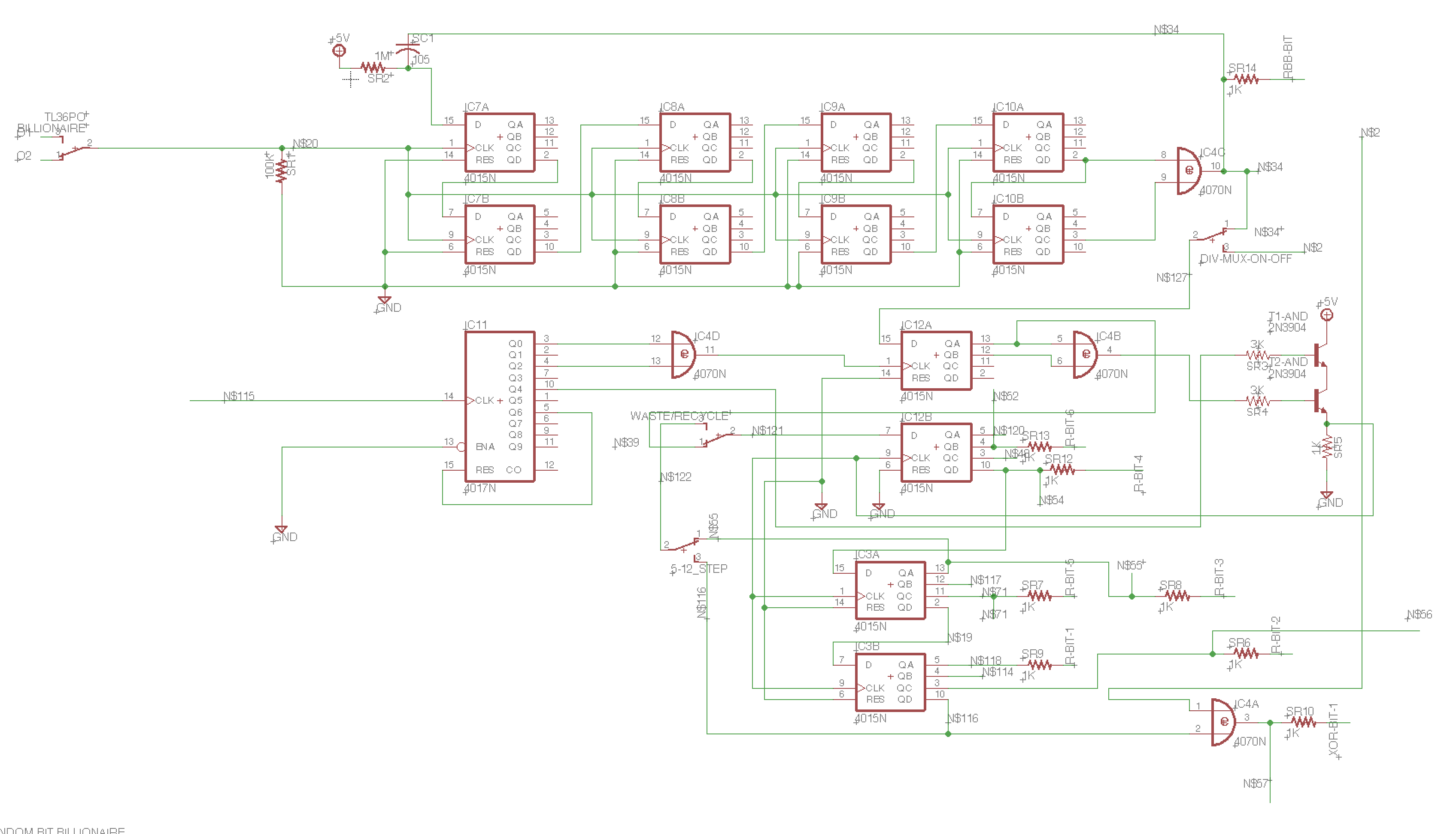

PostPosted: Wed Jun 21, 2023 11:58 pm    Post subject: Reply with quote  Mark this post and the followings unread
This is how I hooked up the circuit

PostPosted: Thu Jun 22, 2023 12:00 am    Post subject: Reply with quote  Mark this post and the followings unread

PostPosted: Fri Jun 23, 2023 6:31 am    Post subject: Reply with quote  Mark this post and the followings unread
so far so good, though 1M (SR2) could be too high to keep the data input stable.
I am actually wondering what the reason is behind having is connected through a capacitor, usually it's just connected directly.
I guess it might have something to do with that "optional starting circuit". You could try bridging that cap to see if that helps.
In the video it looks more like an issue with the CLK though, unless it's running at a high frequency.
Also, does IC4 have any unused XOR gates and if so did you ground the inputs of those as well ?

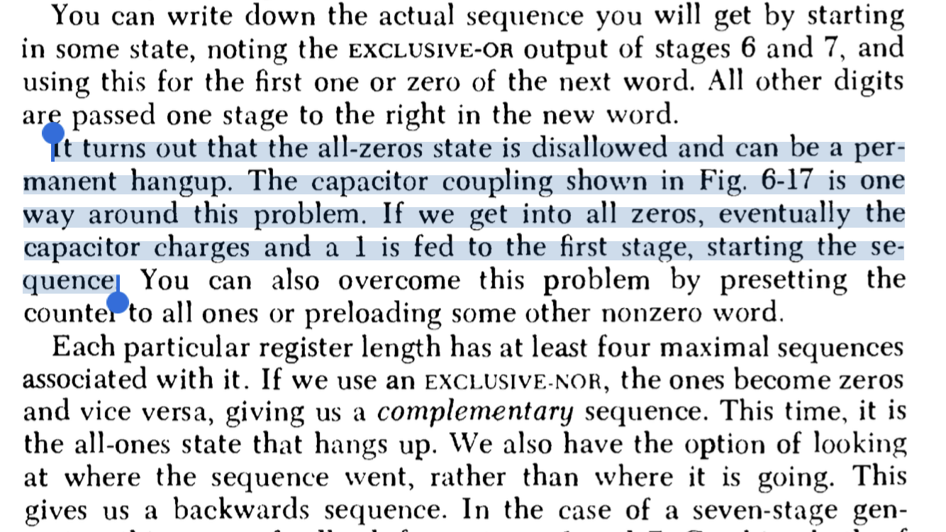

PostPosted: Fri Jun 23, 2023 11:43 pm    Post subject: Reply with quote  Mark this post and the followings unread
The clock is running at a high frequency (101/102 cap and 1m pot). As for the 1uf cap 1m resistor circuit:

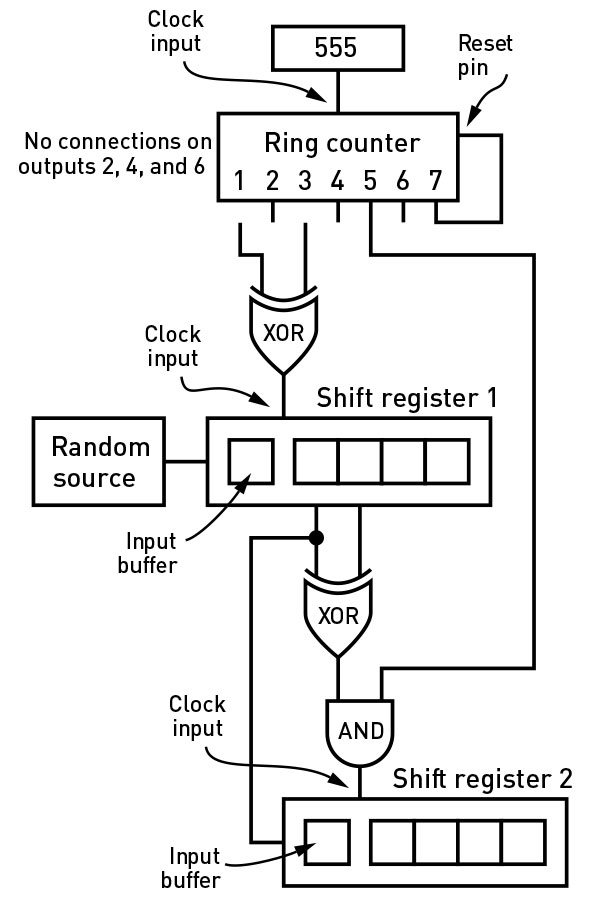

PostPosted: Fri Jun 23, 2023 11:48 pm    Post subject: Reply with quote  Mark this post and the followings unread
The other XOR inputs aren’t floating either, they are used in another circuit:

PostPosted: Fri Jun 23, 2023 11:51 pm    Post subject: Reply with quote  Mark this post and the followings unread
The second circuit is this one: https://makezine.com/projects/really-really-random-number-generator/

PostPosted: Sun Oct 22, 2023 12:50 am    Post subject: Reply with quote  Mark this post and the followings unread
The shift register needs to be "seeded" to start. I noticed the capacitor polarity is reversed in your drawing. You might also want to buffer the output depending on its load
