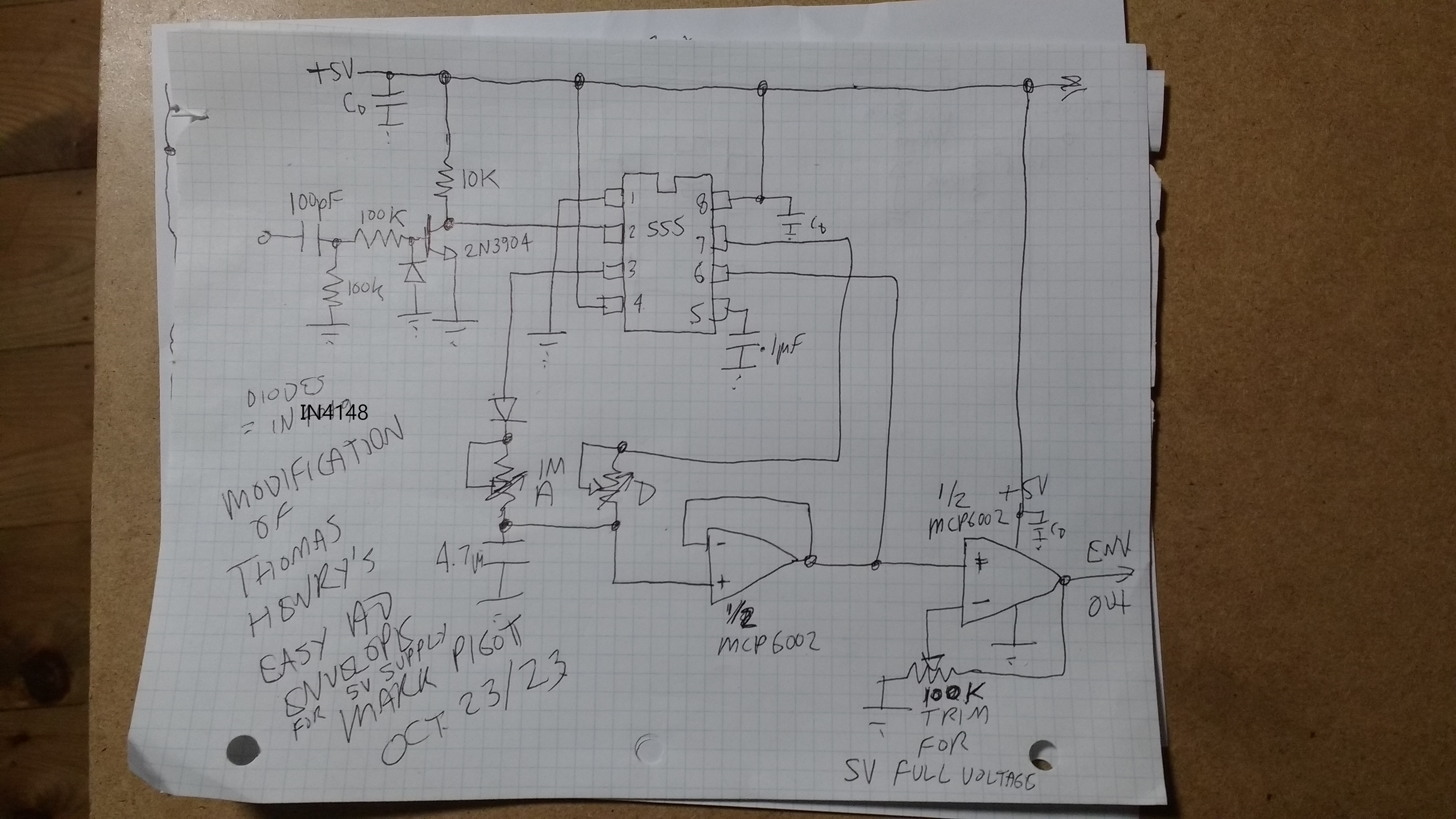

Can this circuit be adapted to single supply 5V?
Thanks
Steveg
Joined: Apr 23, 2015
Posts: 184
Location: Perth, Australia
PostPosted: Mon Oct 23, 2023 3:47 am    Post subject: Reply with quote  Mark this post and the followings unread
I don't see why not ... you would have to replace the op-amp but that is just a buffer so a transistor wired as an emitter follower might work. Would you see meaningful output ... maybe, what would you drive from it?

I am working on some 5V Lunetta circuits.
Thanks
zaphod betamax
Joined: Nov 27, 2020
Posts: 62
Location: sarnia
PostPosted: Mon Oct 23, 2023 6:23 pm    Post subject: Reply with quote  Mark this post and the followings unread
Yes, i was easily able to adjust for 5V circuits.
I just had to provide some DC amplification with another op-amp
(a MCP6002) to bring the peak voltage up to 5V.
When I get it drawn up I will post.

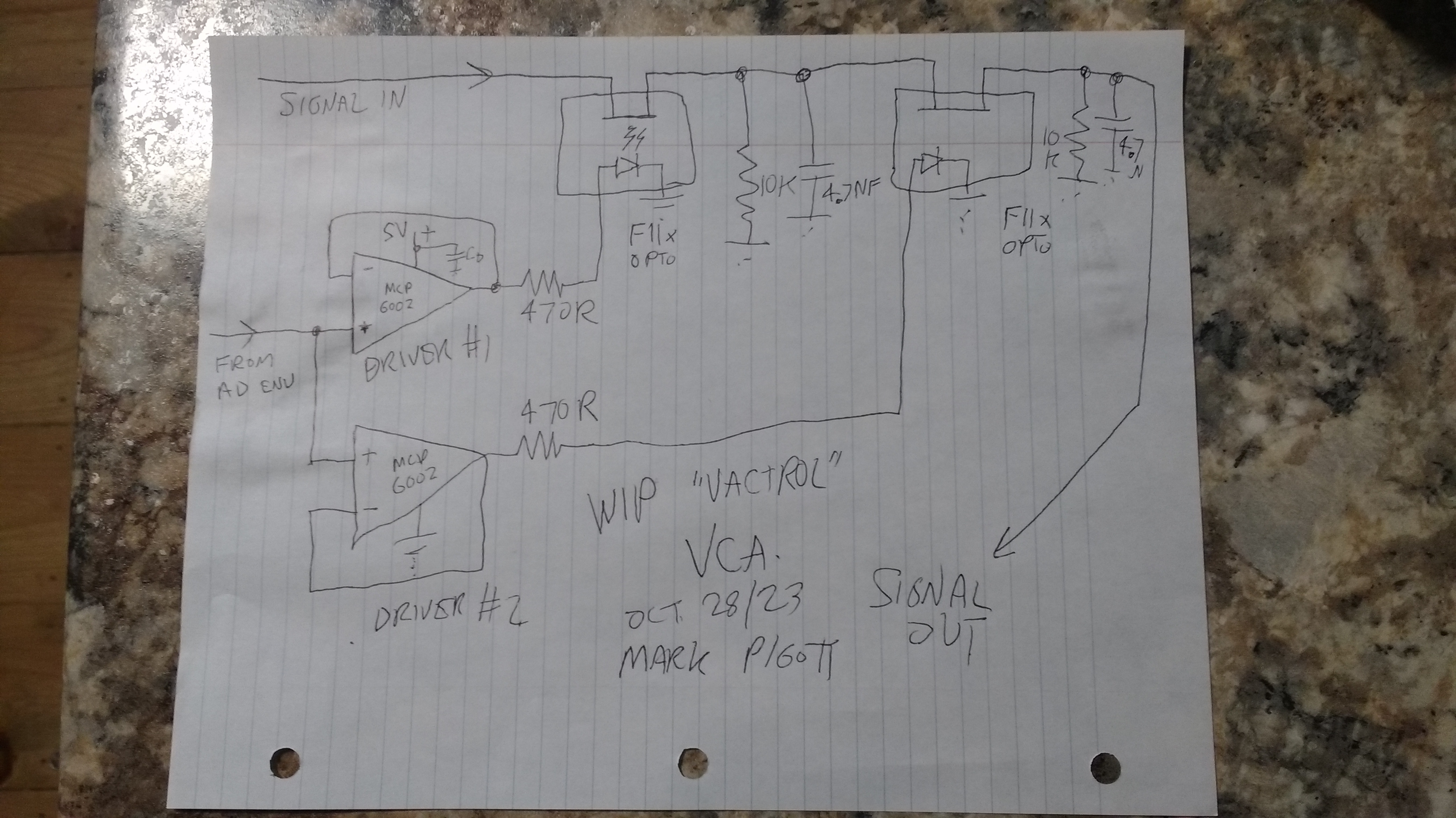

https://youtu.be/V4X5PL9fRY0
The forward breadboard contains an almost verbatim Thomas Henry 555 Easy Envelope circuit adapted for 5V by me.
The VCA section is my design with H11 MOSFET optoisolators as a 12db Low Pass Gate.
This has taken over a year of experimentation to get a VCA where the clicks are there when wanted, but can be dialed out when not required.
I used 1M linear trimpots to the AD, but I need to buy some 1M log pots for the final build of the Envelope/VCA.

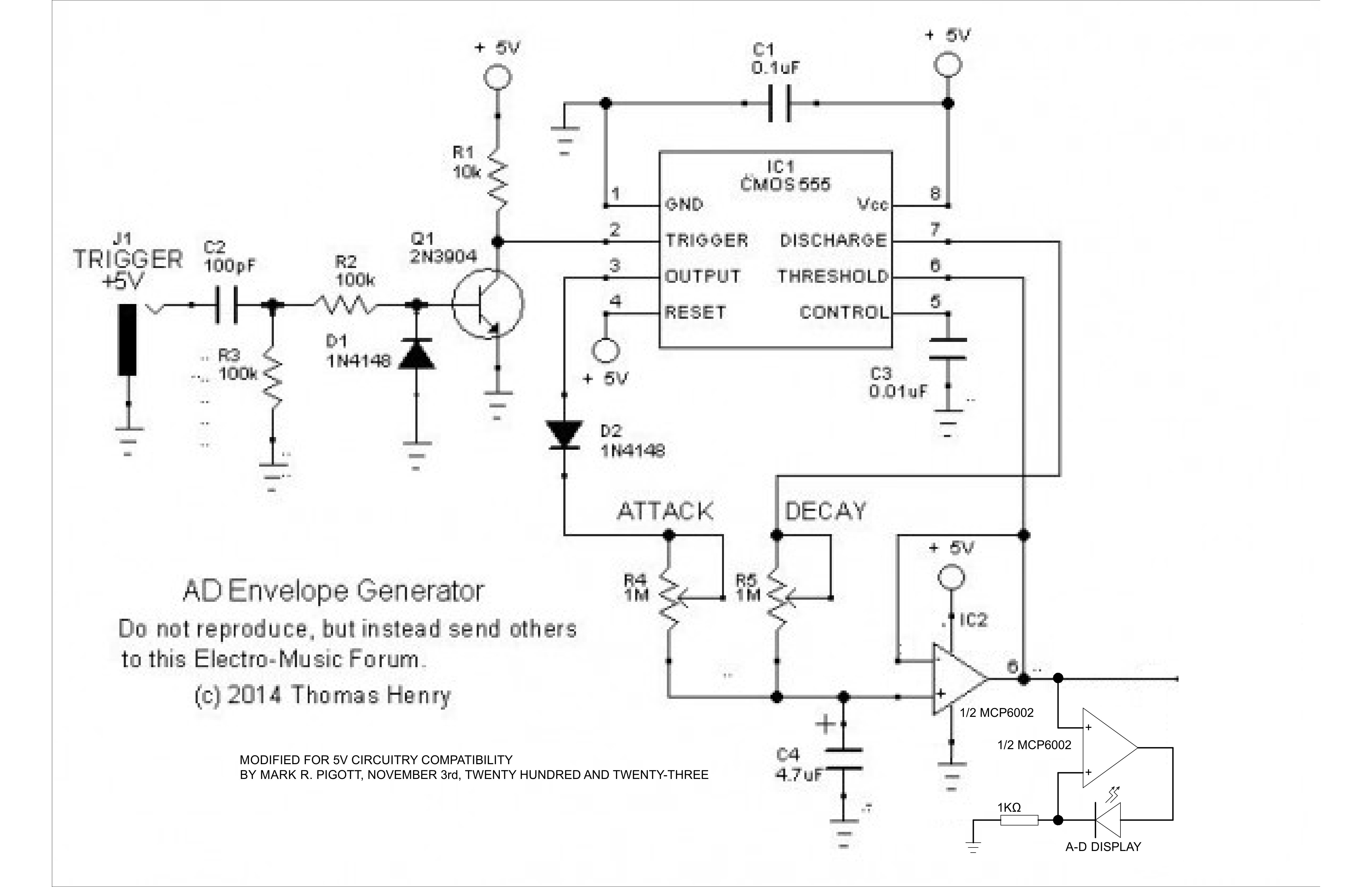

Here is my 5V revision on the circuit. Fully tested. Works nice!

-I also add in built-in Monotribe noise.
-The signal out goes into a 5V version of the Thomas Henry Simple AD envelope generator controlling a "Faux Vactrol Voltage Controlled Attenuator" (FV2CA) with an H11 photofet as a cheapo low pass gate. (This is on the closer breadboard, when pictured)
-Do not feed the Monotribe after midnight.
