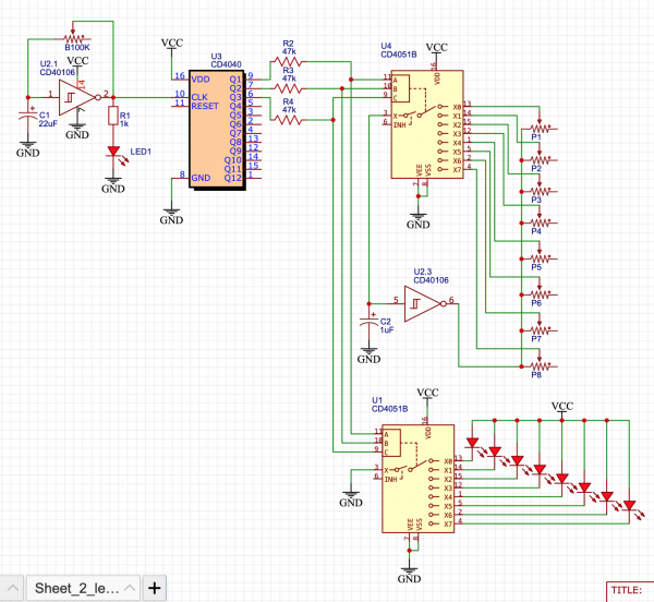

I have build 8 steps sequencer using 40106, 4040 and 4051 (See attached schematics)
However I would like to make it more 'musical' by adding a decay for each note that is playing.
What is the simplest way to implement that?
Any suggested schematics?
