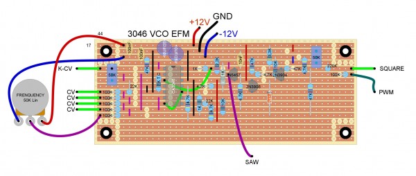

Hello everyone.
I dug up this post, I mounted this VCO on veroboard but it doesn't work, no sawtooth or square output, has anyone managed to make it work? I rechecked the assembly and the components, nothing can be done, it doesn't work and I can't find the problem Embarassed

Hi!
The timing capacitor must be 10pF (CA3046 has a thin/poor sound, CA3086 or dual matched BC transistors will sound fat).

PostPosted: Mon Apr 01, 2024 1:39 am    Post subject: Reply with quote  Mark this post and the followings unread
I replaced the capacitor with a 10pf but nothing works, it still doesn't work, I don't understand anything, I double-checked everything

PostPosted: Fri Apr 05, 2024 6:15 pm    Post subject: Reply with quote  Mark this post and the followings unread
back on the assembly, it did not work because I had put a 10pf capacitor, with a 10nf it works. It is not possible to have a good calibration of the notes,my transistors are nevertheless well matched, I do not understand why I do not obtain a good adjustment of the notes? I do not know the initial frequency of adjustment of the frequency potentiometer, at what frequency should it be adjusted to obtain a good adjustment of the scale of the notes?

PostPosted: Fri Apr 05, 2024 10:51 pm    Post subject: Reply with quote  Mark this post and the followings unread
With 10pf ceramic disc capacitor for timing and CA3086 3.5 octaves are traceable... perhaps with silver-mica it increases tracking.
Keep the PCB powered on for 30 minutes or more before calibrating (close windows or vents during calibration).
I don't remember... maybe I started with with C2 at the center of the potentiometer (because when calibrating it will move)... if there is a tempco installed and in contact with the differential... it will be possible to play with adjusting two reference notes/frequencies (C2-C4 for example) and when the two frequencies are calibrated the entire scale will be calibrated (20-30 minutes of work).
