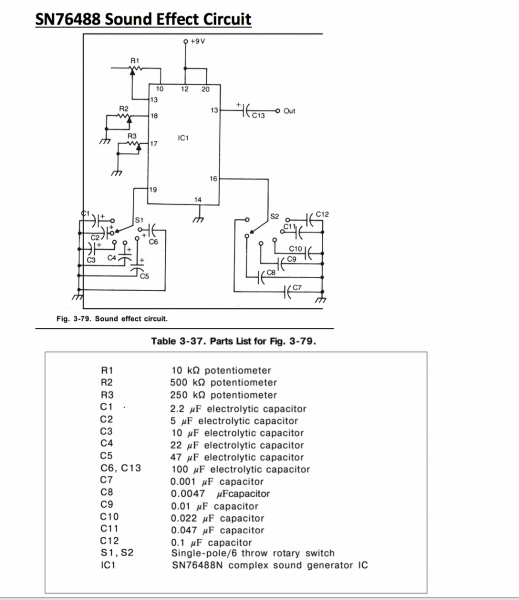

Thank you Achilies for linking to the Forest Mimms IC applications handbook that is really useful.
Hey Cementimental that Cinemagic soundbox article is excellent.
Achilies your pcb adapted from the soundbox looks great - it would probably save me a great deal of frustration if you would kindly share your layout Wink
Btw AchillesI recently read Delton Horn and recognise the comparison pinout page you linked to - have you seen his SN76488 example sound effect generator (fig. 3.79) - attached.

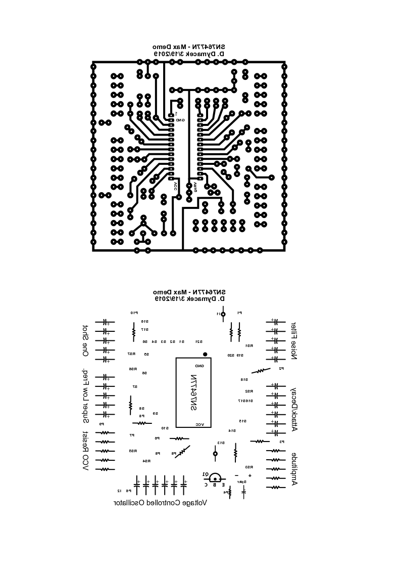

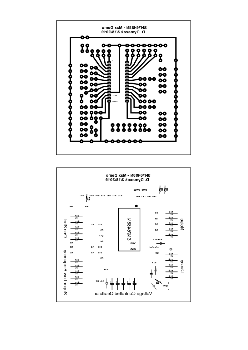

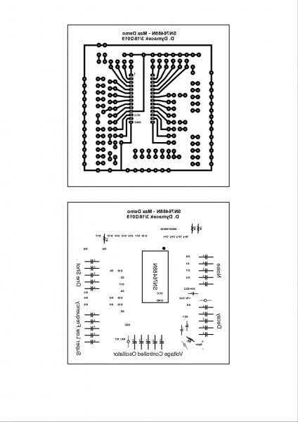

PostPosted: Fri Apr 12, 2019 5:37 pm    Post subject: My PCB layouts for SN76477 and SN76488 Reply with quote  Mark this post and the followings unread
Ok, here are my PCB layouts and silkscreens for both chips. I have yet to actually populate the boards and test either, so use at your own risk, and be sure to check all of the traces.
SVG files are not allowed, so these were saved as PNG files. Make sure to verify spacing, etc..
If you need the svg files, let me know, and I can post them on my website for download.

Nice!!! Thanks for sharing. Maybe this will inspire me to do something with my SN76477. It was moved from the back burner to the deep freezer decades ago, but it might be worth testing to see if it survived.
When Radio Shack closed most of its stores (all of them?) a few years ago, I picked up the "Electronic Learning Lab" for something like 80% off the list price (the one with two 8.5 x 11 Forrest Mimms Workbooks--reminders of the little books from ages ago which you can find on line).
The 555 LED test circuit on there has been collecting dust long enough. If I do replace it with the SN76477, I will owe you big thanks for reminding me of the chip!!

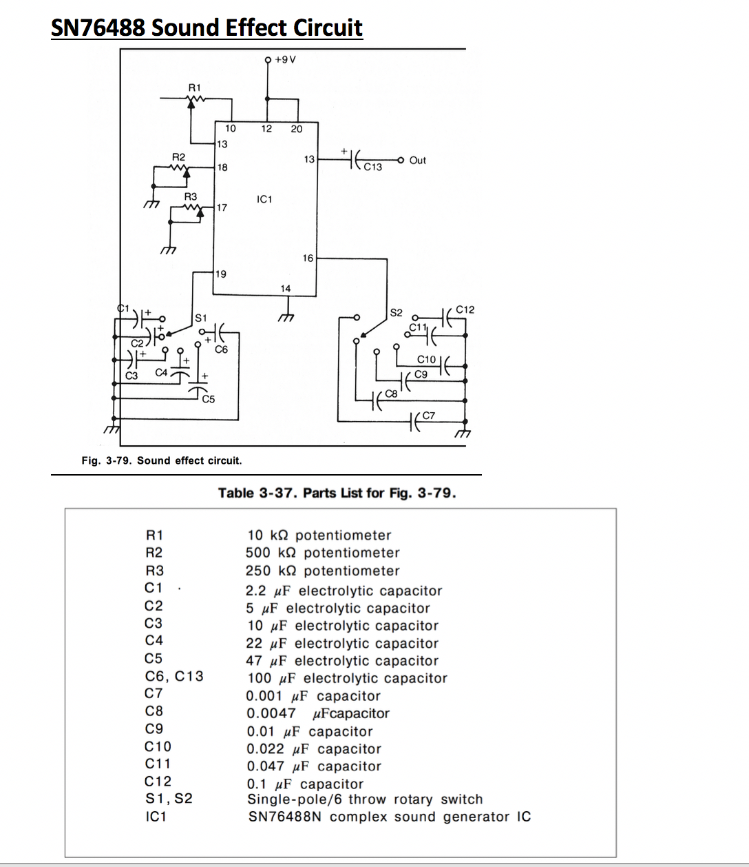

Yes - Thank You achilles and others.
Sorry for the delay in saying this - That is very kind and generous. I am at a bit of a diy impasse (long story) at the moment but hope to have things sorted out and will be building again soon.
Sending you good vibes
Hope it is helpful to post the schematic and relevant pages from the Radio Electronics magazine
(That 1984 Radio Electronics magazine is so interesting and I am so easily distracted!! I also included the next article on transistor switches to remind myself to read it properly!) Very Happy

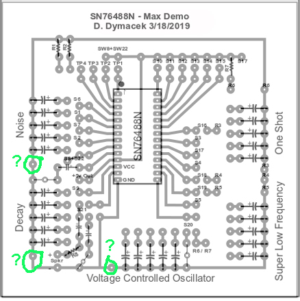

Hey achilles
Am nearly ready to try etching your SN76488 Sound Generator PCB Very Happy
Can you just first please explain to me what the ground connections next to the Noise, Decay and VCO capacitors. To switch them off?
I have highlighted them in green so you know what I am asking about.
Hope you are having a good weekend Very Happy
