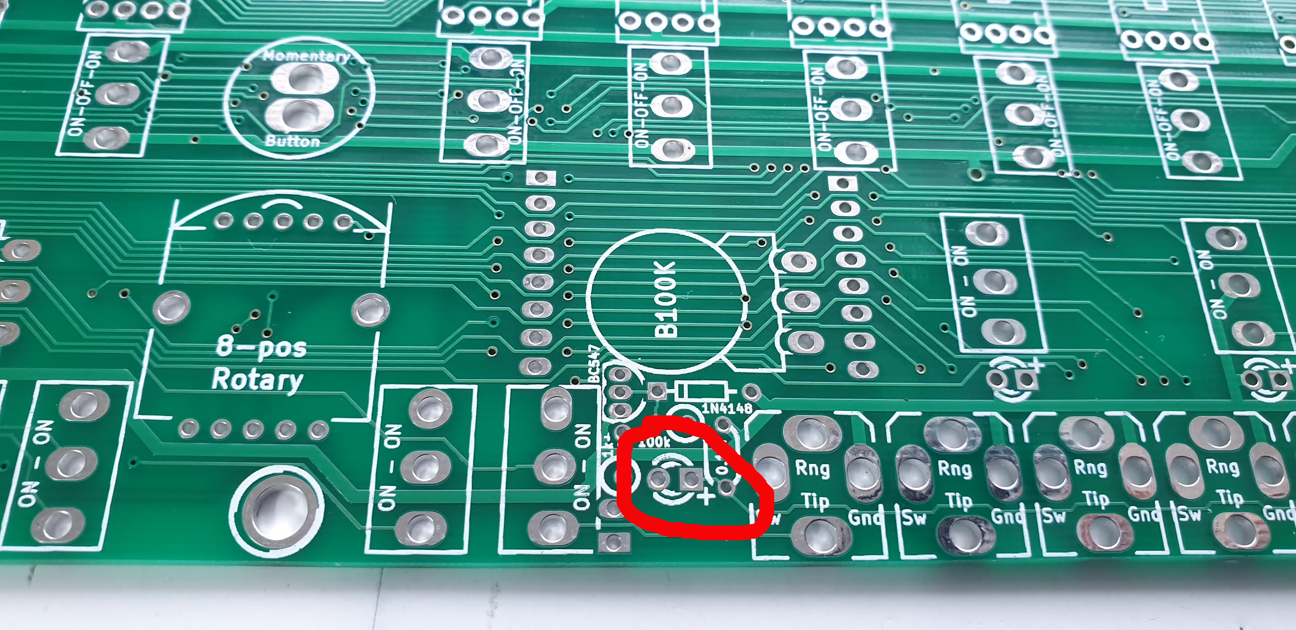

for what it's worth, i'm attaching another photo with the position of this particular led on the pcb.
thanks
 Filesize:  1.9 MB
 Viewed:  136 Time(s)
Posts: 24519
PostPosted: Tue Jan 28, 2025 3:23 pm    Post subject: Reply with quote  Mark this post and the followings unread
Ah, so it is not the electro-music klee but an undocumented unofficial modification by synthcube .. there is some bla bla in their build manual but it does not say what it is and how it works ... or even why it is there Evil or Very Mad
They bloody should provide schematics.. but i can not find it.
Anyway, 1k seems a bit low .. is all i can say . amounting to over 10mA worst case .. depending on how it actually is connected ..
Old fashioned leds could handle that, not sure about the modern high efficiency thingies .. the led's data sheet will have to tell .. but eh .. probably undocumented what it is eh .. so impossible to look it up then Laughing

Ah, ok 25mA max for the LED - when there really is 1kOhm in series (which i read somewhere) it should not break.
And the attached docs look pretty much like the original ones from here - so yes, I saw them - and no, I could not find a range LED on it.
