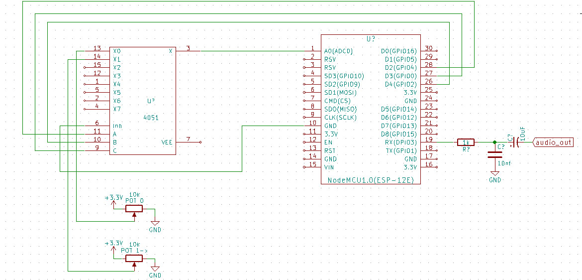

The basic wiring diagram
Remember to power the 4051 with the 3v3 and GND coming from the ESP board (not shown in this sketch schema) and add as many pots as you want following the same logic until 8

I am not really sure what you are doing but it sounds great. Razz
(pin 7 of the mux shoudn't be floating though)

PostPosted: Thu Feb 21, 2019 8:27 am    Post subject: Reply with quote  Mark this post and the followings unread
party! Thanks Phobos!!
It´s basically a bunch of wavetable oscillators and LFOs modulating each other in the middle of a karplus strong feedback path. This is just a patch in a infinity of possible ones. You just define the patch here, ala reaktor:
https://esptiny86.github.io/espnode86/
And that produces a patch code that you upload via usb to the synth. So basically is a mini reaktor in hardware. The hardware costs something like 5-6USD in components and then the possibilities are endless. The brains under all this development is Budi Prakosa, so all merit goes to him.
In my implementation Im using all the pins of the 4051, is just that I don´t know how to use the kicad yet. So people, take the shema as a reference only

Sorry to revive an ancient thread! Great sounds and thanks for sharing what's almost the only info about ESPsynth86 online, outside of the github :-S
I had been looking for a node-editor-based synth library for a board that's currently cheap and easy to find, so was excited to recently discover ESPsynth. Got it basically working thanks to the wiring info in your post but I'm having some issues. On the offchance that you will even see this all these years later I thought I'd just run it by this thread Smile
I'm programming the board using Arduino IDE, it compiles and uploads fine, multiplexer knobs operate correctly, but it's just that the audio is extremely distorted. The waveform exhibits extremely loud spikes rather than clipped peaks, so it looks/sounds more like some kind of buffer underrun or digital crossover distortion.
When I make a simple test patch with a volume control VCA I find that the distortion seems to suddenly appear as soon as any sound goes above 50% volume. At low volumes the waveforms look and sound normal.
I've tried NodeMCU and Wemos D1 Mini boards, hear the exact same distortion on either one.
I'm using the PDM output settings with a simple resistor and cap filter. Don't have a proper DAC to hand but I tried a little MAX98357 amplifier board kit, it was hard to tell thru a tinny small speaker but it seemed to be having the same or a similar issue, didn't sound right at all.
Have tried different sample rates and bitrate in the code but that doesn't help, as well as all the different board settings I can.
I'm using a CD4051 multiplexer for the input knobs but the problem is definitely unrelated to any issues with that, as it occurs with test patches without the multiplexer connected at all
MapacheRaper I tried your patch downloaded from the youtube comments and it too sounds completely distorted, not at all like it does in the video.
Any ideas would be much appreciated thanks. Smile But yeah, olde thread about a library that doesn't seem to have been used much at all so no worries if not Smile
Posts: 5850
PostPosted: Thu Jan 30, 2025 2:13 pm    Post subject: Reply with quote  Mark this post and the followings unread
Since it's a digital output and you say it's working otherwise could it be a hardware problem ?
Maybe a resistor to ground (say 10K) at the output after the 10uF cap might help.

PostPosted: Sun Feb 02, 2025 12:45 pm    Post subject: Reply with quote  Mark this post and the followings unread
Thanks for the reply, have tried that but alas it doesn't help. It definitely sounds like something wrong software-wise, it's a very digital sounding underrun/distortion kind of sound.
Wondering if I somehow did something wrong in the first place while installing the board and libraries etc.
I had to edit one or two things to get it compiling without errors in the first place, e.g. based on some forum info somewhere I added "compiler.libraries.ldflags=" under "compiler.elf2hex.extra_flags=" in the existing platform.txt file in Arduino15/packages/Espsynth86/hardware/esp8266/2.5.0/platform.txt (don't fully understand why but without that it wouldn't compile at all)
