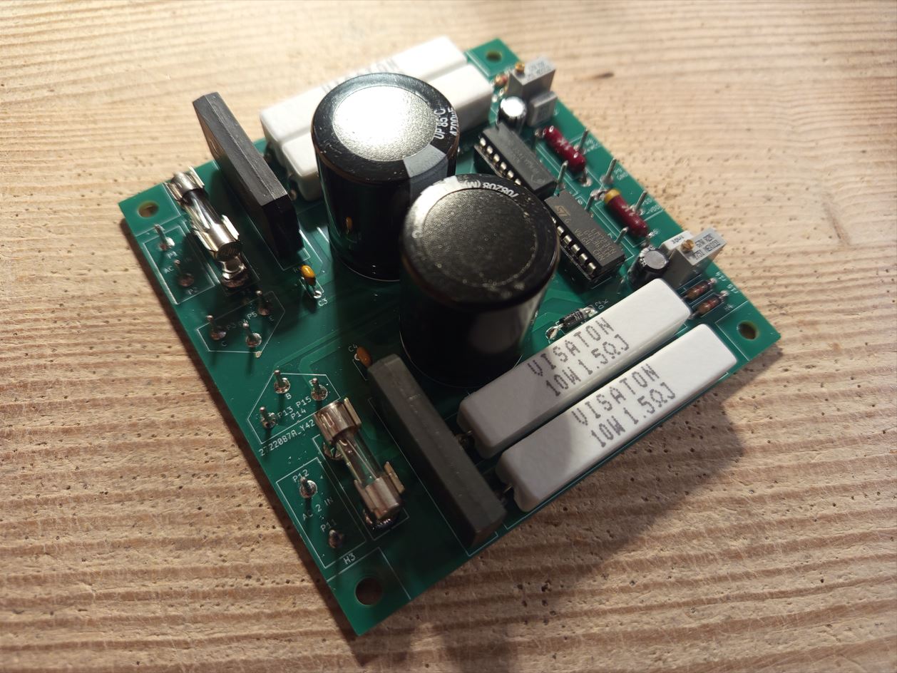

After 16 years on duty, the control board of the PSU of my Formant Modular Synthesizer passed away 😢

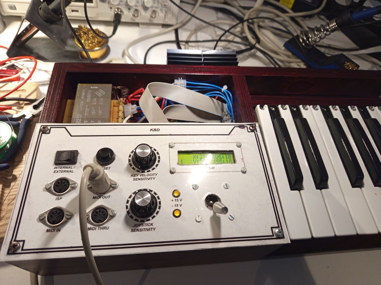

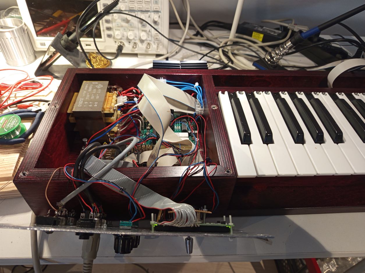

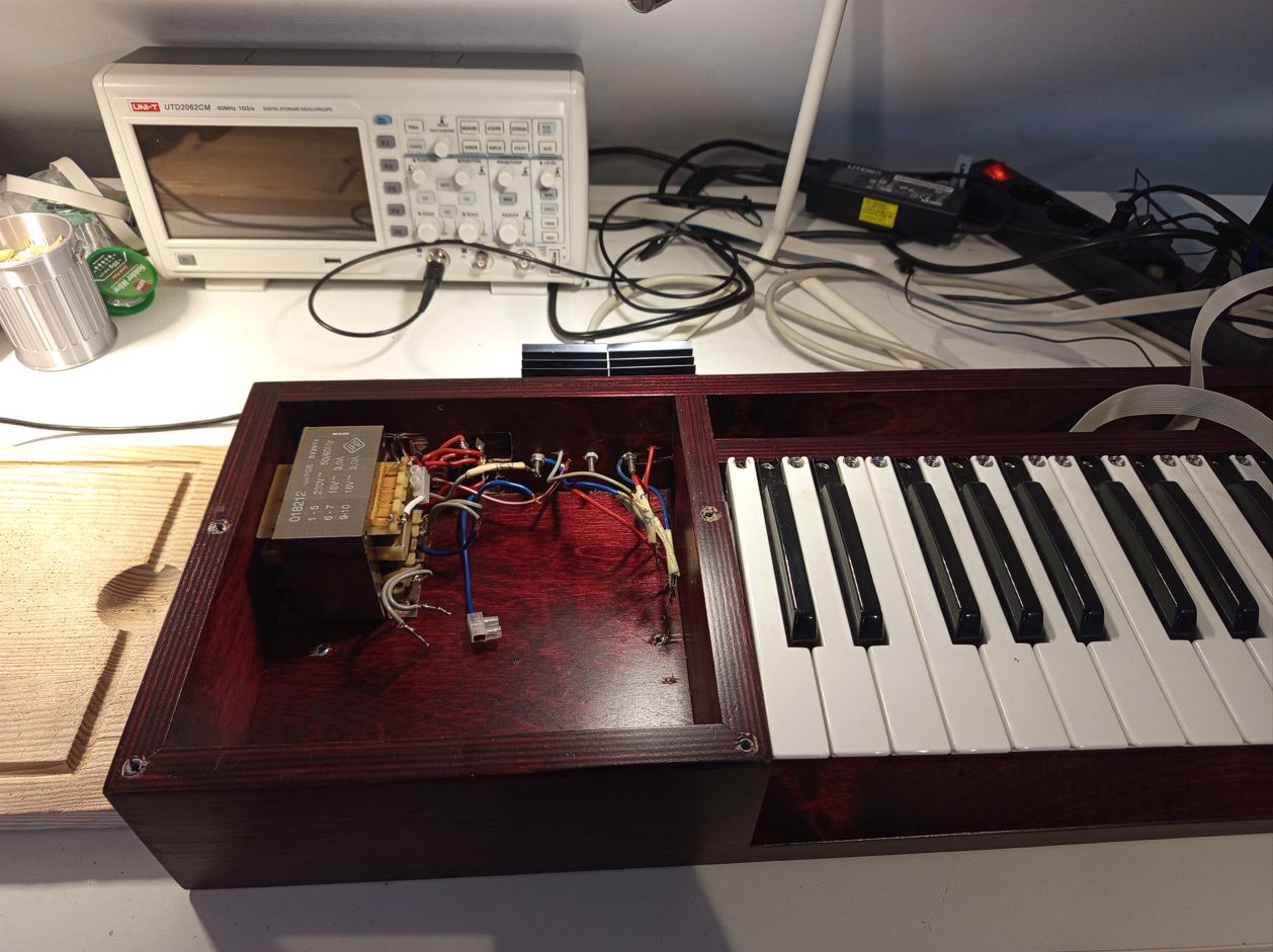

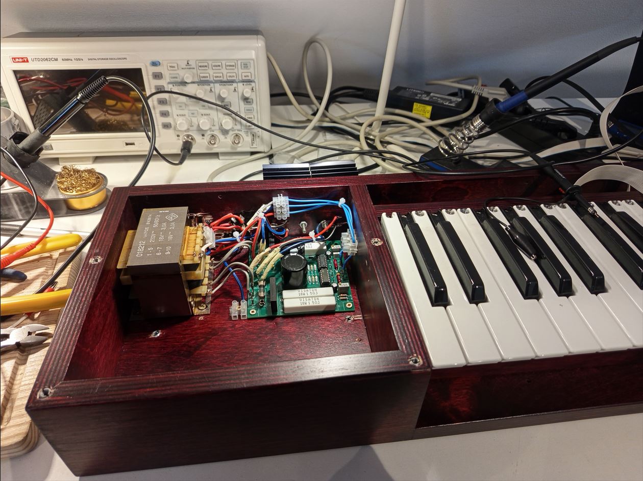

As the 723, its socket and the PCB underneath melted and baked together, nothing could be repaired, so I had to develop a new PCB for it. Same circuit, same board size, as everything shares the same free space within the keyboard enclosure together with the keyboard interface which I wanted to save in any case: It was a lot of work due to 8 voice polyphony, key velocity detection, joystick X-Y - control and MIDI monitor...
Available space:
PSU control board added:
Keyboard electronics addad:
Complete: Everything runs again 😊
