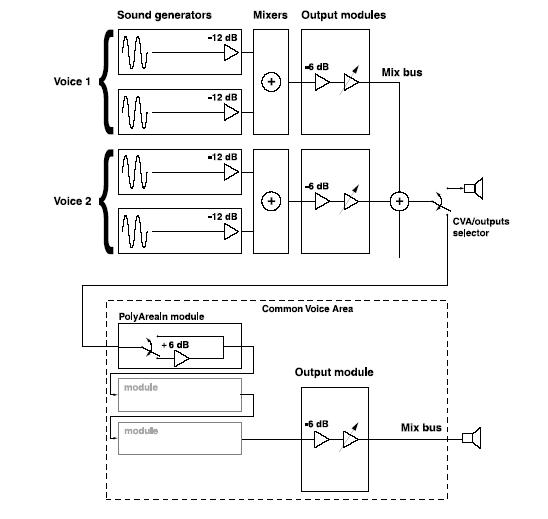

PostPosted: Mon Sep 19, 2005 12:59 pm    Post subject: Re: re: davep's suggestion Reply with quote  Mark this post and the followings unread
The Lurker wrote:
Straight saw wave of Nord Modular registers -18db on my soundcard's inputs.
I tried other comparisons as well, and the Nord seems on average 10db quieter.
I think that it is because of the open architecture of the Nord Modular you feel it is lower, but if you look page 215 of the manual you can see that :
" The headroom of the audio signals in Nord Modular is -12 dB for every sound generating module. Examples
of sound generating modules are oscillators and LFOs. The headroom in the mix buses of the output
modules are -6dB. If you mix more than four sound generating modules in a voice, at high or unattenuated
levels, distortion may occur. This can easily be dealt with by attenuating the level of each
In the figure below is shown the headroom for two oscillators (per voice) connected to a mixer and an
output module. As an option, all voices can be routed to the Common Voice Area instead of to a physical
output. To be able to output the signal from the Common Voice Area to a physical output, another output
module must be used as last module. The headroom in the mix buses of the output modules are -
6dB. To compensate the attenuation of the extra output module, there is a +6dB button on the PolyAreaIn
module. Activating the +6dB amplification can be useful if you use only a few voices. When using
more voices you may have to deactivate the amplification to avoid distortion. "
As you can notice there is an attenuation in the output module of -6dB, use the polyareaIN +6dB amplification to get some boost.
In fact you are right the synth is maybe low but you still can get some hell out of it.
HEADROOM
 Filesize:  35.46 KB
 Viewed:  8129 Time(s)

PostPosted: Mon Sep 19, 2005 1:29 pm    Post subject: Reply with quote  Mark this post and the followings unread
Ah, ok, yes, that's a system architecture issue that's easily fixed (and not realy a problem either). Indeed, you can't realy base anything on the relative volume of internal modules compared to line level at the output because those modules can be amped up and realy, there's nothing that says your sound even needs to be based on normal "sound generation modules". This is a completely different issue from my problem with the headphone output.
I think it's nice that it's so well documented how headroom interacts with voices and any problems that may occur there due to pieces that use monphonic, slow passages alternated with large chords are easily fixed with some well-planned use of a compressor module.
