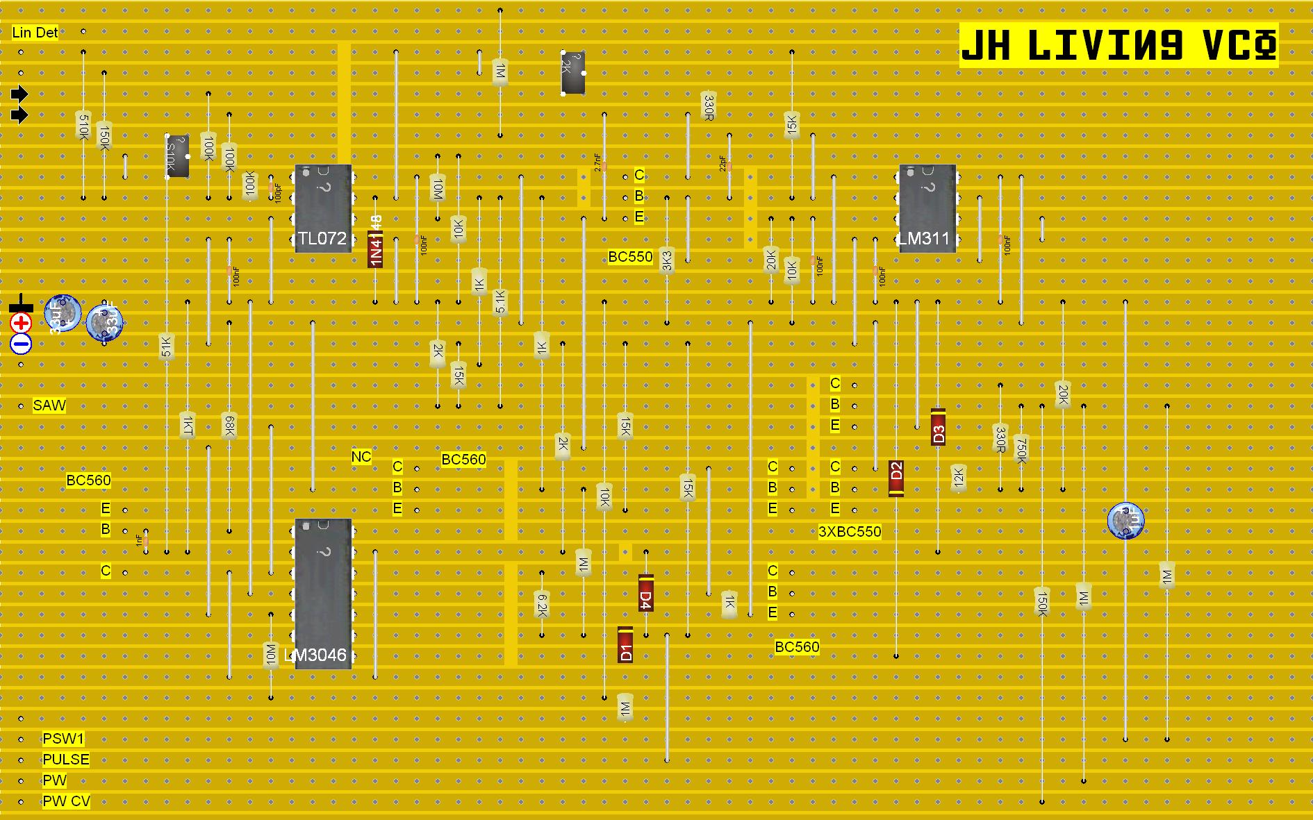

really challenge this circuit ! I hope i got it right ,here is the page for the circuit : http://www.jhaible.de/living_vcos/jh_living_vcos.html

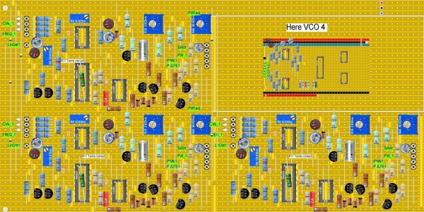

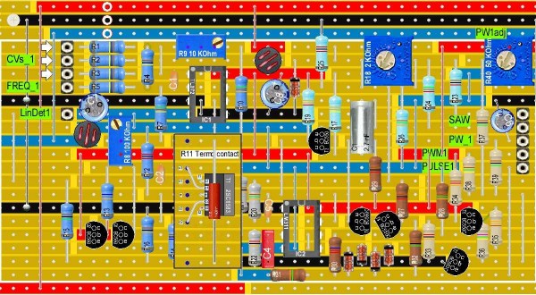

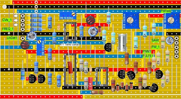

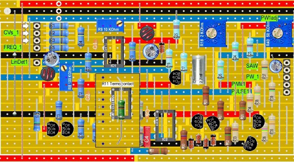

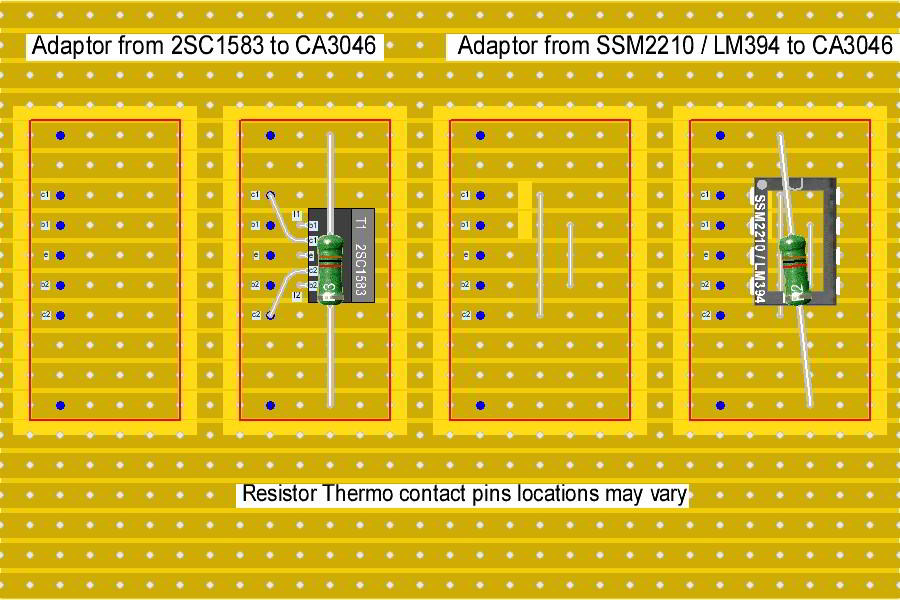

Another version of design.
- With a little adaptor, stripboard too, it's posible to change easy the CA3046 with 2SC1583, SSM2210 or LM394.
- Entire project fits on a H25SR200 (200x100mm - 8x4 inch)
I have not yet finished the VCO4

very neat Nardu !!
cheers

these look great, are any of them verified as working?
I see a lot of nice stripboard / vero board layouts on here but hardly any are verified!

hi feggster i haven't built the living vco's but from my layouts here in this section i have built and verified these :

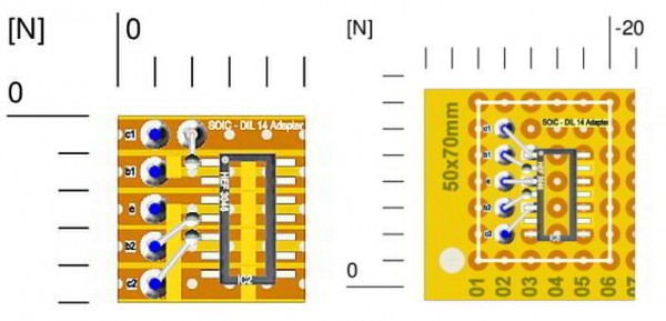

If you have a HFA3046 SOIC 14 package - http://www.intersil.com/content/dam/Intersil/documents/fn30/fn3076.pdf ,
use a little piece of striboard 0.5x0.5 inch - 12.7x12.7 mm to adapt the HFA3046 SOIC 14 to DIL14
