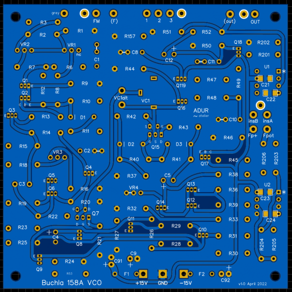

I made a redrawn of the Buchla 158A schematic, the original is hard to read.
It includes the extra transistor and resistor Mike Peake (ebolatone) indentified in actual 158 boards and some notes.
I don't have a web site, so I'm posting it here for the moment, so it's accesible to anyone.
I'm finishing a pcb for it too, with a couple additions, but that's a different affaire.
Greetings and hugs for all!

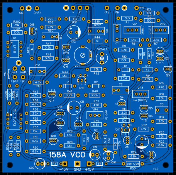

Fernando
Joined: Dec 30, 2006
Posts: 286
Location: Barcelona & Emporda, Spain
PostPosted: Mon Nov 14, 2022 4:23 pm    Post subject: Reply with quote  Mark this post and the followings unread

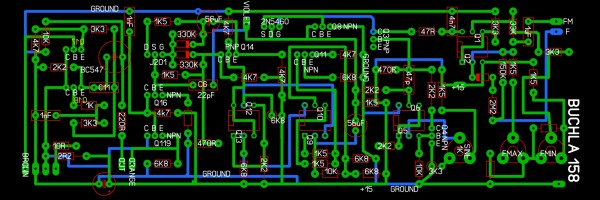

Not the last version I have, but it's illustrative (10x10cm pcb) :
PM if interested
 Filesize:  359.79 KB
 Viewed:  156 Time(s)
 Filesize:  299.26 KB
 Viewed:  151 Time(s)
Fer

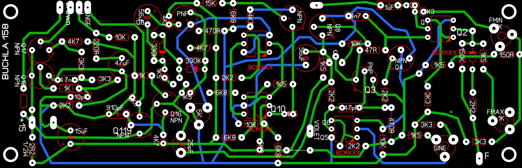

vladosh
Joined: Aug 02, 2010
Posts: 678
Location: macedonia
Audio files: 51
PostPosted: Tue Nov 15, 2022 2:21 am    Post subject: Reply with quote  Mark this post and the followings unread
Looks great ,i was gonna try single sided but then i couldn't resist ,here's mine .. still need to recheck it few more times before printing ,thanks again for sharing this redrawn version ,i assume all is correct in the schematic ,buchla stuff is so hard to find ,i was just looking at that 257 processor and someone has told me that the schematic is correct but it's still not all that clear ..synth is a never ending

Fernando
Posts: 286
PostPosted: Tue Nov 15, 2022 6:40 am    Post subject: Reply with quote  Mark this post and the followings unread
Excellent!
Just to clarify: my pcb lets you choose between the original power scheme of +15V direct to 3 transistors and the rest of the circuit thru R53 and C9 (as I understand you did) and a modern power scheme (power in to ferrite beads and 10uF)
Additionally, my pcb let you choose between original freq control INT/EXT and a modern CV mixer that lets you have both the freq pot and as many inputs you want, all with bipolar attenuators.
Also my pcb have an output amp to adapt the original 1V RMS (2.83Vpp) to 5Vpp, 10Vpp or what you like.
I did all film caps with multi-size footprints and FETs (Q7, Q15) with a footprint that let you use many different devices.
I did a 100x100mm pcb so it can be used in small systems (Eurorack) or larger systems (Serge, Buchla, MOTM, etc). Thru plated holes, etc., very good quality
Fer
vladosh
Posts: 678
Location: macedonia
Audio files: 51
PostPosted: Tue Nov 15, 2022 7:12 am    Post subject: Reply with quote  Mark this post and the followings unread
i was just excited to see a well documented buchla module ,to be honest i am not so certain that i will build it ,tho i want to ,i hope i will ,about those add ons and mods ..you are right it's prolly better way to fit into modular ,i should maybe make some high gain amps to boost the signal if it's quiet ..in the end i will be so happy if it works ,maybe to add that 156 processor ,anyway ,i believe there might be some negative voltage here and there in my modular ,i wonder how this VCO behaves on negative voltage ,it's descrete i guess it won't do any harm ..even so ..it is still worth building ,thanks

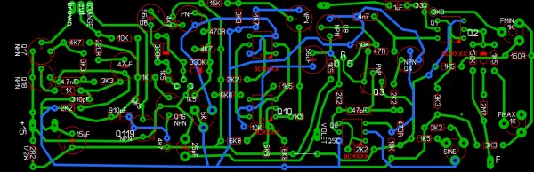

vladosh
Posts: 678
Location: macedonia
Audio files: 51
PostPosted: Fri Nov 18, 2022 1:39 am    Post subject: Reply with quote  Mark this post and the followings unread
i fixed it up a bit and shared on my blog ,i hope it's ok ,also did a layout for Buchla 106 https://synthacks.blogspot.com/2022/11/buchla-158.html , i wonder if i ever get to building this stuff .. more then 10yrs of building synths so often it is hard to sit down and do some soldering ,i wish i could get some window size Modcan and clean up my room

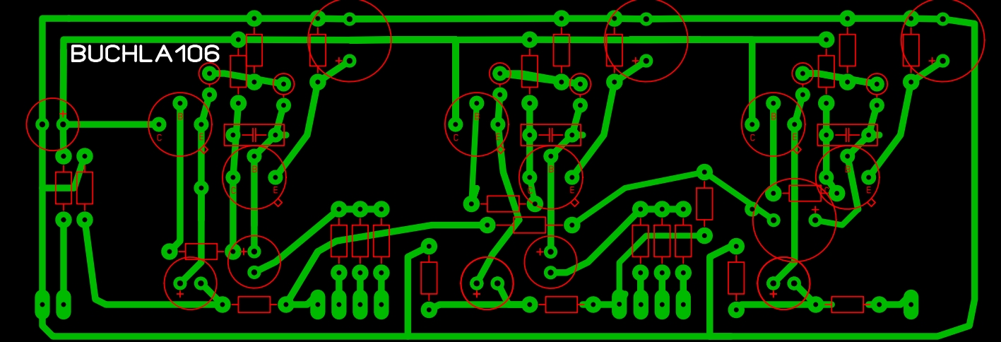

vladosh
Posts: 678
Location: macedonia
Audio files: 51
PostPosted: Fri Nov 18, 2022 3:49 am    Post subject: Reply with quote  Mark this post and the followings unread
i so want to make some other buchla layout but not knowing what schematic is correct ..is hard .
vladosh
Posts: 678
Location: macedonia
Audio files: 51
PostPosted: Tue Nov 22, 2022 9:15 am    Post subject: Reply with quote  Mark this post and the followings unread
made a new version layout for this oscillator as the first one was bit all over the place

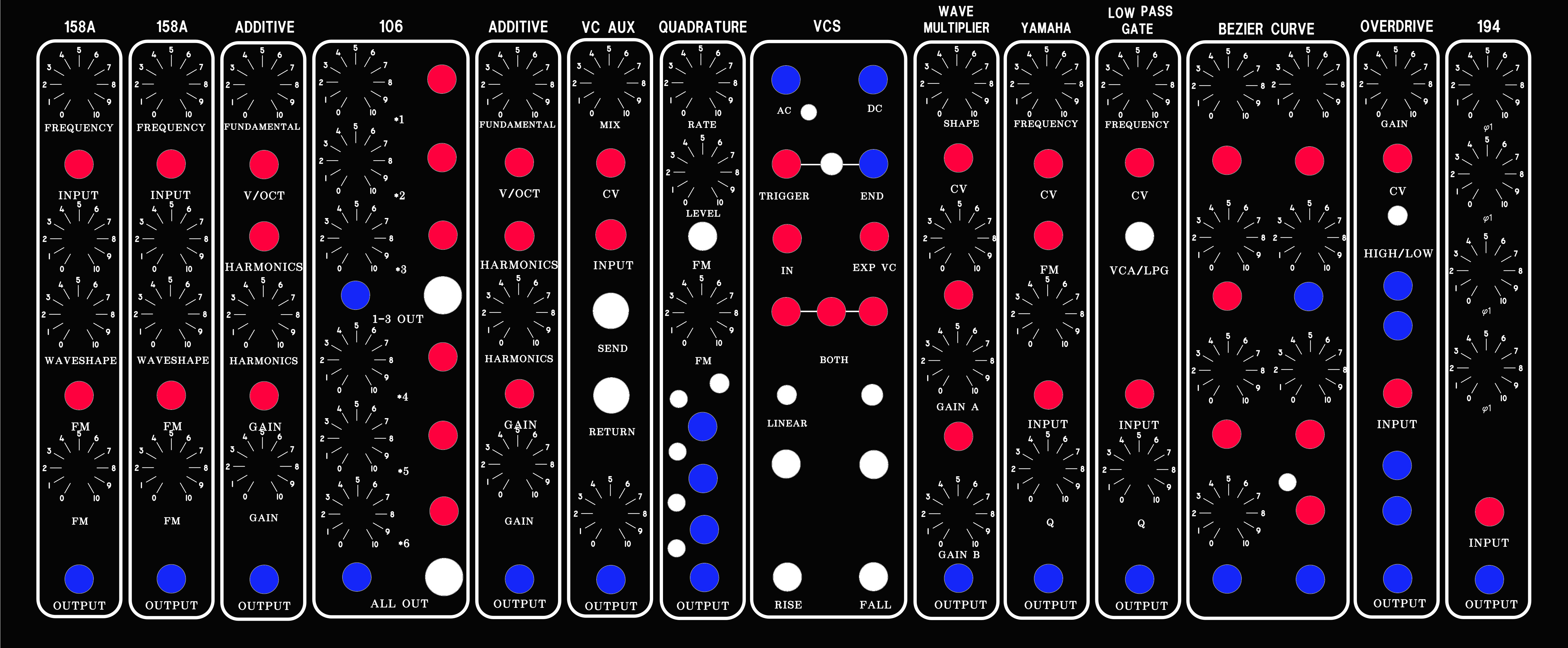

vladosh
Posts: 678
Location: macedonia
Audio files: 51
PostPosted: Wed Dec 07, 2022 6:59 am    Post subject: Reply with quote  Mark this post and the followings unread
