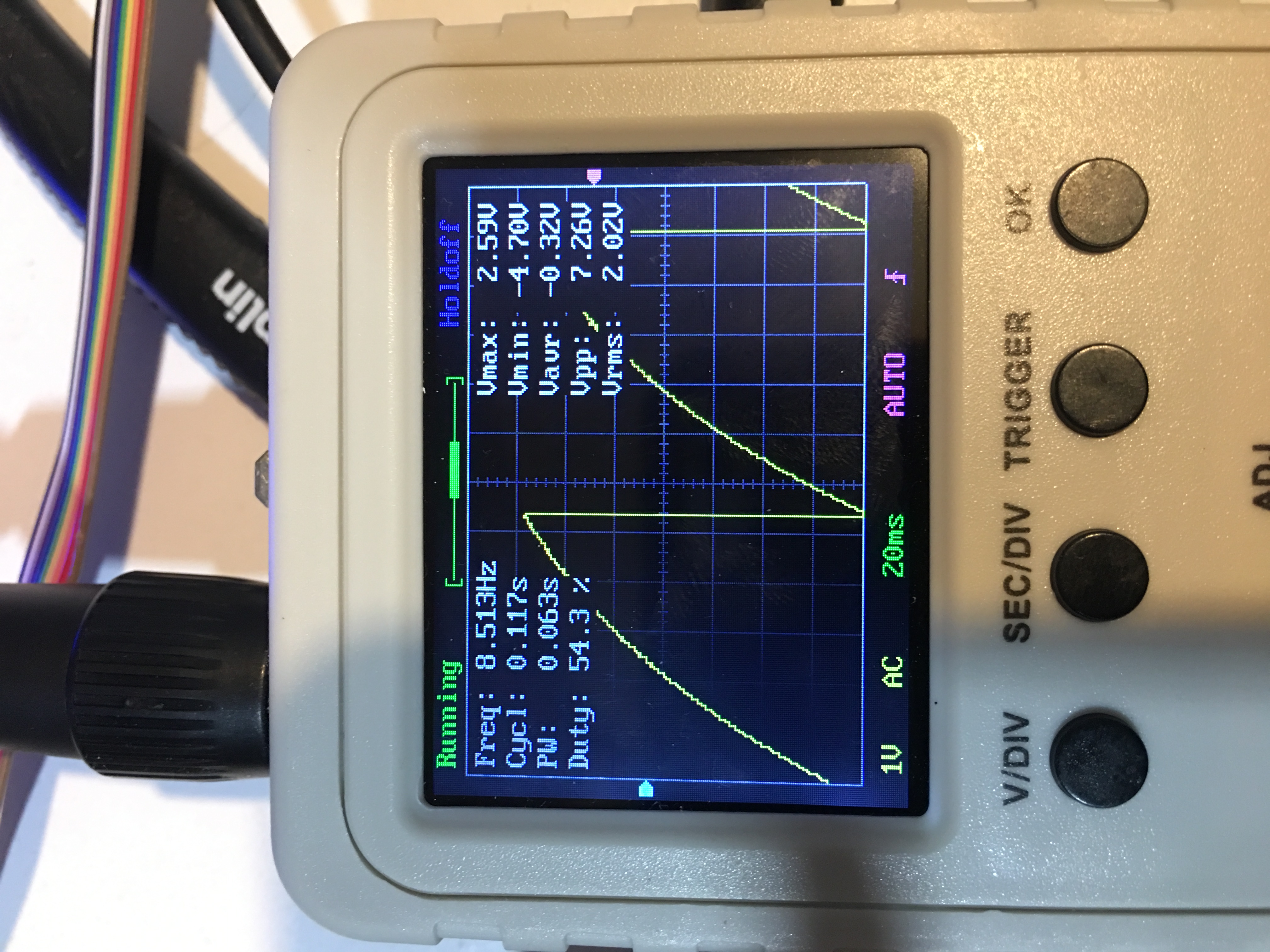

PostPosted: Mon Nov 18, 2019 1:44 pm    Post subject: Reply with quote  Mark this post and the followings unread
Here is a (cheap) scope image from pin 14 of ic 2, same reading as pin 7.
I’m only getting 20% of the duty cycle of the pulse too.
 Filesize:  2.13 MB
 Viewed:  347 Time(s)
 Filesize:  2.13 MB
 Viewed:  313 Time(s)

PostPosted: Mon Nov 18, 2019 2:54 pm    Post subject: Reply with quote  Mark this post and the followings unread
Oh and I should add that I have been through the other posts on the forum and did spot your R17 suggestion, which fixed my initial problem of an irregular saw. So thanks for that one mate. I may have a fiddle with the PWM resistor value tomorrow to see if that can give me more range from the pulse width
gabbagabi
Joined: Nov 29, 2008
Posts: 652
Location: Berlin by n8
PostPosted: Tue Nov 19, 2019 8:33 am    Post subject: Reply with quote  Mark this post and the followings unread
np,
are u shure the saw is now 10Vpp?
i cant say it from the scope.
you also do scoping on AC?
for more PW range you could try do decrease R37 and R38 to 10k
gl

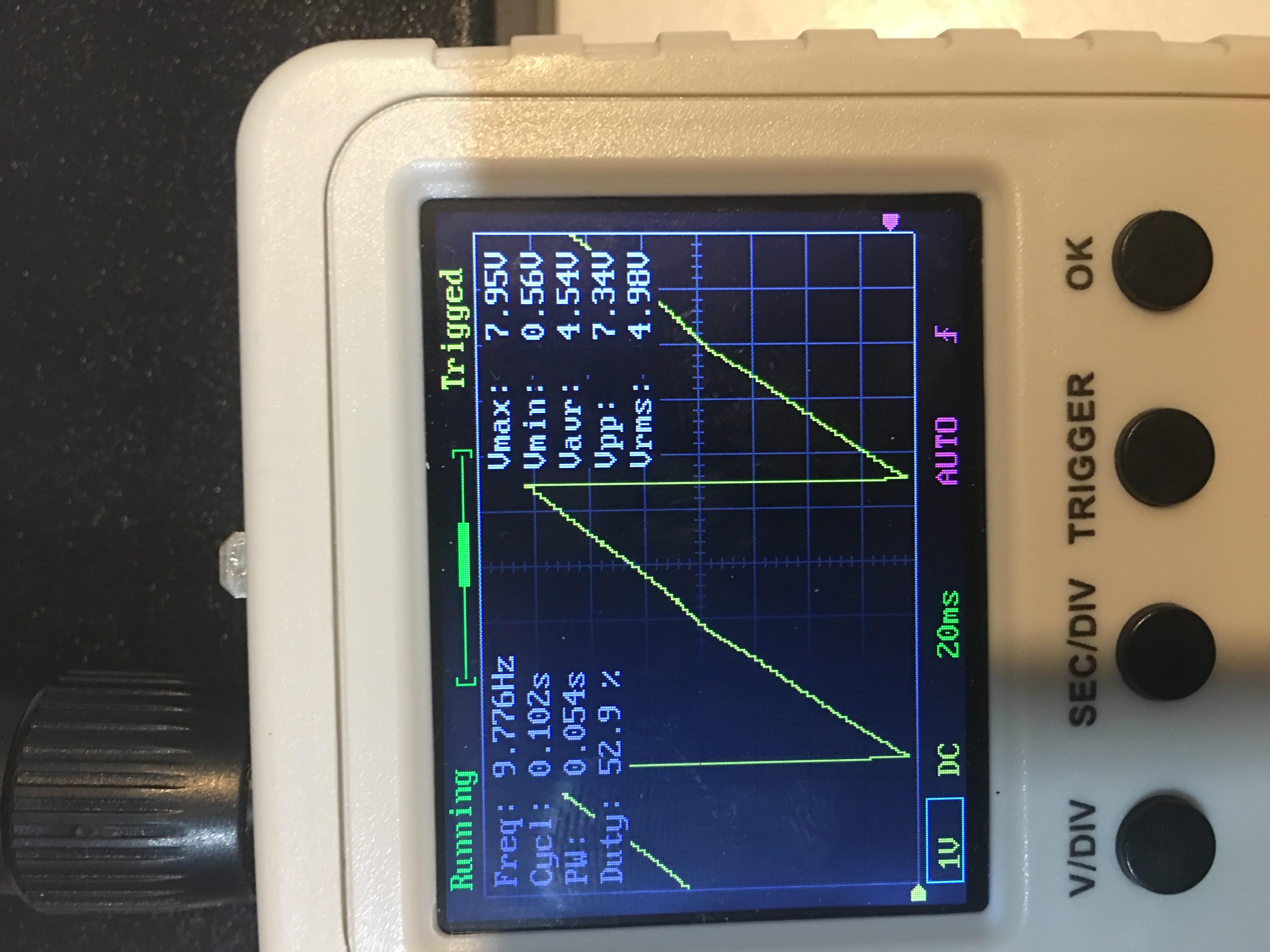

PostPosted: Tue Nov 19, 2019 11:53 am    Post subject: Reply with quote  Mark this post and the followings unread
Here is the scope set to DC. As I mentioned I’m very new to this so still not 100% sure how the read these things properly. Thanks for your help though mate
 Filesize:  1.99 MB
 Viewed:  321 Time(s)

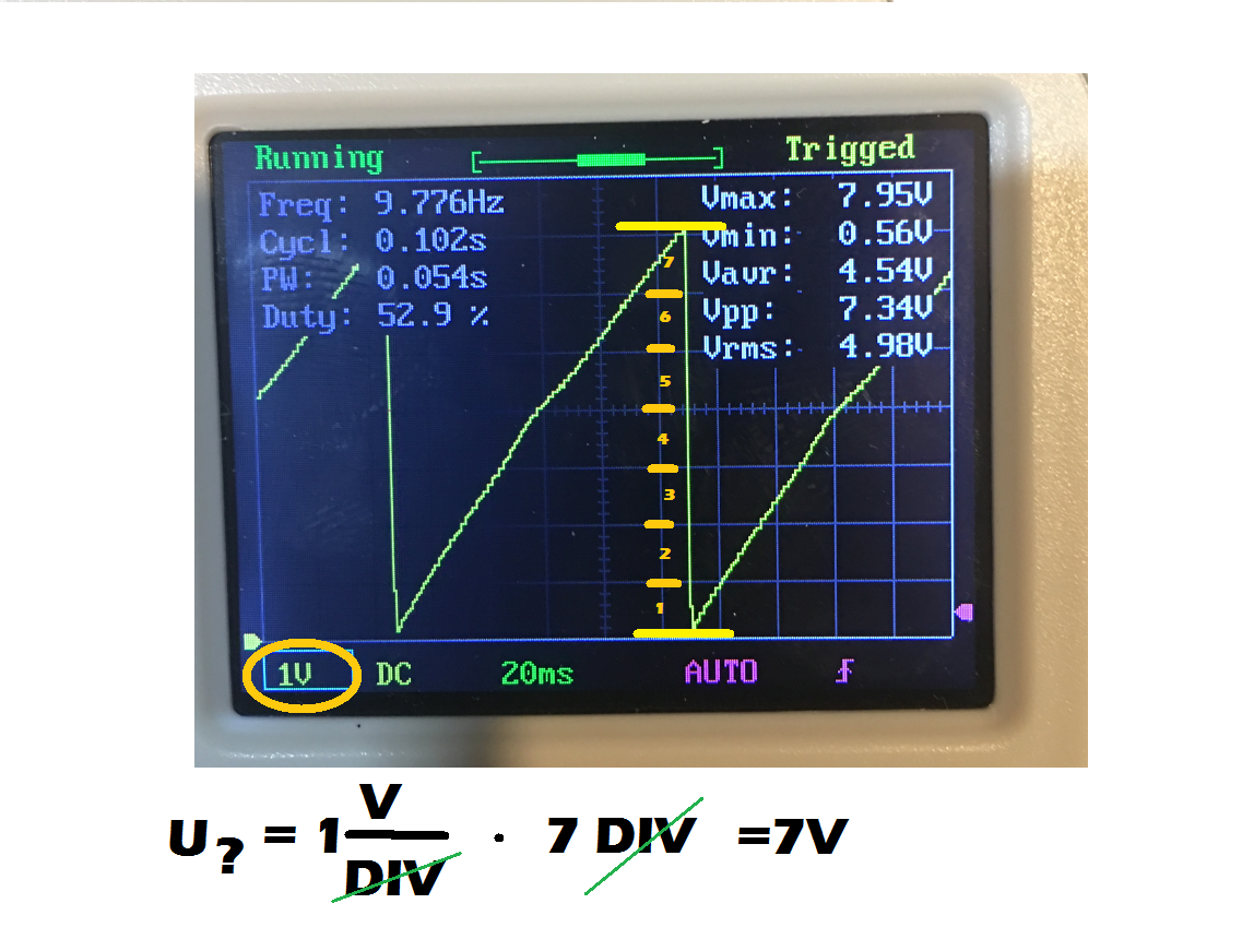

PostPosted: Wed Nov 20, 2019 4:14 am    Post subject: Reply with quote  Mark this post and the followings unread
ur welcome, we all have started some-time-some-where
i can imagine there are tons of yt-videos about scopes,
but the most basic thing is measuring the amplitude of a signal:
count the divisions between the highest and the lowest point of your signal:
yours has roughly 7 Divisions, then you multiply the divisions with volt-per-division-value, which is in your case 1V/DIV
so your signal has an amplitude of about 7Vpp (peak to peak)
or on your scope u could calculate Vmax - Vmin=7,39V
but the waveshapers are expecting 10Vpp!
hm, that smells somehow like a 12V powersupply?
 Filesize:  829.87 KB
 Viewed:  281 Time(s)
gabbagabi
Posts: 652
PostPosted: Wed Nov 20, 2019 5:05 am    Post subject: Reply with quote  Mark this post and the followings unread
just saw that u mentioned a 12V power in the other tread.
so in theory the amplitude should be 12V*66%=7,92V
in reality you have measured 7,39V
u can correct that by changing the resistor combination R14/R17,
by default they should 100k/100k
theory: the factor between 10V and 7,92V is 1,262
so we could use:
100k / 126k
79k / 100k
68k / 85k
50k / 63k
39k / 50k
reality: the factor between 10V and 7,39V is 1,35
then it would be:
100k / 135k
74k / 100k
68k /92K
50k / 68k
or just use a trimer, do you have one laying around?
