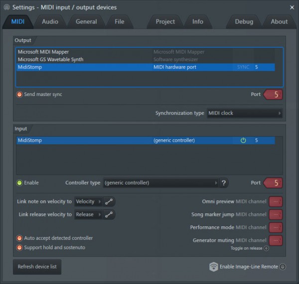

When you upload sketch into Digispark, your PC will find new device. In FL Studio set a port for MidiStomp, I use port #5. Open attached example for FL Studio.
Channel #1 - sine
Channel #2 - triangle
Channel #3 - saw
Channel #4 - square
Channel #5... - effects
Decay is not working now. Dig the code, you will find envelope tables for lead and for filter.
Combining white noise and other waveshapes, it's possible to make new instruments! Let me know, if you will make something new!

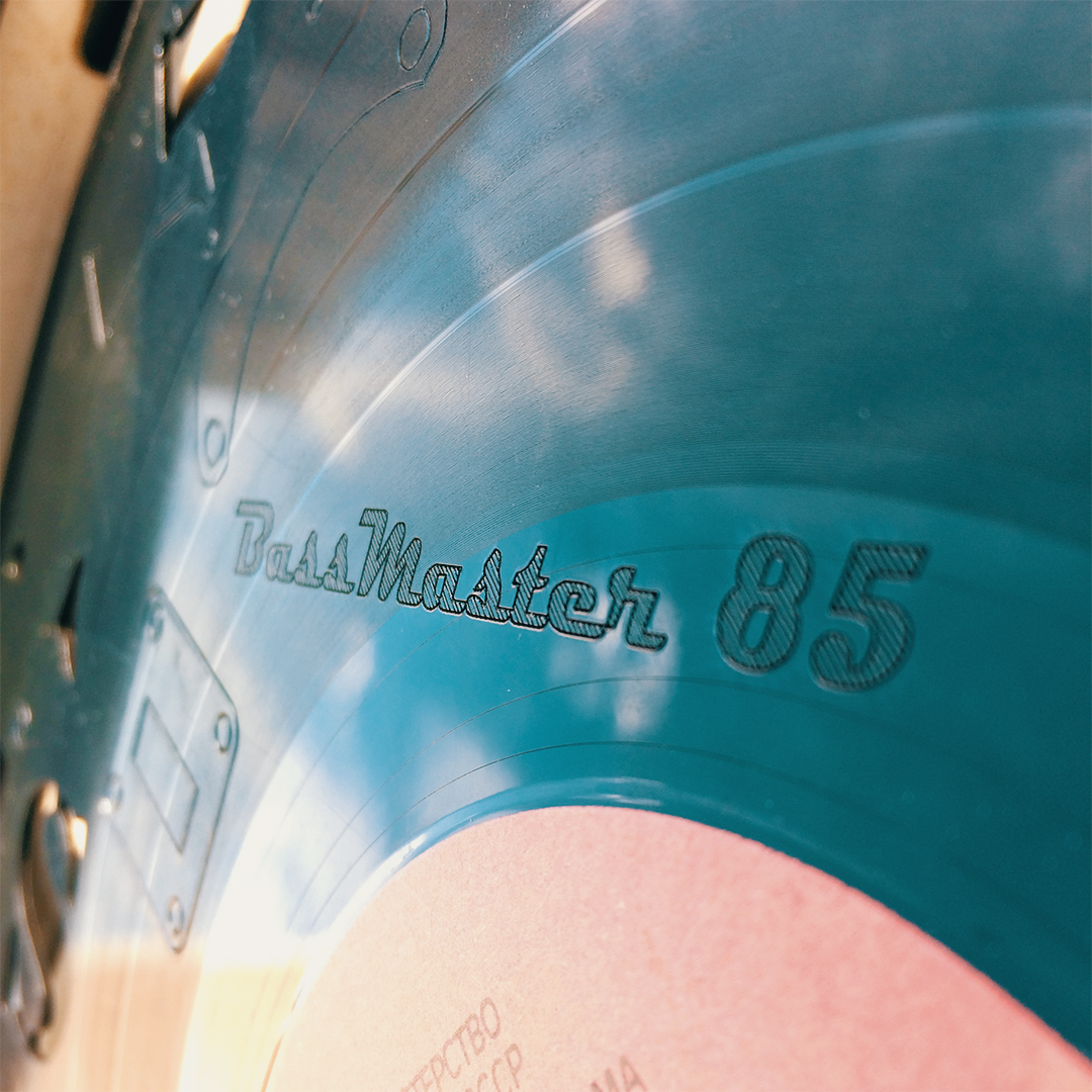

I think that laser cutted vinyl is good for case and deck building!
 Filesize:  764.95 KB
 Viewed:  497 Time(s)

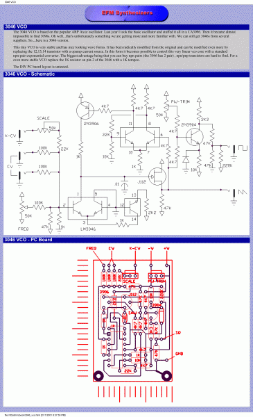

Nice piece of work. As you have dual power supply range of possible circuits is much wider than with +5V only.
Attaching simple VCO and VCF diagrams, may will be some help. Also simple +5V VCF from gasboss, don't know if any use of it.
I haven't made any of them, just collecting schematics Smile

One more simple VCF I've found - with CMOS ICs.
 Filesize:  4.72 KB
