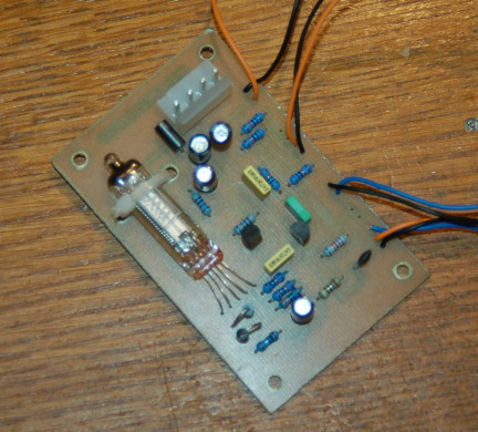

Jeroen Baars designed a nasty Tube VCF which he posted on the Dutch synth forum, here: http://www.synthforum.nl/forums/showthread.php?t=90425
The final design and sound samples are on his website: http://www.electricdog.eu/
I did a PCB design for it that might be interesting to some of you out here:
http://www.casia.org/modular/SF/tubevcf.pdf
http://www.casia.org/modular/SF/tubevcf.jpg
It's quarter eurocard, which seemed like an economical format.

I've updated my PCB design (links in the first post). Connected an unconnected ground plane, fixed a cap value and changed some hole sizes and the FET footprint.
Sound sample:
http://www.casia.org/modular/SF/tubevcf.mp3
Pic:

As the VCA is close in design to the VCF, I modified the PCB to make a VCA one This will take both versions (just replace the transistor by a jumper and leave off the 4k7). Check the schematics to see which component values belong to the version you want.
http://www.casia.org/modular/SF/tubevca.jpg
http://www.casia.org/modular/SF/tubevca.pdf

I also have some 1J24B and 1AG5 tubes , so it would be good to know how to adapt the circuit for them.
niiice sound!
EDIT: it seems that the direct equivalent is the DL69.
Anyhow the 5672 is quite easy to find for $3-$6, plus shipping, of course (some people ask up to $20 only for the tube, sick!) Other theoretical equivalents can be found for $1-$4...
EDIT II: I know it's obvious, but I just realized this filter's crazy resonance can be VC using an external (tube?) VCA

While looking for possible equivalents of the 5672 I looked at the table Andrew pointed.
I looked for heater voltage of 1.25V and 50 mA or less, down to 10mA.
I also looked for same pinout (2E31 pinout).
Then I realized that most of the tubes matching with these specs had a much smaller amplification factor than the 5672.
---> So my question is, for VCFs and VCAs, wich amplifying factor range should be apropiate?
The 5672 has 0.065 W as a reference, but many of them are in the 0.001-0.040 W range...
---> Also, what's the influence of the load (5672 = 20k, others up to 1200k)
