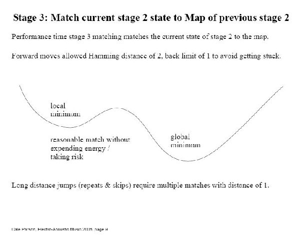

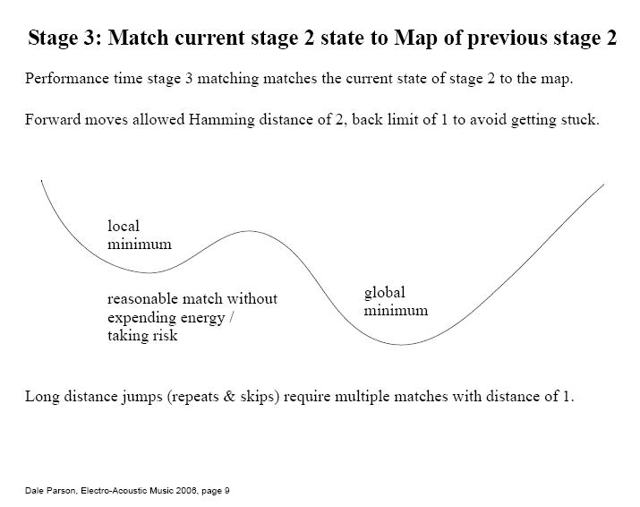

I have run into an interesting problem that requires attention, although I haven't worked on this system in a few months because my small musical time has been going into novel signal processing on audio streams lately. The problem is outlined by the attached graph below from my talk at electro-music 2006. The minima in that graph are places where score matching was getting stuck. Basically, score matching takes the current chord-mode-drone triplet from my incoming MIDI stream, and tries to match it to a saved trace of a previous reference performance (which is actually a merger of chord-mode-drone triplets from a number of previous performances, in an attempt to average out the errors). When it matches a location in the 'score trace,' this gives down stream accompaniment modules a 'plan for the future' in predicting where to go.
What the graph showed from 2006 is that I found it necessary to give score matching more leeway in moving forward than in going backward. The original algorithm allowed forward or backward motion only if the triplet in the score trace matched my extracted playing to within one note. (The extracted playing is not exactly what I played -- chord-mode-drone have already been fitted into a framework, and they are octave invariant, so a max error of 1 note is to as tight as it sounds.) The trouble was, the score matcher tended to be too conservative, getting stuck in matches because moving forward would have required accepting mismatches bigger than one note. Any accompaniment based on score matching would get stuck and keep playing the same phrase over and over, because it was 'afraid' to move.
My solution in 2006 was to give it more leeway for moving forward in the score. It could allow two notes of error in moving forward, but only one backward. Statistically, the score matcher started reaching the score about the time I reached the end of the piece, so this seemed like an acceptable kludge.
In working with this again during summer, 2007, I found that a bass accompanist I wrote for a rather longer piece than previously tried (about 15 minutes) would sound really interesting at the start of the piece -- the first time my wife walked into the house during a duet with the machine, she asked whether my son was on the bass -- but it would seemingly *run out of ideas* near the end of the piece, and start noodling around in a dull phrase again. I haven't actually debugged the problem yet, but it appears that score matching is now being nudged to the end of the piece ahead of me, and which point it gets stuck in a local minimum at the end of the score.
My planned solution will be to make long distance jumps back into the score more feasible when stuck at the end. I am not too worried about getting to the "correct place," because this stuff is improvised and length tends to vary from performance to performance anyway. As long as its jumps to a reasonably consonant spot in the score, it will sound fine.
Score matching is also the most computationally expensive part of the running process, so I have additional work to do in there.
