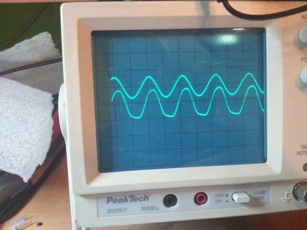

PostPosted: Tue Sep 03, 2013 12:57 pm    Post subject: issue Reply with quote  Mark this post and the followings unread
Hello,
i hope to find some help here.
i´m building the fs1a.
today i tried to calibrate the device but i got in calibration process 1 and 2
2 waveforms with same amplitude but they DONT are 90degrees different in phase.
any idea ?
i tested:
U8, pin 7: triangle. yes was a triangle
U9, pin 7: triangle - yes yes is a triangle
U9, pin 1: square wave - yes
 Filesize:  2.33 MB
 Viewed:  1309 Time(s)
LED-man
Joined: Feb 22, 2013
Posts: 40
PostPosted: Wed Sep 04, 2013 2:23 pm    Post subject: Re: issue Reply with quote  Mark this post and the followings unread
LED-man wrote:
Hello,
any idea ?
i tested:
Failure gone.
I never tried before both channels together in my Oscilloscope,
Trigger Setting wrong.
Further i Must change R51 to 330ohm.
51k like described here is to much.
