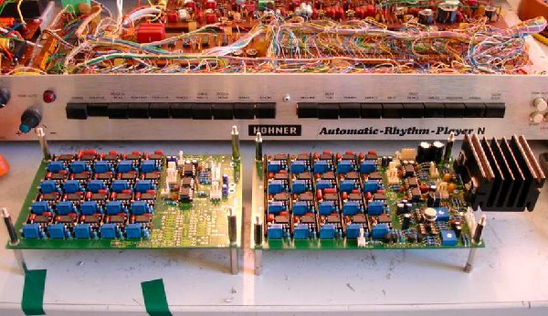

Well, I finished my JH String Filter yesterday. What seemed like the most tedious part was inserting all of those TL072's.
I was so anxious to get it up and running that I stopped work on th Frequency Shifter when I got these boards (it only needed mounting on a panel).
It actually sounded pretty good even before making any adjustments! Playing an electric guitar through it, I did notice a wolf note around D just above middle C, so it needs adjusting after all.
However, the wiring on the schematic for the stereo spread didn't look right to me. It shows the "r to l" on PCB1 and the "l to r" on PCB2 connectors having their pins 2 & 3 tied together. I swapped the connections to pins 2 & 3 on "r to l" (PCB1) and it seems to do what I think it's supposed to.
This is going to be the heaviest single-width Moog format module I have, weight wise Shocked
These connectors are used for cross-feeding the two halves of the filterbank.
A look at the schematics may shed some light on how it works: the summing resistor that doe sthe cross-feeding is split into two parts, haolf of it sitting on the sending end , and half of it sitting on the receiving end. Then, a shunt (potentiometer + capacitor to GND) at the connection point decreases the amount of cross feeding.
"l_to_r" or "r_to_l" are short descriptions of the function of those connectors. As both partial filters use the same PCB, I had to decide on one labelling, which may be a bit confusing.
But in the end it's as easy as this: You connect pin 3 of PCB 1 to pin 2 of PCB 2 ("path 1->2"), and pin 3 of PCB 2 to pin 2 of PCB 1 ("path 2->1), and each of these connections gest its own variable shunt to GND.
JH.

PostPosted: Fri Aug 01, 2008 3:06 pm    Post subject: Reply with quote  Mark this post and the followings unread
i´m happy... Very Happy Very Happy Very Happy
 Filesize:  76.1 KB
 Viewed:  717 Time(s)
