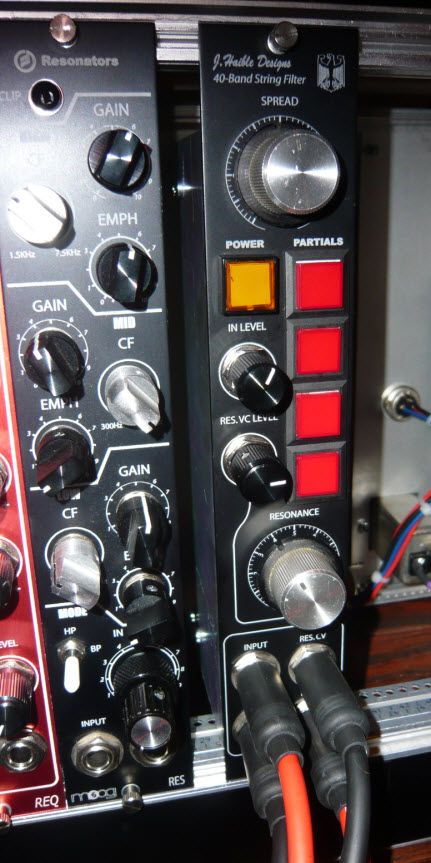

PostPosted: Sat Jan 08, 2011 2:00 pm    Post subject: Reply with quote  Mark this post and the followings unread
Took me 5 hours to prepare and repanel my SF on its new panel.
Switches are not lighting up atm but they will.
