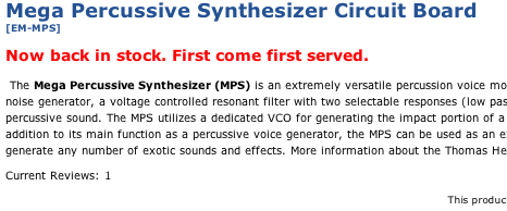

PostPosted: Thu Aug 16, 2012 10:16 pm    Post subject: Reply with quote  Mark this post and the followings unread
This is a current snapshot as of RIGHT NOW.
It says "NOW back in stock".
Are you perhaps misunderstanding and thinking that it says "NOT back in stock" ??

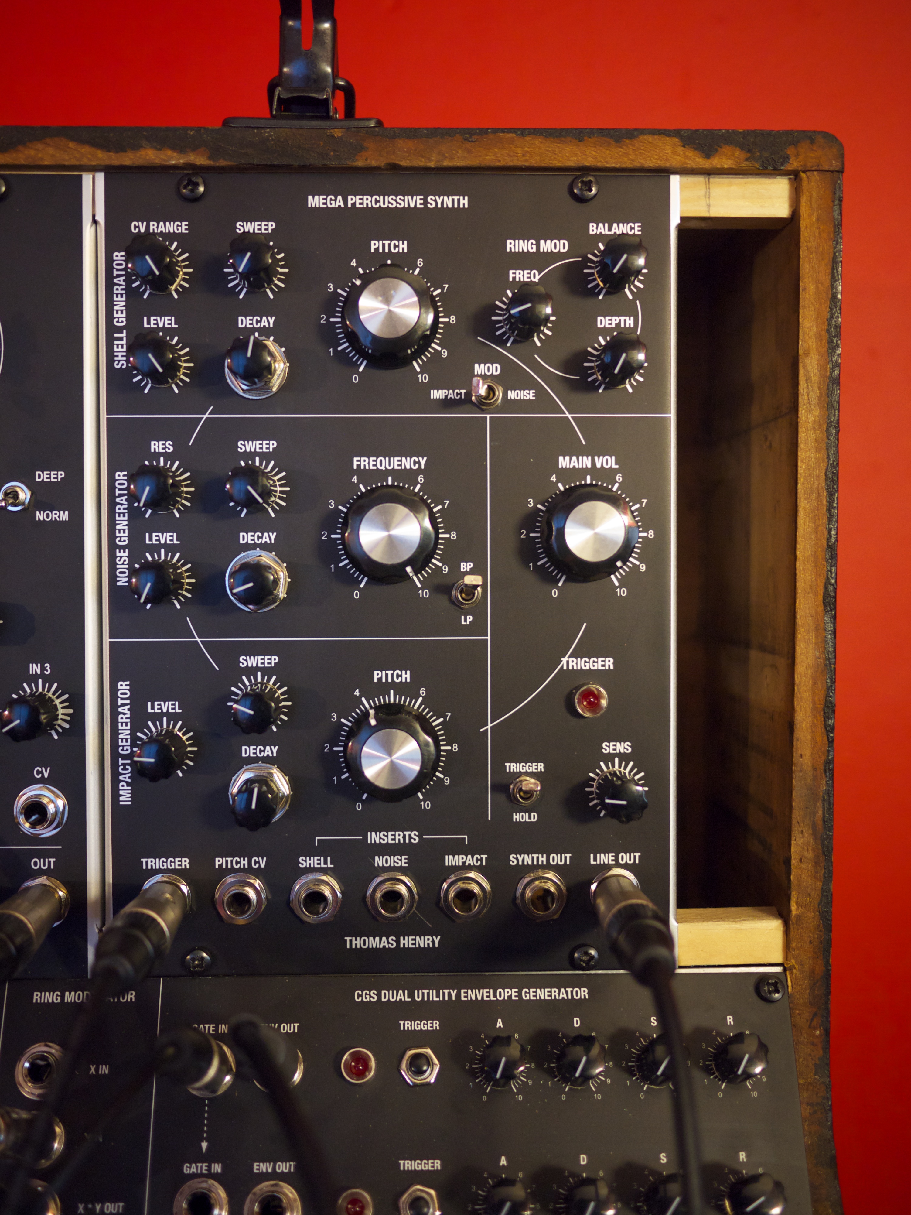

Some lovely looking designs everyone. Here's a pic of my MPS that I put into Moog format. Designed in Adobe Illustrator, and made by Ben at Re:Synthesis .http://www.bigbluewave.co.uk/resynthesis/resynthesis_home.htm
 Filesize:  2.78 MB
 Viewed:  1309 Time(s)
