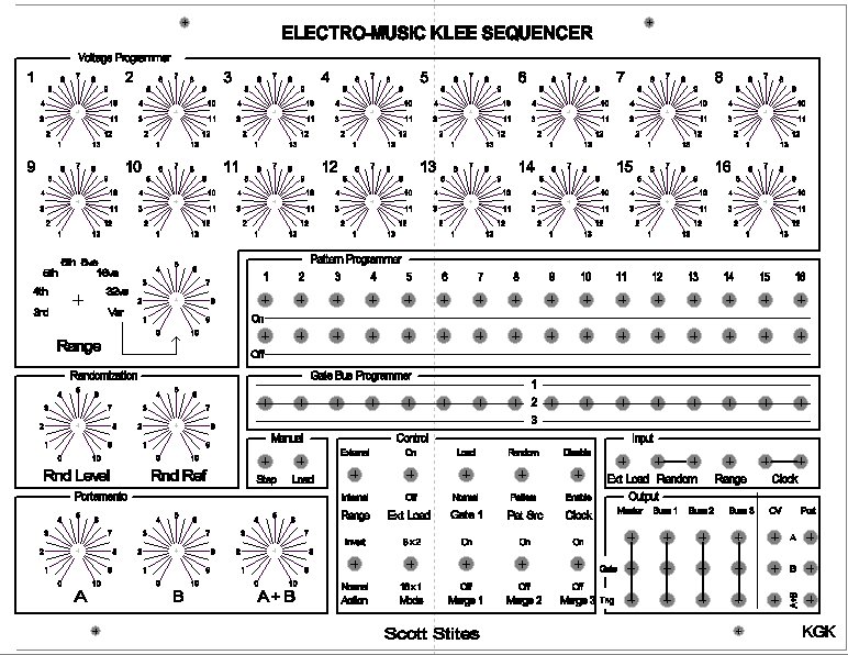

I finally designed my panel. I looked through many panels and this one caught my eye:
http://electro-music.com/forum/topic-21954.html&postorder=asc&highlight=klee+sequencer&start=298
This panel creates a separate section for the voltage programmers, the pattern programmer, and the gate bus switches.
I extended the concept and managed a design that fits nicely into a quadruple sized Aries panel (12" wide, 9" high).
When I get home this evening, I will post a pic.
I'm currently in the throes of wiring it up. I have all the strap wiring in place and am building the cables now. I hope to have it up and running within the week.
I'm really excited at the prospect of having a Klee Sequencer --
since I finished a pair of MFOS Voltage Quantizers, I've had a great time with my existing Aries Sequencer which is a very basic 8x2 design with no bells or whistles.
By far the most time-consuming part of the Klee Sequencer build has been to design a front panel. Thus, the thought of building a second one isn't so daunting to me now that I have a design.
It took an evening to drill my panel, though -- 107 parts -- **whew!**
And -- after I had it all drilled and labeled, I discovered that I left the clock LED off of the panel (I also mislabeled the 8x2/16x1 selector). Well, I managed to drill another hole for the clock LED -- ugh, what a stupid thing to forget! Probably the result of working too late with the onset of fatigue.
The mislabel was a cut and paste that I must have forgotten to change. It is a cosmetic issue that I'll fix later.

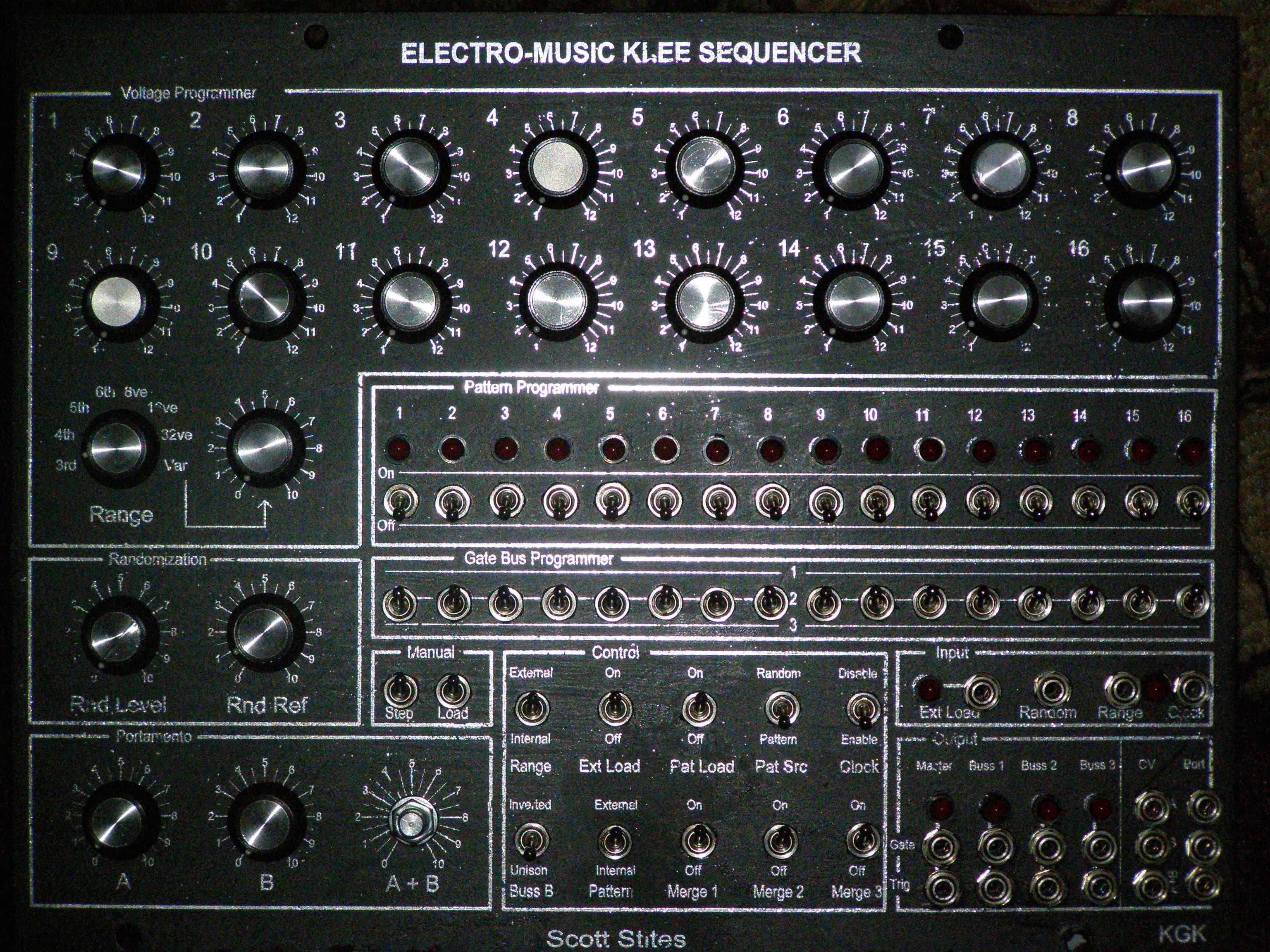

Figured this is a good place to show off my panel rather than the troubleshooting thread I had it tucked away in. Wink

Most Sick !!

psioniclabs, the job that you did is just amazing, sincerely congratulations.
Actually Im thinking in a future mod my klee with new features, and I was thinking in also make a PCB for hold the front panel components, do you have reference numbers of potentiometers and switches?
Sound
Joined: Jun 06, 2006
Posts: 842
PostPosted: Wed Mar 31, 2010 4:06 pm    Post subject: Reply with quote  Mark this post and the followings unread
Ops! they are pots with led?

That is awesome, psioniclabs!
My design is not so daring.
This panel has a mislabeling error -- the switch marked "External, Internal Pattern" should be "Mode: 8x2 16x1. I had to sneak the Clock LED next to the Clock input jack on the right side -- it didn't show up very much in the picture.

Yes sound I got the pots and switches both from Mouser:
Taiwan Alpha clear shaft pots:
Mouser Part #: 313-1400F-50K
Manufacturer Part #: RV141F-40E3-18BL-B50K
http://www.mouser.com/Search/ProductDetail.aspx?R=RV141F-40E3-18BL-B50Kvirtualkey14860000virtualkey313-1400F-50K
Switches are Mountain Switches:
Mouser Part #: 108-0044-EVX
Manufacturer Part #: 108-0044-EVX
http://www.mouser.com/Search/ProductDetail.aspx?R=108-0044-EVXvirtualkey12040000virtualkey108-0044-EVX
Mouser Part #: 108-0041-EVX
Manufacturer Part #: 108-0041-EVX
http://www.mouser.com/Search/ProductDetail.aspx?R=108-0041-EVXvirtualkey12040000virtualkey108-0041-EVX
Mouser Part #: 108-0042-EVX
Manufacturer Part #: 108-0042-EVX
http://www.mouser.com/Search/ProductDetail.aspx?R=108-0042-EVXvirtualkey12040000virtualkey108-0042-EVX
The switches sit a little bit higher than the pots, so it's good to add a thin washer to keep everything flush to the panel.
I detailed the whole process in a series of blog posts for my hackerspace group. The PCB and panel layout was all done together in multiple layers using Inkscape. I laid out the footprints for the switches and pots and moved them around as objects until I had something that would fit in a standard printable page. Then I drew the component traces to connect everything. I overlaid independent layers and put graphics/drill guides on those.
I made the PCBs from two graphic layers. Then I printed out the drill pattern on a single sheet mailing label. Just peel the sticky side and apply to the panel! Tap the centers and drill it out. Finally, the graphics were done with the top layer printed on another mailing label. Liberal coats of clear coat enamel were sprayed on top of that.
You can see that the actual cut steel panel is just slightly larger than a single 8.5x11 sheet of paper, so the edges are unfinished. Close enough though!
I've found this method to be incredibly cheap and easy to do with very good results!

The panels are 1/16" aluminum painted satin black. I used Front Designer software to design the panels and used DecalProFX to create the actual decals.

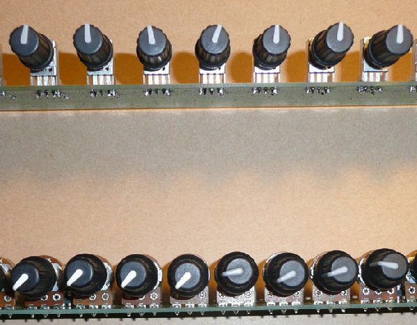

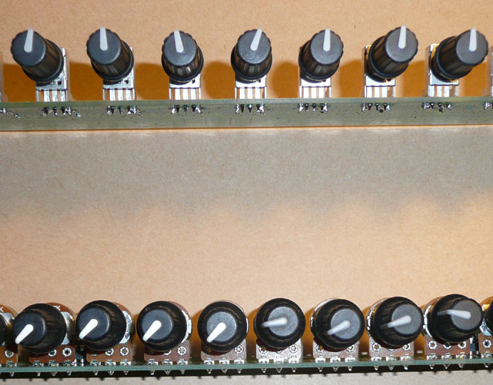

On the topic of knob sizes, here are two sequencer knob strips I'm working on. Both design for 19 inch rack mount panels.
Bottom one is part of a P3, designed to use the 16mm ReAn soft touch knobs a lot of us use. OK to twiddle, but a bit restricted.
Top one is a section of a 'Milton', (I'm currently shaking a few bugs out of he rather idiosyncratic design to make the LEDs work better). Pots are slightly wider spaced, and I got some ReAn P400s from Mouser. Much easier to use. I'm not sure if Mouser stock these in spline fit - they ones I got were for 'D' shaft knobs. The 'Milton' parts I got came with some Panasonic PCB mount pots. A big thank you to Tom Arnold for the kit, and to Cynthia Webster for advice on how to upgrade the LED and output drivers.
There is a little mentioned factor to think about here though: the 'gearing' effect of knob diameter vs fingers. Small knobs are harder to get fine settings with. Having started out in life with old valve, (tube), based test equipment, where a small knob was typically 20mm/0.75" diameter, and the main controls likely to be over 35mm / 1.5", I can certainly see the advantage in a big, wide spaced panel. Not many of us have the sort of space Raymond Scott had though, or would want to do all that walking up and down the synth. Good quality mixer style knobs are certainly a good idea in multiple arrays.
Some of you may have detected a slight sequencer fetish going on here......

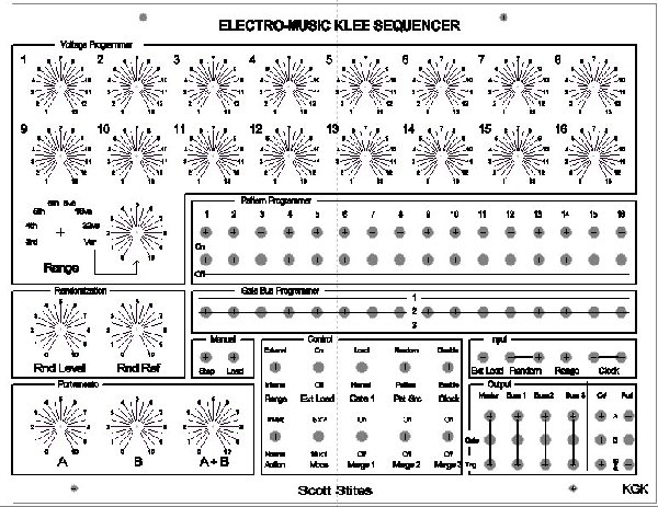

PostPosted: Tue Nov 30, 2010 12:33 pm    Post subject: My latest panel Reply with quote  Mark this post and the followings unread
This panel is similar to my 1st Klee Sequencer. My first panel had a couple of mislablings that I've fixed here.
The only thing I'd do differently would be to label the voltage programmers from 0 to 12 instead of 1 to 13. I just thought it would be fun to label them this way so the knob positions correspond to the notes when in the 8ve range.
My Klee Sequencer Front panel (designed with Front Designer)

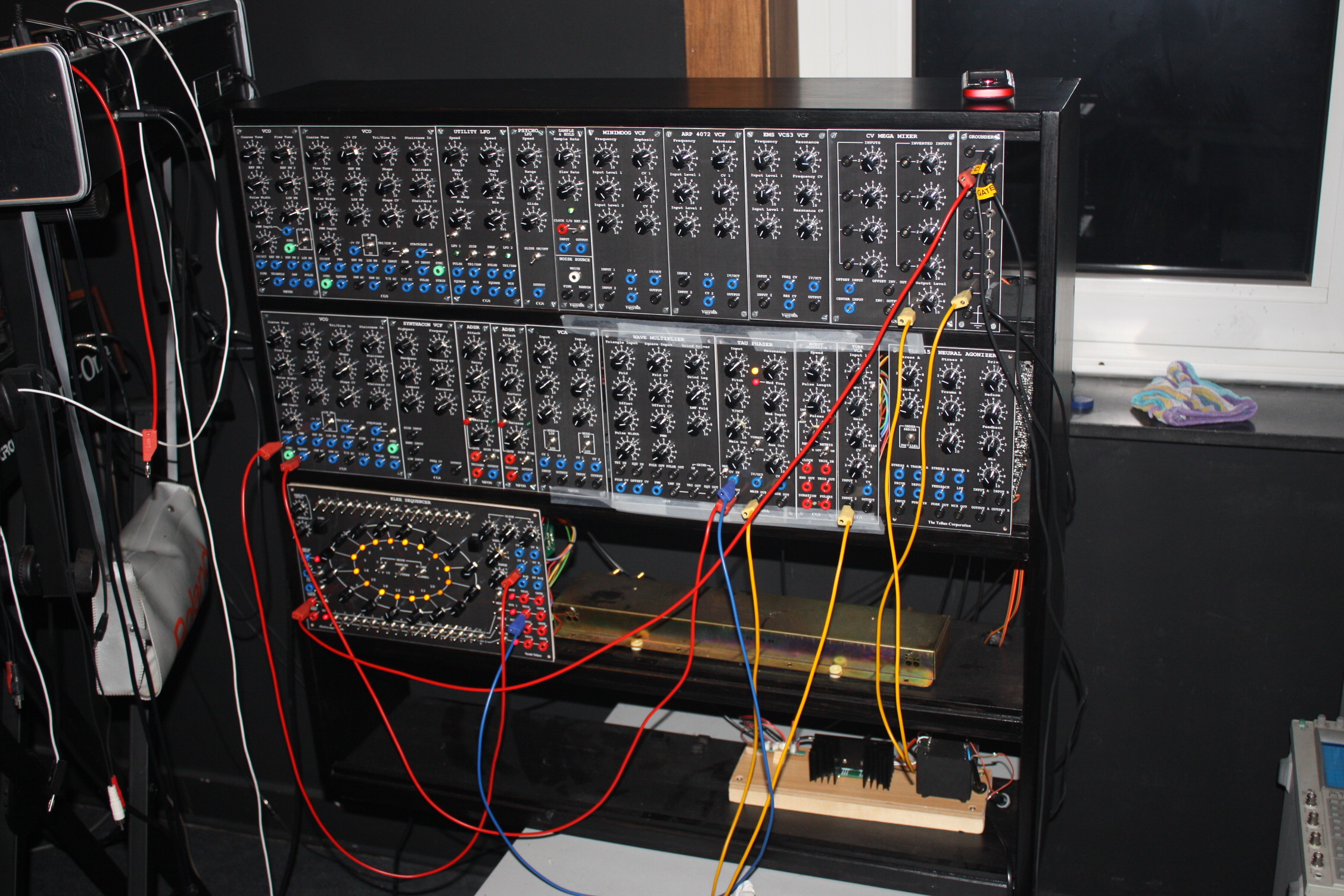

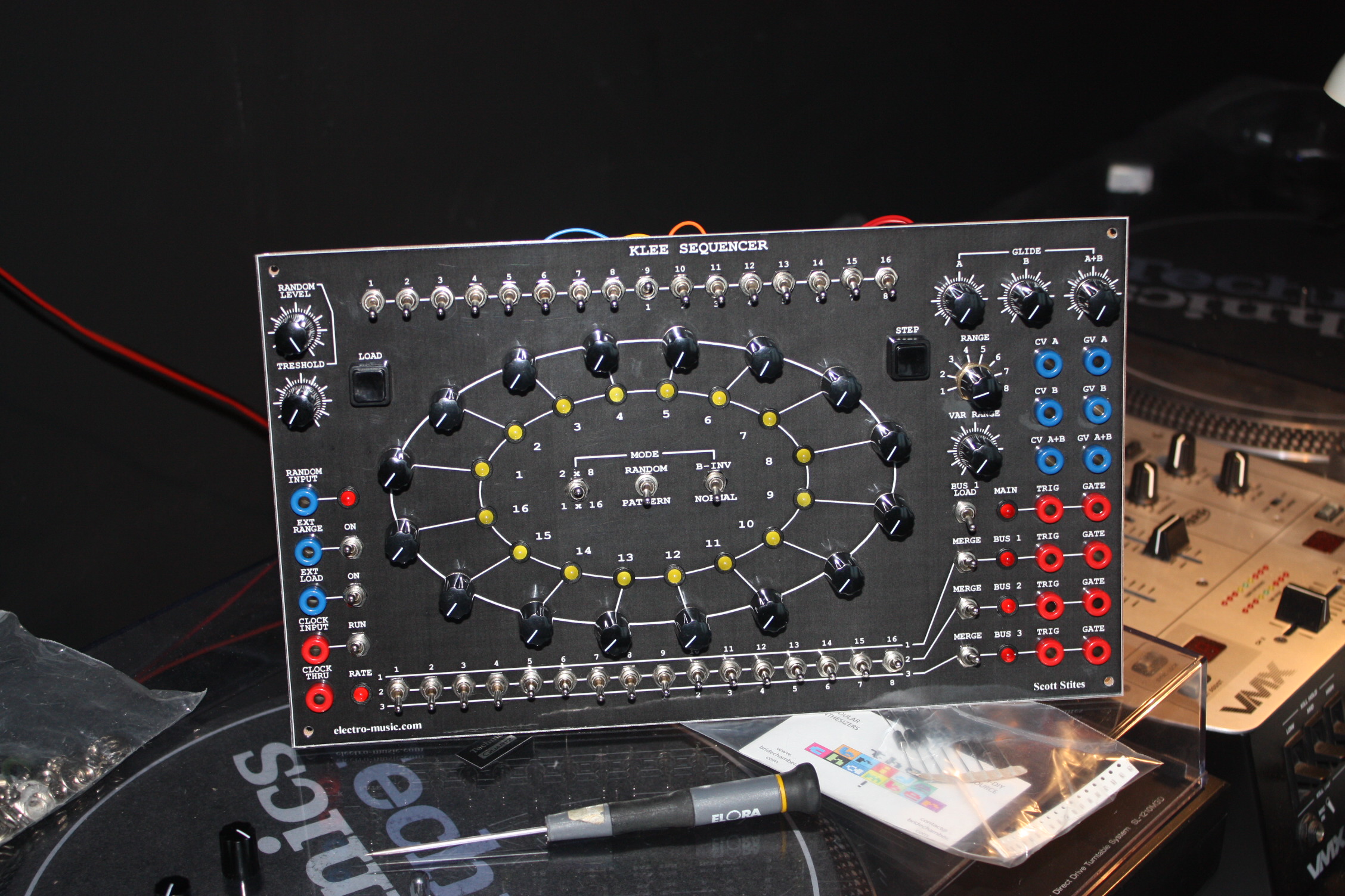

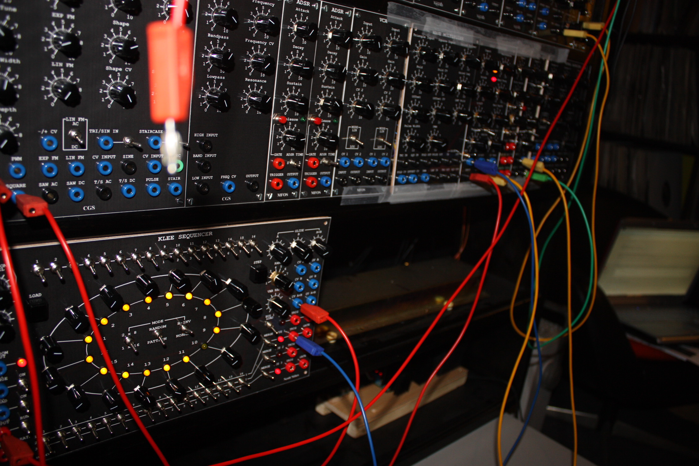

PostPosted: Wed Jan 05, 2011 3:51 am    Post subject: Reply with quote  Mark this post and the followings unread
Finished my klee sequencer on the 28 of december 2010 and it worked directly though some switches where reversed (wire's) but that was an easy fix Smile.
Verry powerful and versitale sequencer / tool !! I'm verry happy with it, the construction time was certainly worth the effort Smile
The module is 4U (serge) like the rest of my modules.
I based my design on Thomas white's design but made a more compact version.
Don't look to the ugly tape on the other new modules I still have to screw them into the rack...
