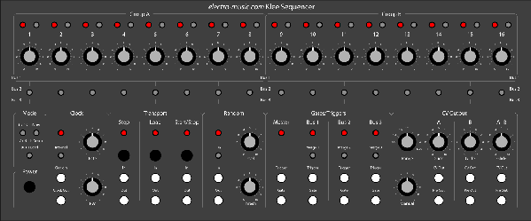

PostPosted: Sat Nov 24, 2007 7:50 pm    Post subject: Adam-Vs Preliminary Layout
Subject description: Moved from the build application thread
Here's my preliminary panel design.
I'm adding a few customisations:
    * Internal clock
    * External control of the start/stop and step functions for control of multiple units by the same button
    * Output of the random state just because I had the panel space to do so.
I will be implementing the manual (variable) range option however I would like to be able to select the maximum voltage as 1, 2, 4 or 8V. This can be done really easily with a dual gang rotary switch but am having difficulty finding ones that won't cost cost me a kidney (anybody know a good reasonably priced source for such items - rotary switches that is, not kidneys)
Adam-V
Klee preliminary layout by Adam-V
 Filesize:  63.09 KB
 Viewed:  1535 Time(s)

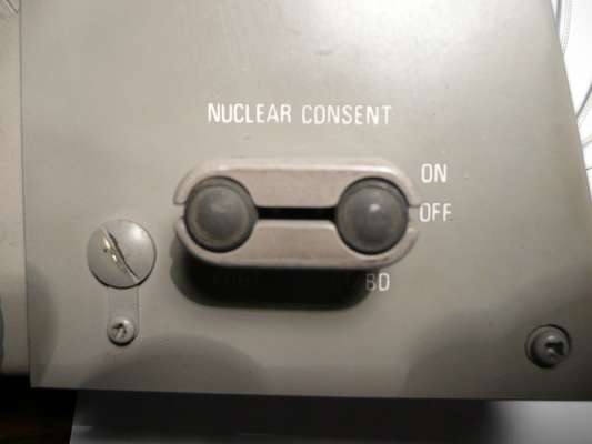

Absolutely right - there was a whole batch of C&K's that came from the same scrap source about 10 years ago, I never actually checked the paddle switches, and all the others were on-off-on. They'll still do the job, if Rykhaard is up for all the cutting out - the one reason I've never used them - they seemed too good to thow away on some small project, and a lot of work for a decent panel. They were originally mounted in a big slot with a gap between, probably just to get the rig working. British Aerospace, or British Nuclear Fuels Ltd, (I forget which).
Amongst some other scrap is the attached ...... must find a space for it on a synth panel one day. A very solid reliable pair of switches.....
Mike
And what does this one do.....
 Filesize:  44.22 KB
 Viewed:  62666 Time(s)
BNFL? If they are ex-nuke, then you may have the added advantage of them, ahem.... glowing in the dark! Shocked Laughing
Awesome! Cool

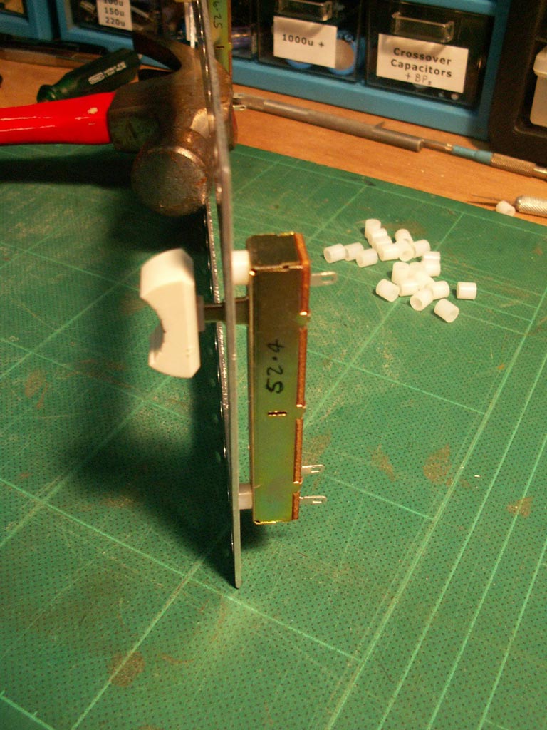

Which have some spacers like this.
 Filesize:  138.94 KB
 Viewed:  852 Time(s)

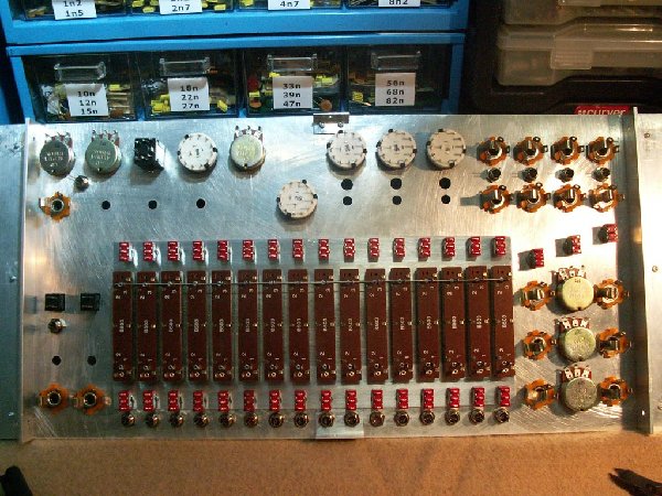

PostPosted: Tue Nov 27, 2007 2:15 am    Post subject: Reply with quote  Mark this post and the followings unread
Once they are all mounted, the extra holes have the toggle switches go through them, which holds it in place. Note:- make the holes for the toggle switches on the sub panel .5mm bigger than they "need" to be. This will cover the mis-alignment issue, which is a guaranteed certainty across 32 holes. Laughing
 Filesize:  181.06 KB
 Viewed:  872 Time(s)
PostPosted: Tue Nov 27, 2007 2:17 am    Post subject: Reply with quote  Mark this post and the followings unread
loopcycle wrote:
krunkus, i really like how you used a sub-panel to mount your sliders.
oh yeah, i wished i did it this way. it's worth the effort!
