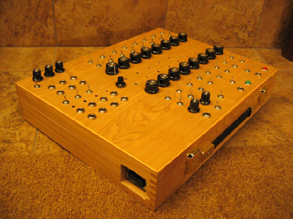

this is my art box klee panel/enclosure.
its missing the leds, graphics, and i still need to finish my harnesses and wire the panel.
it is self powered and portable. and it was cheap Very Happy

Now that's thinking outside the box ! Very inventive. Nice work.

That looks great! Very nice work.

Loopcycle, that is beautiful. I wish I would have done that with mine!

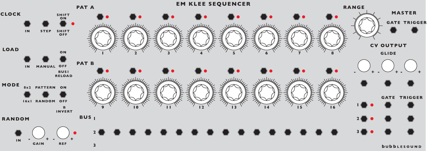

here's my half finished layout. it's really great to see everyone's idea of what the Klee should look like.

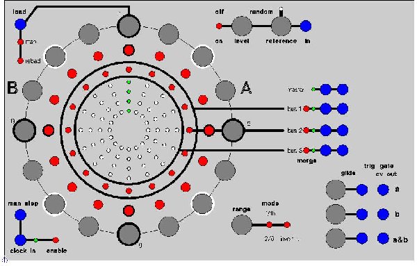

So here's my draft panel in motm format.
It looks ugly as sin at the moment. I colour coded some of the holes to explain their functions.
The dark grey are knobs, the green are leds, the red switches (small ones are toggle, large ones are pushbutton), and the blue are banana in/out.
The inner set of toggle switches in the circle will be mounted in a centrifugal pattern, so pointing inwards, center or outwards will select the gate bus for that step. The outer set will be pushbutton switches to select on/off per step.
The led rings will be powered by a cgs led driver circuit, so i can drive 4 leds per channel.
Some of the unused space on the right i will use for an internal clock (maybe with midi sync)
Any suggestions or criticisms will be appreciated, i won't be building this for a couple of months, so i wanna get the panel right.

PostPosted: Wed Dec 12, 2007 1:53 am    Post subject: Reply with quote  Mark this post and the followings unread
midgetfidget, I really like your design. I don't think it's THAT ugly!
Are you going to set up radial panel graphics too?

PostPosted: Wed Dec 12, 2007 2:26 am    Post subject: Reply with quote  Mark this post and the followings unread
i'm toying with the idea of an etched brass front panel, so the graphics will have to be simple.
PostPosted: Wed Dec 12, 2007 3:41 am    Post subject: Reply with quote  Mark this post and the followings unread
The line graphic which comes from the load socket I would draw to one of the push buttons (pattern switches) as these are what will be loaded, instead of the first level pot.
Similarly, I would have the gate bus line graphics go straight to the gate bus "circles" and not through the level pot at position 5. Have you thought of rotating the circle through 11.25 degrees so the 12 o'clock position is the "gap" between step 16 and step 1? This way it might make the gate bus graphic a bit less ambigous, as all three lines could go between the pots to the "circles". Does that make sense?
Apart from that, I think it's a really beautiful layout. Very Dr Who. Very Happy

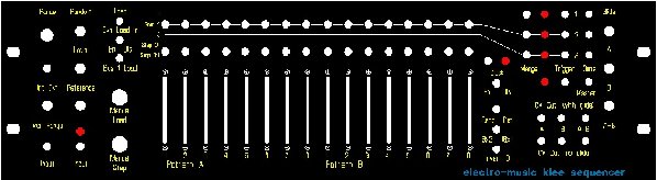

A little late to the party, but here's my panel-in-progress. Need to double-check all the hole sizes, placements, knob clearances, etc, this weekend. I'm using 1/8" jacks (my main box is a Paia 9700). And I purchased sliders with leds in them so that's why there's not a row for pattern leds.

just an idea: take a look at the way uncle krunkus mounted the sliders. i wished i would have done it that way...

hey fonik,
why is that? is it because it made the sliders lower profile?
PostPosted: Sat Jan 12, 2008 5:27 pm    Post subject: Reply with quote  Mark this post and the followings unread
i mounted the sliders with two srews per slider to the front panel: 16x2 holes in the panel. uncle krunkus mounted the sliders to a subpanel. this subpanel is mounted to the frontpanel utilizing the switches, which have to be mounted anyway.
so it is because these 32 screws cannot be seen - very nice IMO.
