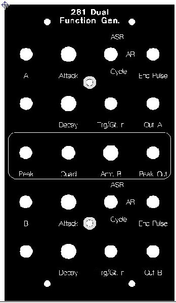

PostPosted: Wed Mar 18, 2009 1:31 pm    Post subject: Reply with quote  Mark this post and the followings unread
mono-poly wrote:
Does anyone got a single size frack layout?
just got these back from Schaefer yesterday... test fit all the components (16mm alpha pots) and everything fits, but it's tight. those countersunk holes are for mounting the boards (on spacers, using flathead screws); delete 'em if you going to add a bracket.
thanks to all for sharing their designs, and for permissions to shamelessly follow in yr footsteps...

zthee
Joined: Feb 20, 2008
Posts: 414
Location: Stockholm
PostPosted: Sun Mar 22, 2009 3:36 pm    Post subject: Reply with quote  Mark this post and the followings unread
Problem: I had D (from board A) connected to B instead of A (On board B) - so quadrature didn't work. Everything else worked OK.
So I changed the wiring, so it's correct. Now neither quadrature nor cycle will function.
I've checked end pulse out. And there is no output there.
My first thought is that there is something messing with IC3.3? or in that area?
- Think I found the error - Had a TL074 instead of a TL064. using a LF444 now, and operation have improved. Though not 100% yet.
One strange thing is that if i put it in cycle - and change the rate to faster it looses the end out pulse. Could be the LF444 though..
