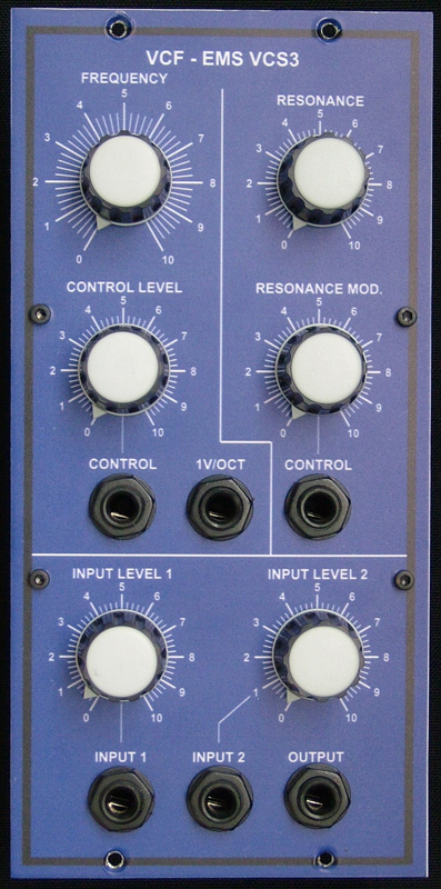

PostPosted: Sat May 29, 2010 8:33 am    Post subject: Reply with quote  Mark this post and the followings unread
Hi:
I've calibrated the filter, it sounds great without resonance, very clean, a
lot different of my other filters. With high resonance the sound is nice too
but when start to self oscillate the filter do some weird things, the cutoff
frequency becomes unstable, but when the resonance reaches full self oscillation
the behavior gets back to normal. Also is strange that the self oscillation disappear
at high frequency (beyond 9KHz).
I don't know if all this is normal.
One thing that really surprise me was that the filter tracks 1V/Oct very well,
far better than the Minimoog VCF. Is perfectly in tune by 2 octaves, but out
of that range the deviation is minimal, less than half a semitone per octave.
A funny thing is that if I modulate the cutoff with a LFO and I move the
cutoff frequency, the LFO frequency compresses and expands itself, it's
hard to explain...
Here are some pics of the VCF.
hard to explain...
I Sebo
As a matter of fact the behaviour of this file is depending very much of the input level. If you feed it with yusynth VCOs, you have to set the input level to mark 3 (or maximum 4) to get the EMS sound, if you go beyond that mark the filters starts sounding like a Moog filter up to mark 6 where the filter starts to saturate. If you are using levels above mark 6 you will have the behaviour you described close to auto-oscillation. Somehow the autoscillation starts to interfere with the input signal giving harsh sounds.
I could have limited the input level of this filter to the "EMS range" that is under mark 4, but I thought it is nice also to go beyound and have larger palette of sounds with the same filter.
This is a very general remark concerning all the original filters (Moog style, ARP style and EMS style) they were designed to work with a given input level. Therefore, when incorporated as a single module in a modular one must play the input levels to obtain the desired behaviour Wink
