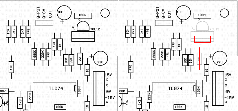

yusynth
Joined: Nov 24, 2005
Posts: 1314
PostPosted: Wed Jan 21, 2009 12:27 pm    Post subject: Reply with quote  Mark this post and the followings unread
Hi Chaorta and welcome
Concerning the PCB I can't tell you because I have no Doepfer case to check it. But may be if give the size of the PCB you can make yourself an idea. The PCB is 10 cm per 7.5 cm and has four fixation holes.
Concerning the power supply, yes it will run at +12V/-12V, for this you just need to remove some components : remove R3 (82ohm) and bypass its pads with a wire, remove U2 (78L12/7812) bypass with an insulated wire the left and rigth pads (leave the middle pad unconnected) and that's it (see the diagram below : left before mod, right : after mod, bypass wires shown in red)
 Filesize:  43.57 KB
 Viewed:  916 Time(s)
Yves

PostPosted: Thu Oct 29, 2009 6:34 pm    Post subject: Reply with quote  Mark this post and the followings unread
I just finished building this one tonight. At first, it didn't work properly, but using the 220 resistor as described above did the trick. It sounds terrific! I am using it in my Dotcom system, but I left R8 alone. for now. The input control knob should be enough for my needs. It won't do any harm will it?
In any event, I still need to mount the PCB to the panel. After that, I will do some A/B comparisons with my VCS3. I'll post the results in another thread.
