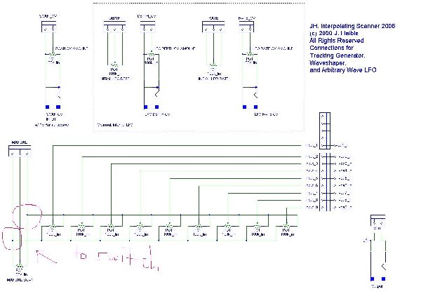

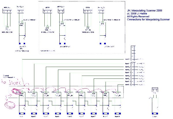

PostPosted: Thu Oct 02, 2008 8:23 am    Post subject: Reply with quote  Mark this post and the followings unread
I have prepared my Frontpanel to have a Center Pot.
I recognised that it has a Center "pot" when looking to the schematics because i like to have a LFO out.
Ok, now i see the Center "pot" is just a Trimmer Embarassed ( i should not build that chaotic Wink )
I like to have the center pot for the LFO, thats a good thing !
Q1: is there any Problem or something i should be aware when replacing the Center-LFO Trimmer with a Pot ?
Q2: as metioned, i'll try to bring the LFO to a Jack. I take it bevore the junctionpoint with Scan-CV in.
Any problems when i do so ? do i have to buffer the LFO ?
Q3: the Faceplate is prepared to get a Switch to switch between Scanner and Tracking generator.
As far i understand this is just a thing of normalisation/ Ground connection of Jack 1.
I just switch this connections from Jack 1, is that right ?
( all the Groundwires of the input jacks are then ofcourse wired in a Chain to Jack 1. All Inputs are normalised. and the switch connects to Manual CV )
i thought to that Idea while i was drilling the faceplate:
One could use the Scanner also as a Mixer
----> Wire all inputs behind the pots to a (additional) mixerstage and just make mix out jacks.
so if the interpolating Scanner is not needed it can act as a (Big) mixer.
The Frontplate would need just one more Jack .
hmmm, i have to surch for that little free space for that one Jack... Laughing

The LFO output (buffered, but before VC level control!) is U15, Pin 7.
The trimmer is just to center the LFO swing around the input offset voltage of the OTA U14B - there is not much use for it otherwise. Nothing you couldn't achieve by adding a DC offset.
JH.

PostPosted: Thu Oct 02, 2008 9:39 am    Post subject: Reply with quote  Mark this post and the followings unread
About combining Scanner and Tracking generator:
If you start with this picture (Scanner) http://www.jhaible.heim.at/interpolating_scanner_and_scanvib/jh_interpolating_scanner_wiring.jpg
and normalize the first (left) jack to +5V instead of GND, you have an unipolar (positive output only) tracking generator. Derive the +5V from +15V with a 1k5 and a 3k resistor. Do *not* normalize to a voltage without a resistor in between, as plugging in cables might monentarily short something.
JH.

PostPosted: Fri Oct 03, 2008 9:28 am    Post subject: Reply with quote  Mark this post and the followings unread
JH.
hmmm, i dont understand really, and my english.........
Does this mean the LFO is centered to the settings of Manual CV and CV in ?
hmmm, there's then one Hole to much in my faceplate Laughing

I thought i switch both:
+V as a normalisation to Jack1,
-V will be swapped with the Grnd Connection of Pot 1 ( and the other pots as they have Grnd wired in series )
I hope my Idea works ?
I thought i can do all with a DPDT switch.
( the other question i keep open , i just need clarity about the switching for now)
the market points i like to wire to a switch .
 Filesize:  102.45 KB
 Viewed:  370 Time(s)
GRnd connection and Normalisation of input 1 to switch
 Filesize:  121.55 KB
 Viewed:  366 Time(s)

Funky40 wrote:
Should work.
Except that you should *not* get the voltages directly from +/-15V (board connector for manual scan pot) if you do any routing via input jacks.
Try getting +/-5V - either with passive dividers as described above, or get +/- 5V from the suppies with some short-circuit protected buffering (limit to 20mA or so).
JH.

jhaible wrote:
Should work.
JH.
ok, so i'm fine with my Design on this one.
concerning my Module:
it is anyway thought to bring out the CV from the Manual pot to a own CV out socket.
First i thought i just buffer it.
But as it is +-15V i gonna put a stereo pot in there, and i will feed this then with +-5V over a dougther Board.
That seems to be the best Solution for me.
so this signal will then be used for the Tracking generator too.
Is it ok just to put a TL072 Buffer between the pot and the input sockets ?
some resistors needed behind the TL072 ? 1K i assume
jhaible
Joined: May 25, 2007
Posts: 2014
PostPosted: Fri Oct 03, 2008 2:46 pm    Post subject: Reply with quote  Mark this post and the followings unread
I wouldn't use a TL072 for buffering DC.
LM358, MC1458 - something like that.
Try 330R at the opamp output. This is to prevent oscillations, more than to limit the current.
JH.

Ok, so I thought I was ready to start connecting my controls... But I'm not. After reading and re-reading the wiring diagrams I am now really confused.
I was hoping to configure my PCB as the Interpolating Scanner and run synths or guitars through it as in the Waveshaper sound example on the Scanner/Vibrato page. Should I be following the "Interpolating Scanner" instructions or the "Waveshaper/Nonlinear Function" instructions?
-Clay
jhaible
Posts: 2014
PostPosted: Tue Oct 07, 2008 11:44 pm    Post subject: Re: Slow Down Reply with quote  Mark this post and the followings unread
-Clay
I think I have to draw a diagram for a combined function.
JH.
JH.
I would also appreciate it much to have a combined diagram. I have wired everything for a scanner, and am now looking at how to expand it to a waveshaper as well.
Erez Yaary
jhaible
Posts: 2014
PostPosted: Wed Oct 08, 2008 8:54 am    Post subject: Re: Slow Down Reply with quote  Mark this post and the followings unread
whomper wrote:
JH.
Done:
http://www.jhaible.heim.at/interpolating_scanner_and_scanvib/jh_interpolating_scanner_and_scanvib.html
JH.
