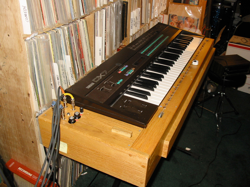

Thanks for that valuable info, Ira! I heard from Lorin Parker, who has been inside an earlier model, and it was a variable air capacitor on the earlier models.
OK, I finally finished my Martenot Controller, and posted a new video today. I demonstrate the newly-added volume control, and give an overview of the instrument:
http://www.youtube.com/watch?v=px0LhGmJ5pM
Best to you all!
- Dana

PostPosted: Tue Mar 03, 2009 11:02 pm    Post subject: Dana Martenot Web Page
Subject description: I made up a web page, documenting how I built this Martenot Controller...
Now that my Martenot Controller is complete, I made a web page, showing how it was built.
I hope it helps some of you with your own Martenot projects.
http://www.danacountryman.com/martenot_project/martenot.html

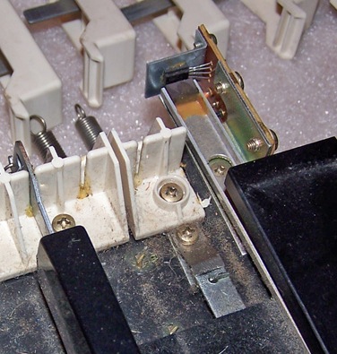

Ira Kraemer wrote:
The keyboard floats on a nylon cord suspension so that it can be played with vibrato. A slight pitch variation can be accomplished on any key by vibrating the keyboard from side to side. This is accomplished by a very low resistance wire wound pot which is specially designed for this instrument.
I'm wondering if the same can be achieved using hall-effect transistors to control the vibrato rather than a wire-wound pot?

v-un-v wrote:
It is the way aftertouch was implemented on some old monosynths such as the Roland SH2000
Aftertouch of the Roland SH2000, a small magnet (attached to the mobile keybed chassis) is located in front of a fixed Hall effect detector
 Filesize:  62.82 KB
 Viewed:  43450 Time(s)

yusynth wrote:
Interesting!
I'm seriously considering building a leaf-spring mounted keyboard for manual vibrato of the keyboard, as in the Martenot and Ondioline.
I wonder - what kind of circuit could this kind of transistor use for voltage control, and why would it be better than moving a slide pot back and forth?
The reduction of the amount of friction would be the only reason I can think of...
The reduction of the amount of friction would be the only reason I can think of...-dc
Hi Dana,
Actually if you have a look to the datasheet of some usual Hall effect linear devices (be sure to pick a linear one because most of the hall effect devices are ON OFF devices) http://www.datasheetcatalog.com/datasheets_pdf/U/G/N/3/UGN3503LT.shtml it is just a matter of using a JFET OPamp to buffer (and if necessary amplify) the signal at the output of the hall device.
The advantage are, as you said the lack of friction and also (and it is very relevant) the absence of aging of the detector to the opposite of a potentiometer track...
Yves
