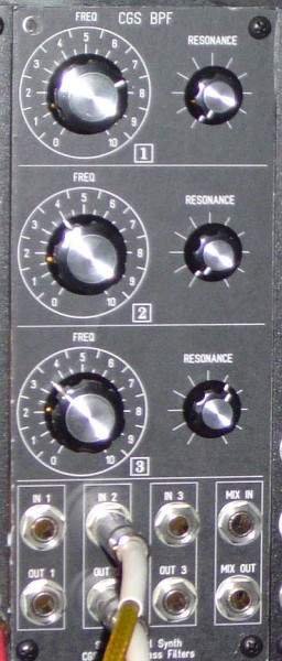

PostPosted: Thu Oct 06, 2011 8:42 pm    Post subject: CGS30 Bandpass Filters
Subject description: MP3 and two module pics
Hi - I just finished building my set of 3 CGS30 bandpass filters, and thought I'd share.
Here are two pics and a sound clip:
BPF30 PCB view
 Filesize:  95.26 KB
 Viewed:  1103 Time(s)
BPF30, 5U Panel
 Filesize:  81.55 KB
 Viewed:  991 Time(s)
CGS BPF30.wav
CGS30 BPF audio demo (yes, it's a bit out there!)

good stuff - very vocal, kinda sounds like my friend's staffy when he tries to talk

Thanks Andrew - I'm happy with the sound of the module, but I noticed that the mix output is very low in amplitude compared to the indivdual outs. I think I might have to change the feedback resistor on the mixer board.

Looks and sounds great Smile

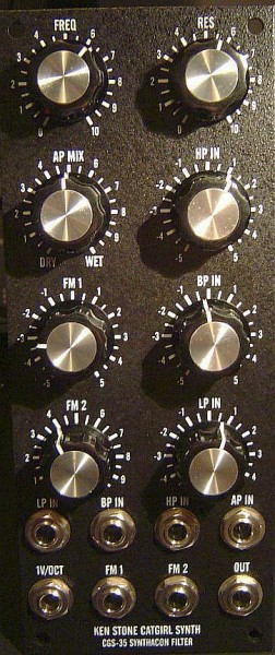

PostPosted: Sat Jul 28, 2012 10:32 pm    Post subject: Synthacon - Finally built! Reply with quote  Mark this post and the followings unread
I completed another CGS module from my long-term backlog. It's a Synthacon filter PCB I bought around 8 years ago.
Below are some pics. Here's a link to a track I recorded using this filter exclusively (ie. no other filters, but I did use other modules Smile). The only effects are some delay from my DAW, and reverb effects from a Neural Agonizer.
http://soundcloud.com/goom/journey-through-nothing
The front panel is a Stooge panel (RIP Larry Hendry). It has reversible attenuators for High Pass, Low Pass, Band Pass and the FM 1 input. I built a reversible input attenuator circuit to account for these front panel functions. There is also a Wet/Dry All Pass Input mix control.
Anyway, nice filter, Ken!
