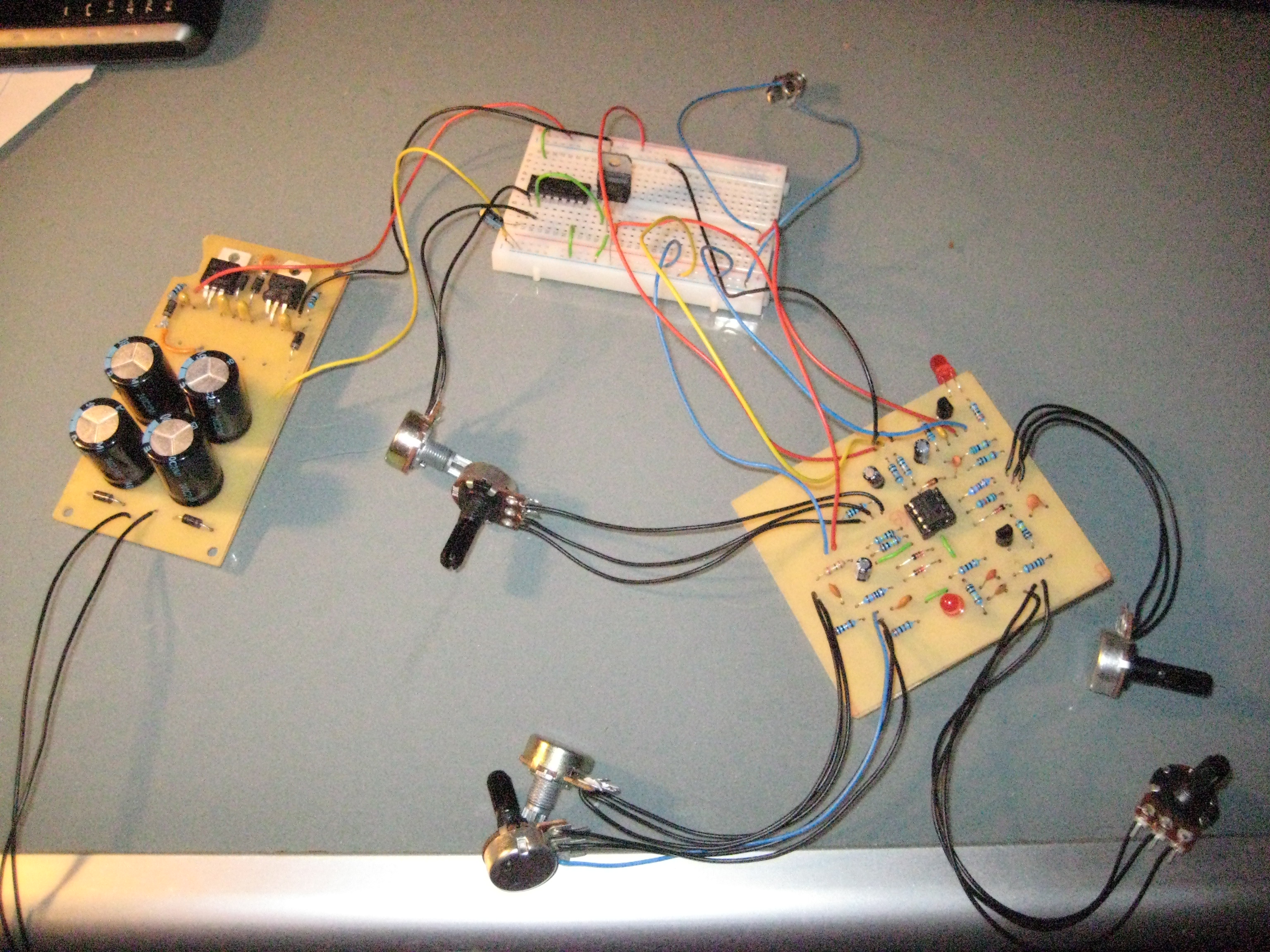

PostPosted: Sun Nov 16, 2014 10:56 pm    Post subject: Reply with quote  Mark this post and the followings unread

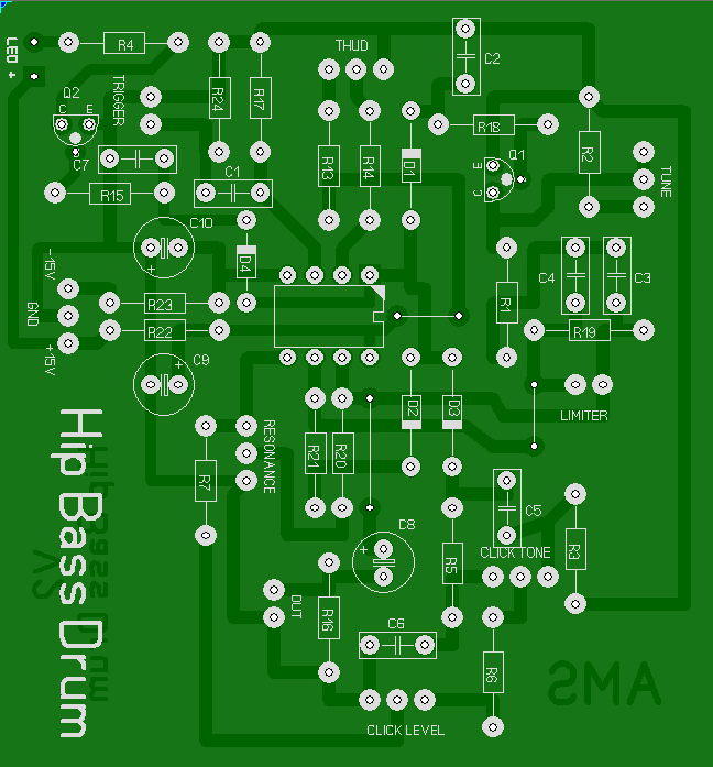

Okay i made some Pictures. In Place of the 6 LED for Limiting there is just one. Shouldn't be a problem, though. You can have a look at it, and maybe you will find something. Hopefully! Thanks!
Layout from KRS1972, earlier in this thread:
The whole Setup with Power Supply and Trigger Circuit
 Filesize:  2.16 MB
 Viewed:  1008 Time(s)

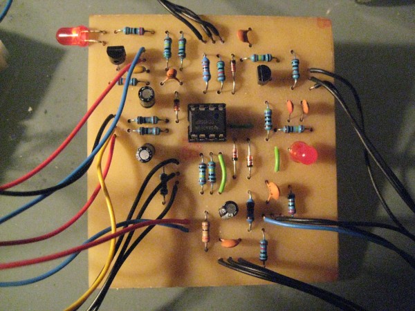

The Board from the Top
 Filesize:  625.52 KB
 Viewed:  981 Time(s)
The Board from the Back. Sometimes it looks like there are unwanted bridges, but its just some kind of dirt, not solder...
 Filesize:  625.58 KB
 Viewed:  897 Time(s)
Close Up. The green stuff is dirt from the soldering tin. I don't know, is this normal? I think its the dried flux?!
 Filesize:  374.17 KB
 Viewed:  891 Time(s)
wackelpeter
Joined: May 05, 2013
Posts: 461
Location: germany
Audio files: 10
PostPosted: Mon Nov 17, 2014 8:24 am    Post subject: Reply with quote  Mark this post and the followings unread
ouch... the solder Points doesn't look so good... is this lead free solder you're using? a year back or so i accidentally bought lead free solder too... it's terrible stuff... you should better use solder with lead as it's much better to solder and cold solder Points are better visible... those on your pcb look nearly all like cold solder Points to me... could be the solder, the one i had looked similar...
also you should clean the pcb Scratching that dirt off of it and then go other it with a Piece of Cloth...
especially those dirty points between traces and next to other solder Points as you can't see if there's a small Bridge underneath them...
i do use a very small skrew driver and an old tooth brush and a magnifier...
p.s. youre shure on your 4558 chip that there isn't a Bridge at pin 1 and 2? Looks a lot like that...
the limiter led isn't that important and can also be omitted together with that Switch... it's just really loud w/o led's...
btw. i'm thinking that someone could also Switch that led's electrical in and out to get some Kknd of Accent like the dr-606 had it...

PostPosted: Mon Nov 17, 2014 9:37 pm    Post subject: Reply with quote  Mark this post and the followings unread
Hey, the Solder is indeed strange. first there are is this weird green dirt everywhere. they emerge out of the liquid around the solder spots. i guess its the "flussmittel". but normally it shouldnt become a green, dry mass later. Also its sparking sometimes while soldering. not really sparks in terms of light, but more sparks in the accoustic sense. it goes "brrz" when i solder.
But its not lead-free. In fact it ahs a lot of lead. Its S-Pb60Sn40. I dont know what the S means, but it has 60% Lead and 40% tin. A quick research got me the information that normally it should be the other way round. This might really be the problem.
I think i gonna get myself a decent solder and do it all again. And FUCK CONRAD, they told me there is no difference i should just buy whatever i want, so of course i got the cheaper one...
edit: actually i found another thread where they say its complettely okay Laughing http://www.rc-network.de/forum/showthread.php/326314-Pb60Sn40-anstatt-Sn60Pb40-L%C3%B6tzinn-auch-ok (german)
but i jsut cleaned it a little with a toothbrush (good tip) and try it again
