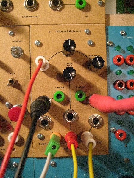

PostPosted: Sat Nov 21, 2009 2:30 pm    Post subject: Reply with quote  Mark this post and the followings unread
Hello,
I've just finished my first VC Panner, I was wondering if I could use 20K trimmers on my others, I've run out of 50K?
This one works really well though, thanks Fonik!

PostPosted: Sun Dec 20, 2009 2:49 pm    Post subject: Strange panning behaviour Reply with quote  Mark this post and the followings unread
Hi Fonik,
I've been using my panner/fader for a while now and notice that if im panning a signal using just one input from left to right the signal is full strength when panned full left or full right but in the middle it is maybe half the volume, is this normal or could there be something wrong with the unit? I've doubled checked that all the resistor values are correct. Could it maybe be a phase issue?
Thanks,
PostPosted: Sun Dec 20, 2009 11:21 pm    Post subject: Re: Strange panning behaviour Reply with quote  Mark this post and the followings unread
lexvortex wrote:
Hi Fonik,
Thanks,
this is normal. however, half the volume is what your hear, not what you'll measure. anyways, IIRC i suggested somewhere in this thread to lower the values of R46 and R50 to compensate (72k?).

PostPosted: Mon Dec 21, 2009 3:10 pm    Post subject: Reply with quote  Mark this post and the followings unread
Hi Fonik,
I just tried the mod of replacing R46, 50 with 75K and that just increased the volume of the center input jack, which is not what I wanted (I should have looked at the schematics more closely).
What I had hoped to achieve was taking one signal from either the left or right input jack only and having it pan with equal volume from left to right; right now the volume decreases as it reaches the center position.
Is there a way to make the panner pan with equal volume across the stereo field?
Thanks,
PostPosted: Tue Dec 22, 2009 12:16 am    Post subject: Reply with quote  Mark this post and the followings unread
sorry, my fault - should have been the other way around! maybe 150k?
not with this simple circuit. this would need a more sophisticated design. the VCAs would have to be exponential in response, i believe.
