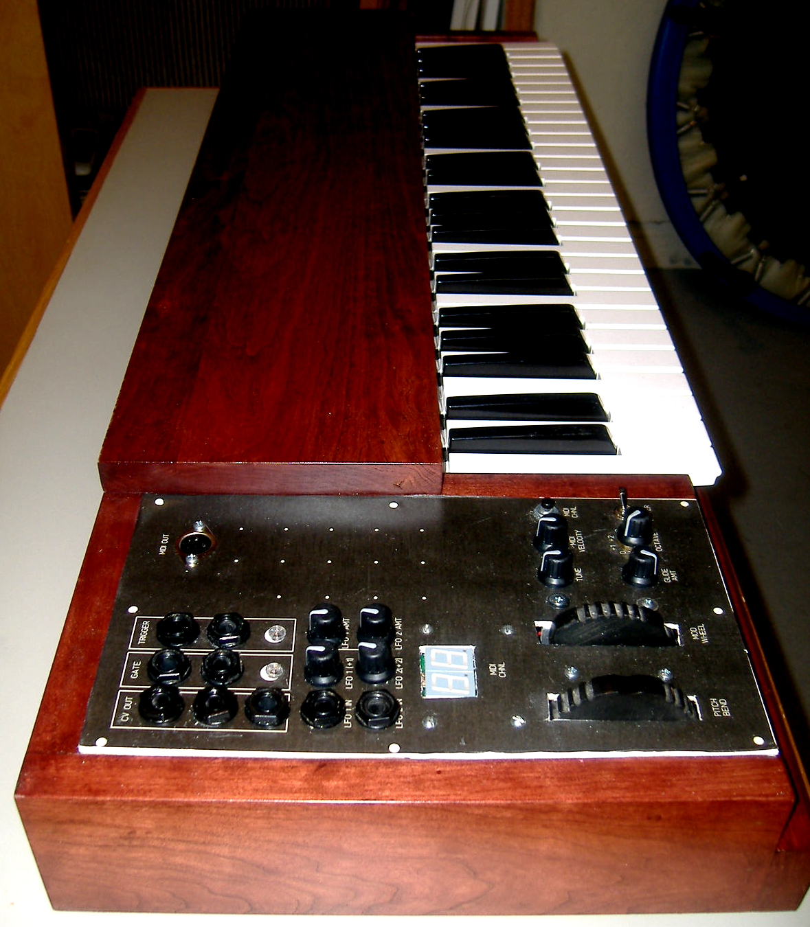

My custom front panel for the keyboard that is being built with the sMs "IKC" and MIDI Channel Changer (MCC) electronics.

PostPosted: Mon Oct 27, 2008 7:29 pm    Post subject: My Front Panel Designs Reply with quote  Mark this post and the followings unread
Here's just a couple files outlining how I did my IKC. I modeled my design after the ARP 2600 keyboard. I wish I had made the panel a little wider though as I think our daughterboard will force me to move stuff around to accommodate the width.
The mod wheel uses a grounded center tapped pot so I can feed 2 separate LFO's into each end of the pot and access each by turning the wheel forward for one LFO and pulling it back towards me for the other LFO. The detent of the pot matches the center tap. I bought this from EML about 30 years ago!
Anyway, there's a million ways to design the keyboard case and front panel and it's probably the most fun part of the project!
-Dan
Thanks for posting the picture Dan. I was up to my limit of attachments in my opening post. Shocked
I agree with your statement above BTW. the user can create any type of control panel to suit the need. In fact the IKC can be connected to an array of 64 switches and use it as a MIDI controller to trigger any event in, for example, a software synthesizer. The documentation shows you how to do this.
Although my documentation has one interconnect diagram, on can as creative as they want with the IKC. I decided to create 3 way multi's for the GATE/TRIGGER and CV outputs, as you did Dan, on my front panel. In addition, a foot pedal can change velocity over MIDI and/or the analog control voltage.

Looks like excellent work -- as usual -- from both Bill and Dan. Me, I'm holding out for polyphony, or at least two-voice.
Dan, is that the Cherry you mentioned? Looks great.

[quote Dan, is that the Cherry you mentioned? Looks great.[/quote]
Thanks, Richard! Yes it is the "found" cherry wood that my father-in-law had. Fortunately I have broken him of his oak habit for everything!
