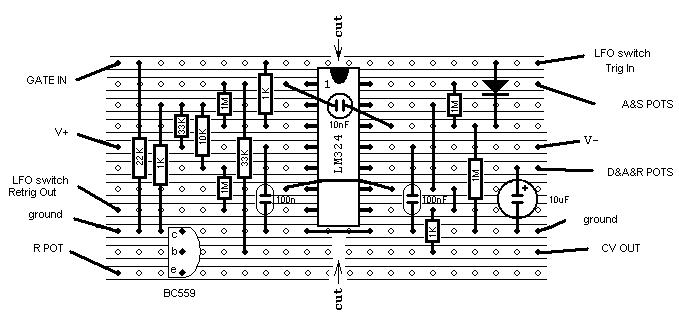

Yes with no gate and the trigger doing the LFO thing (or triggered from elsewhere), it behaves like an AR, but with the possibility for a slightly more complex than usual R portion. You can make it decay fast initially then slowly until it retriggers. That is with the S set middling. Set like this it also has the curious characteristic that the LFO can be gated, but in reverse - the LFO oscillates when the gate is low, not when high. With the S set low it is like a normal AR, but the gate can be used to switch between two different decay rates. So for a simple circuit it can do a few tricks. I have not yet built a second one, but when I do I am looking forward to seeing what it will do when the two are set to trigger each other. I also think it would benefit from an LED on the output to help me see what it is up to.
And for anyone interested in breadboarding or building on stripboard, here is my stripboard layout. Be aware that two diodes and several resistors are not on the board, but instead hang off the back of the pots and sockets on the front panel. Let me know if you need help with the panel wiring side of things, but I have not diagrammed that at this stage.

Thanks a lot for the strip board layout, it's in my folder of things to build Smile

nicolas3141 wrote:
Here's my ultra simple ADSR that can also retrigger itself to behave like an LFO. Mine is running off +/-9V with an LM324 doing the business. You might need to tweak a few resistors around the gate input area if you wanted to go to +/-15V, but probably not by much.
so you powered the quad OpAmp from a dual supply. i wonder if it wouldn't run on a single supply? you even used a LM324...

PostPosted: Mon Feb 16, 2009 1:40 am    Post subject: Reply with quote  Mark this post and the followings unread
Single supply would require a little bit of tweaking, but not much. The downside would be that low sustain levels would not work properly because the LM324 cannot sink any significant current down to V-. Fixing that problem would require an extra transistor or two, but is doable.

fonik wrote:
i will etch myself some boards, i think.
This ADSR has so far been built by me and a couple of other people, but please be aware that it may still need a little fine tuning to be at its best. In particular we were building in a context of +/-9V supply and 0-5V CV. So in a normal modular everything is running at higher voltages. This should not be a problem, but some fine tuning of resistor values may be required to get it just right. I encourage you to build a prototype before you commit to PCBs.
For example I have already mentioned the resistors either side of the sustain pot. And also regarding the sustain, if your synth has a reference voltage cleaner than the V+ supply, you should use that instead for feeding the sustain pot and adjust the resistor values accordingly.
The peak voltage of the attack is determined by the ratio of the 1M resistors around the central op-amp multiplied by the highest output voltage it can manage. So if it is not giving you what you want you may need to reduce the grounding resistor a bit to give you a hotter peak.
yep. that's what i normally do. i breadboard it first to be sure. i won't do all that drilling without knowing it will do the job Very Happy
however, thank you very much for the comments and recommendations. very helpful.

PostPosted: Wed Feb 18, 2009 1:07 am    Post subject: Reply with quote  Mark this post and the followings unread
here is my 1st attempt on a eurorack compatible layout providing footprints for cliff sockets. hopefully i get this thing breadboarded soon, in order to place an order together with the PS3100 PCBs...
1st version

Hey nice work Matthias! Cool
edit- but I was just thinking, the pots are a bit close together. Because the design is so simple, it would be nice if the board could be mounted on a front panel without the need of L-brackets etc. Also the lfo switch too? Idea
fwiw, I found about 100 LM324's in my loft! Shocked
ACHTUNG!
PostPosted: Wed Feb 18, 2009 2:46 am    Post subject: Reply with quote  Mark this post and the followings unread
first and foremost this is a panel design for my own purposes. it is mounted to the fronpanel using the PCB mounted cliff jack sockets. the switch is PCB mount type, too. the pots are connected using common MTA100 conenctors.
the advantage of mounting the board using the sockets instead of the pots is to be able to use a smaller frontpanel (just 800mil grid, which would not be possible with 16mm alpha pots mounted in a 90 deg manner).
however, i will try a single sided layout for homebrew, too. and what about an indicator LED?

matthias, did you arrange to do a run of these, or are the pcb's you're ordering for personal use? also, nicolas, PM me if you're interested in doing a run of these. yes, dual board design would be great.
PostPosted: Wed Feb 18, 2009 7:30 am    Post subject: Reply with quote  Mark this post and the followings unread
it is not my design and not my decision. it is all up to nicolas. in any case i will order some boards with cliff footprints for me.
take a look at the stripboard layout above. one could do it on stripboard anyway.
