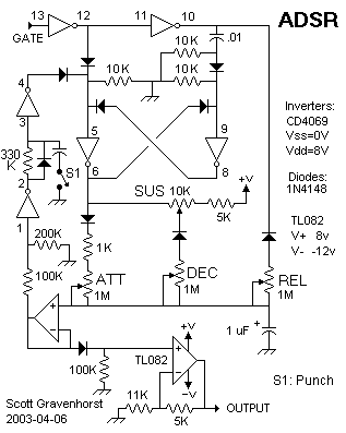

PostPosted: Wed Feb 09, 2011 8:01 am    Post subject: Reply with quote  Mark this post and the followings unread
Here's my ADSR design based on a CD4069UB IC and a TL0x2 opamp (note that I used TL082, but TL072 should work too). S1 is a "punch" switch.
CMOS (mainly) ADSR

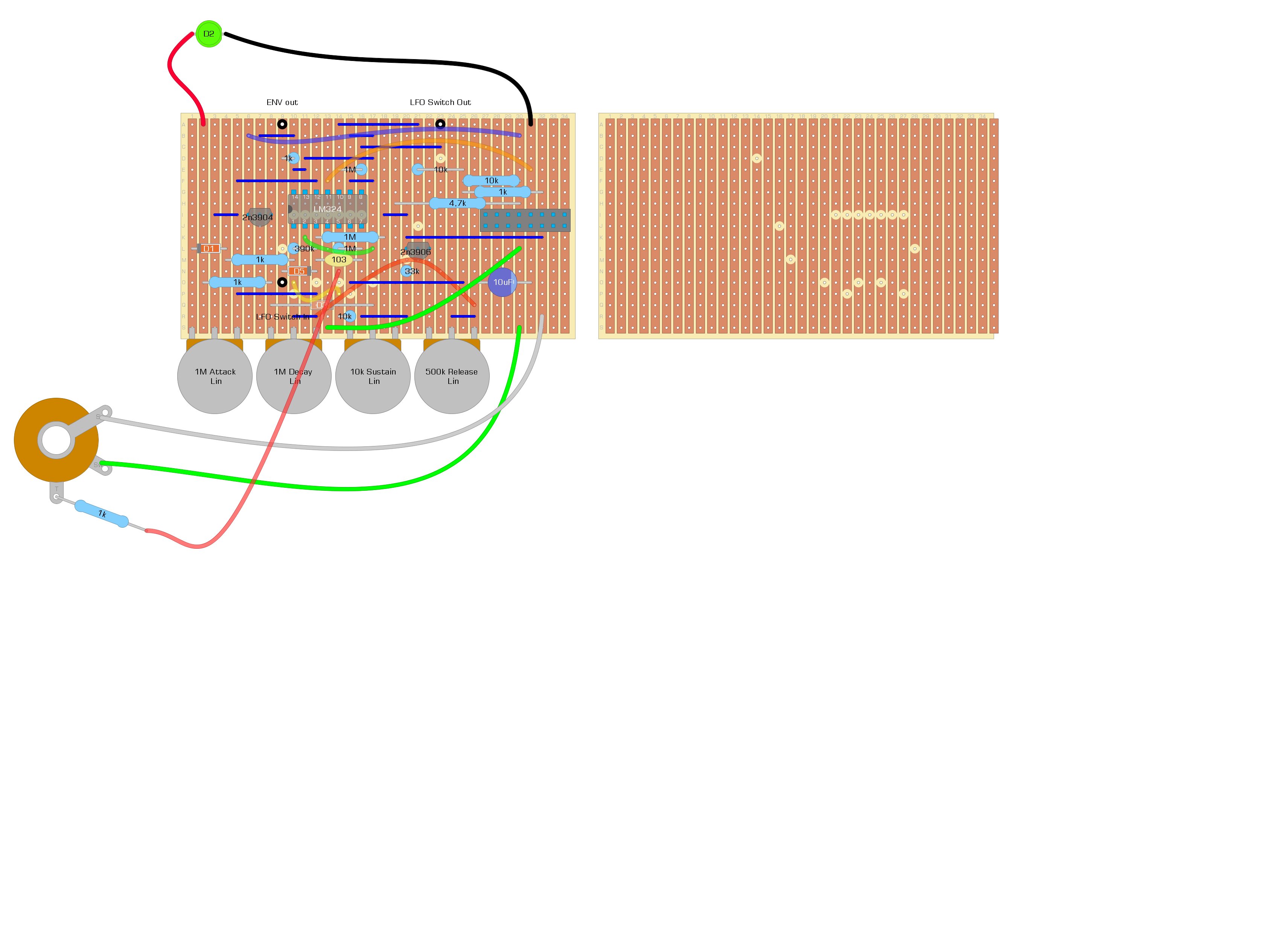

PostPosted: Sat Dec 12, 2020 4:49 pm    Post subject: Reply with quote  Mark this post and the followings unread
Hey, I just stripboarded Matthias' redrawn/ modified schematic of Nicolas' ADSR in theory (I already took a closer look at it but AI selling those made me finally decide to give it my own try) to build it for my newly reanimated eurorack tomorrow. I know it's intended for 15V but I also know in cases of non critical modules as EGs this won't matter that much. I did NOT include the extra caps for power stabilty but I think these can be left out if the PS is quite stable anyway, right? I have just built an active mixer which just works like a charm and without noise without any extra caps and stuff. Anyway: do you see anything that doesn't look right in my stripboard layout?
Thanks in advance! Nicolas designs are killer, btw.!

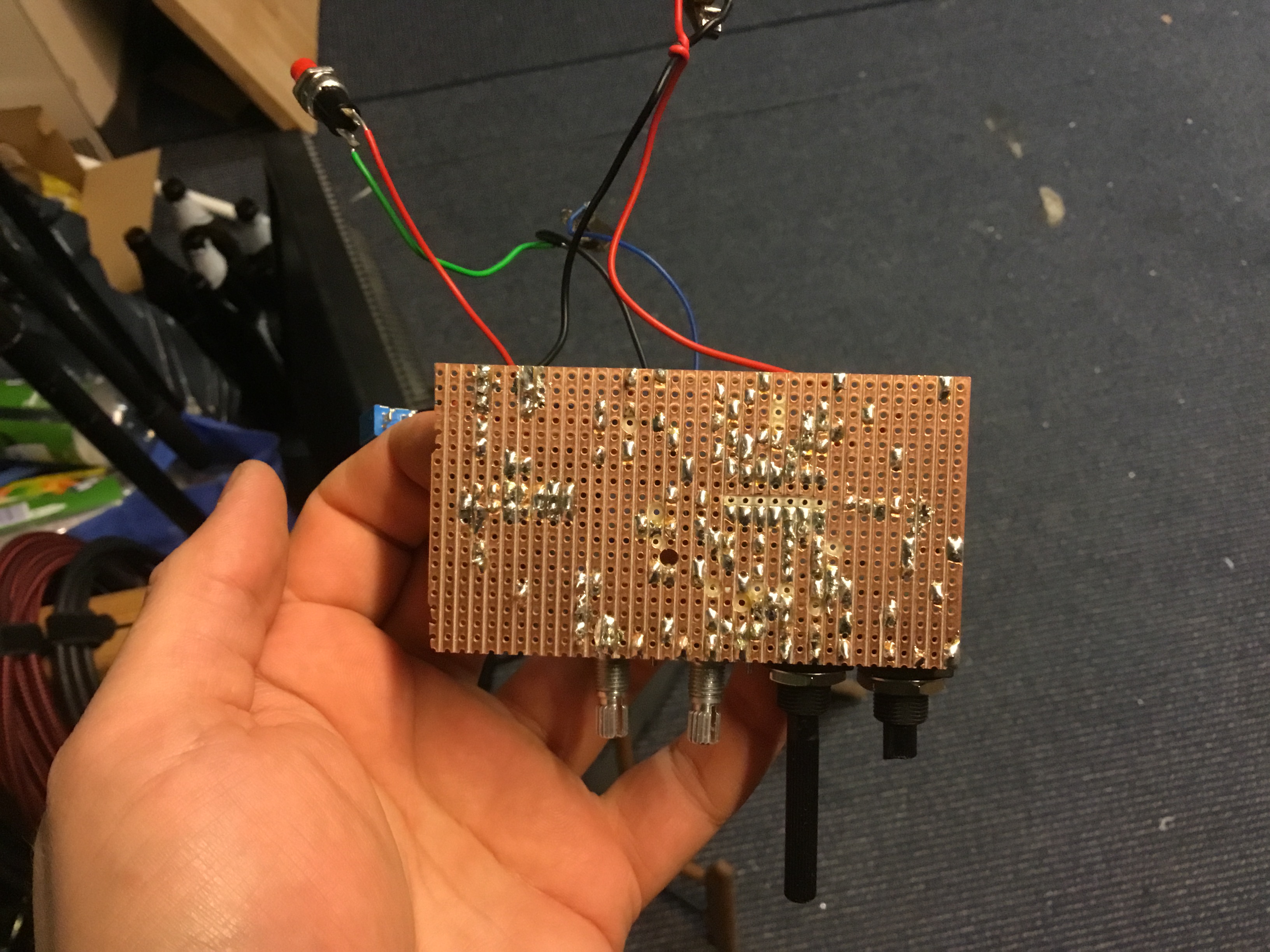

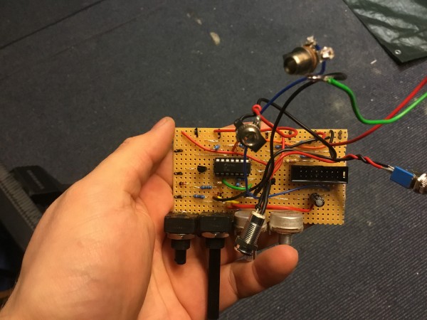

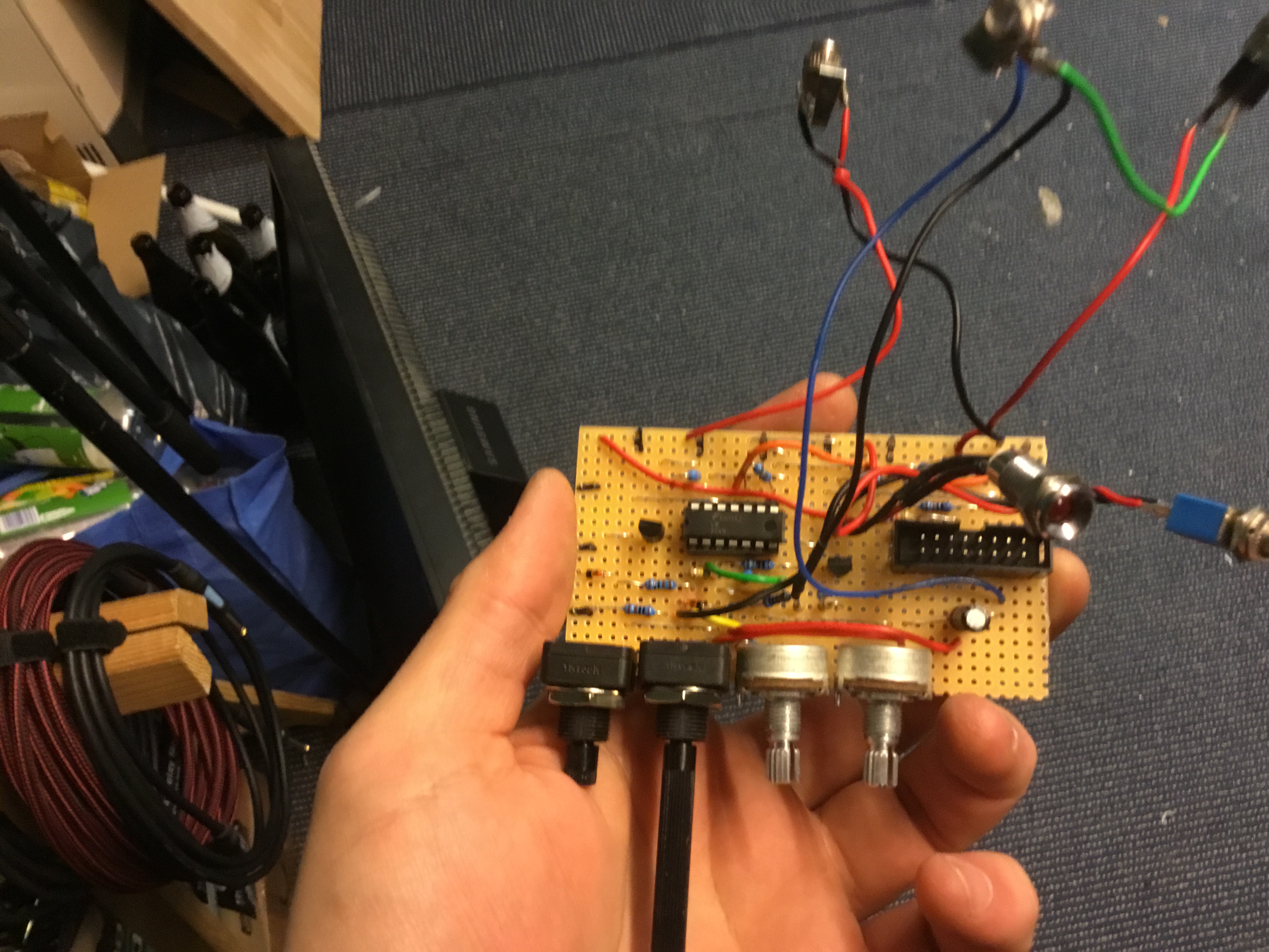

PostPosted: Sun Dec 13, 2020 7:13 pm    Post subject: Reply with quote  Mark this post and the followings unread
Okay, so i have built the module today and kinda got it to work but not really. Here‘s a link to a small video showing ho oddly it behaves.
https://youtu.be/h1jJYLKFV8A
The knobs from left to right are ADSR. When Attack is fully ccw the LED lights up constantly, the more it is turned cw the less bright it gets. Attack kind of works but Decay doesn‘t seem to change anything so does Sustain do - no changes. Release kind of acts normal as well but overall the behaviour is pretty strange:
The overall amplitude of the signal is far too small - I haven‘t measured voltages but the change in parameters e.g. cutoff of a Doepfer a-121-2 or the pitch of the Doepfer VCO is way to small. As mentioned, the LED behaves strange as well - it seems to be dependant on the Attack parameter.
Another things that’s strange is that it doesn‘t seem to go to zero and that the LED is constantly lit even when theres no gate present nor the LFO switch activated.
The LFO switch doesn‘t work properly as well. In the video everything is triggered with a simple manual gate.
The Module runs on 0-12V, -12 is not connected (as in the schematic). The schematic by Matthias is intended for +-15V but I supposed this wouldn‘t matter at all. Maybe it does?
Below are some pictures of the build attached, maybe it helps. Thanks everybody! I have grown mature enough to finally invest enough patience and time into SDIY so that I‘m looking forward to actively participating in the forums from now on in contrast to lurking around for more than a decade and not really contributing anything to the community, btw....

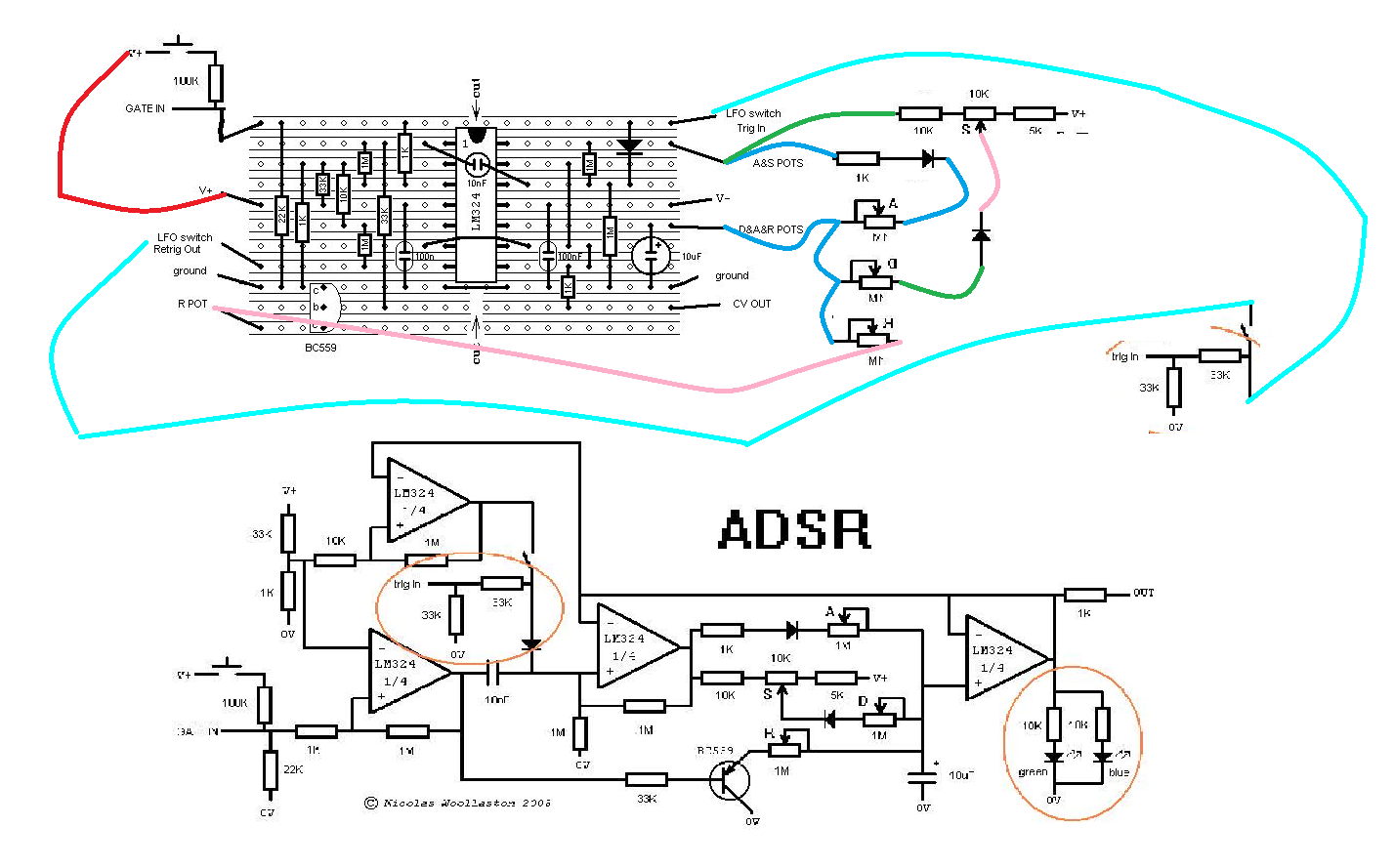

PERFORMANCE
Joined: Jun 11, 2020
Posts: 36
PostPosted: Sun Dec 13, 2020 9:25 pm    Post subject: Reply with quote  Mark this post and the followings unread
Okay, sorry for the spam - it didn't stop bothering me...from fonik's redrawn schem I assumed the negative pin of the LM324N would need to be connected to GND/0V but comparing it to Nicola's original design I suspect one of my mistakes was not to connect it to -V but to GND instead, right? I will give it another try later on and post my results....
Cheers!
UPDATE: soldering negative power of the LM324 to -V instead of ground significantly improved the overall performance. Nevertheless the behaviour is not as I would expect from an ADSR. Has anybody had success transfering the values to eurorack-level? I will try to change some resistor values and see if there‘s a difference this week...but some other projects hve also arrived from the UK soooooo they probably will come first.
Cheers!
Update 2: HEEEEEEEEEEEEEELP, 12V anyone? cry
PERFORMANCE
Posts: 36
PostPosted: Sun Aug 01, 2021 12:26 pm    Post subject: Reply with quote  Mark this post and the followings unread
hobbyseason wrote:
PERFORMANCE did u end up getting this working with + / - 12v?
ive been toying with this circuit for a few days, trying to get it to work with 12v.
i feel like im close but its not quite there.
my symptoms may be sort of similar to you experience?
the lfo / trigger switch does not work at all :S
most of the pots work as they should, however if i turn the release pot up over about 30% the gate is always open.
i did find an interesting way to modify the attack time by putting the 10uf on a switch with some other cap values (as low as 100nf and as high as 100uf for SUPER slow attack)
Cheers!
Hey! Nah, I haven't made any progress on this one yet but I'm still eager to solve it. I've recently built a bench supply with breadboard connectivity and might give this a spin on breadboard in the near future. Will keep all of you updated! Meanwhile I did have success on René Schmitz' "Fastest Envelope in the West" which I've built two of - cool!
