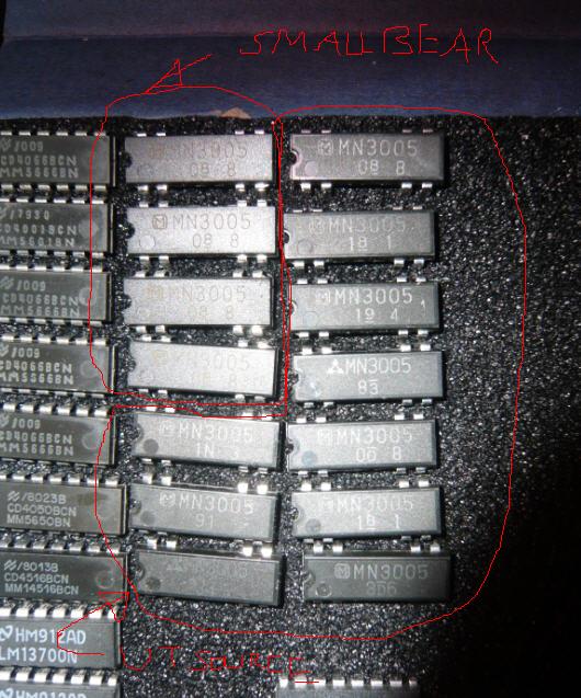

oscilloclast wrote:
So I got 4 dead MN3005 chips from utsource and I started gathering info (pictures and specs) on the chip to see if I could get an idea of what was going on. The spec sheet and all of the pictures I could find of the chip (from the internet and the utsource site) show a circular indentation (dot) on the top of the chip (this is not the orientation notch) but the chips they sent me do not have this dot. This made me think that the chips I got were fakes and I told utsource this. They wrote back and said that their supplier said they did not have the dot because my "date codes" were different. Did anyone receive working MN3005 chips from utsource that do not have the dot on top? The whole thing just sounds kindof fishy. I'm currently in conversation with utsource to get the chips replaced.
Thanks,
David
I think I was the first to recommend UTSource and I apologize for that recommendation if in fact they are sending fake chips. The four I got had the indent David refers to and they worked in my Blacet TimeMachine. I've purchased from them before and have not had trouble. The one time I got a bad chip they were responsive and took care of it.
Sorry guys.
I just (well, really a couple of weeks ago for a different project) bought another one from them, and if it is different, I'll post here first.
Edit: I also am going to try to order some from http://www.aeri.com/index.asp, the people who posted the article on counterfeit chips. As soon as they return my RFQ, I'll buy a couple and post the results.
dingebre@3dphysics.net
oscilloclast
Joined: Sep 29, 2005
Posts: 49
Location: VA
PostPosted: Thu Dec 31, 2009 1:22 pm    Post subject:
Subject description: MN3005s
Thanks for the reply David. Thats good to know that your MN3005s had the circular indent and that they worked. I don't believe that utsource deliberately sold me the counterfeits, I think they just were not paying attention. They have offered to refund my money (or send me new chips). And beyond the counterfeit chips (which according to the article can happen to any retailer) they seem like they are easy to deal with. Keep us informed how the other source for the 3005s works out.
Thanks,
David

I did take time today to test my ic's i got from utsource and smallbear,
i did buy 4 from smallbear and 13 from UTsource and they all work.

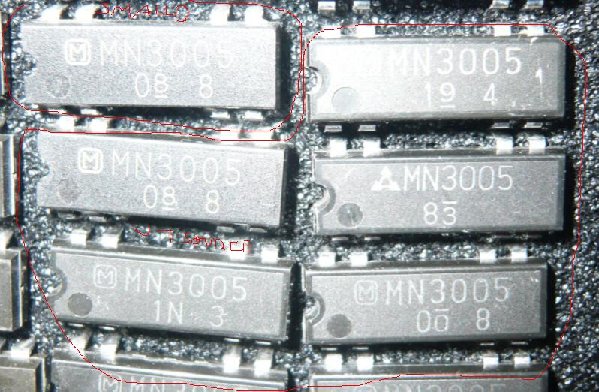

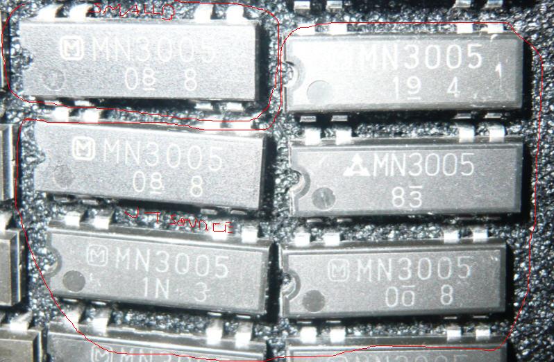

TekniK
Joined: Aug 10, 2008
Posts: 1059
PostPosted: Sat Jan 02, 2010 3:19 am    Post subject: Reply with quote  Mark this post and the followings unread
oscilloclast wrote:
Could you do me a favor and tell me if your MN3005 chips have a circular indent (dot) on the top (not the orientation notch)?
Thanks
David
 Filesize:  76.9 KB
 Viewed:  415 Time(s)
 Filesize:  89.77 KB
 Viewed:  414 Time(s)
oscilloclast
Posts: 49
Location: VA
PostPosted: Sat Jan 02, 2010 8:45 pm    Post subject:
Thanks for the pictures! Your pictures and every single picture I can find on the net (of real ICs) and the IC spec sheet clearly show the circular indent. My chips don't have the indent so I'll have to see if utsource can send me some non-counterfeit chips.
Thanks,

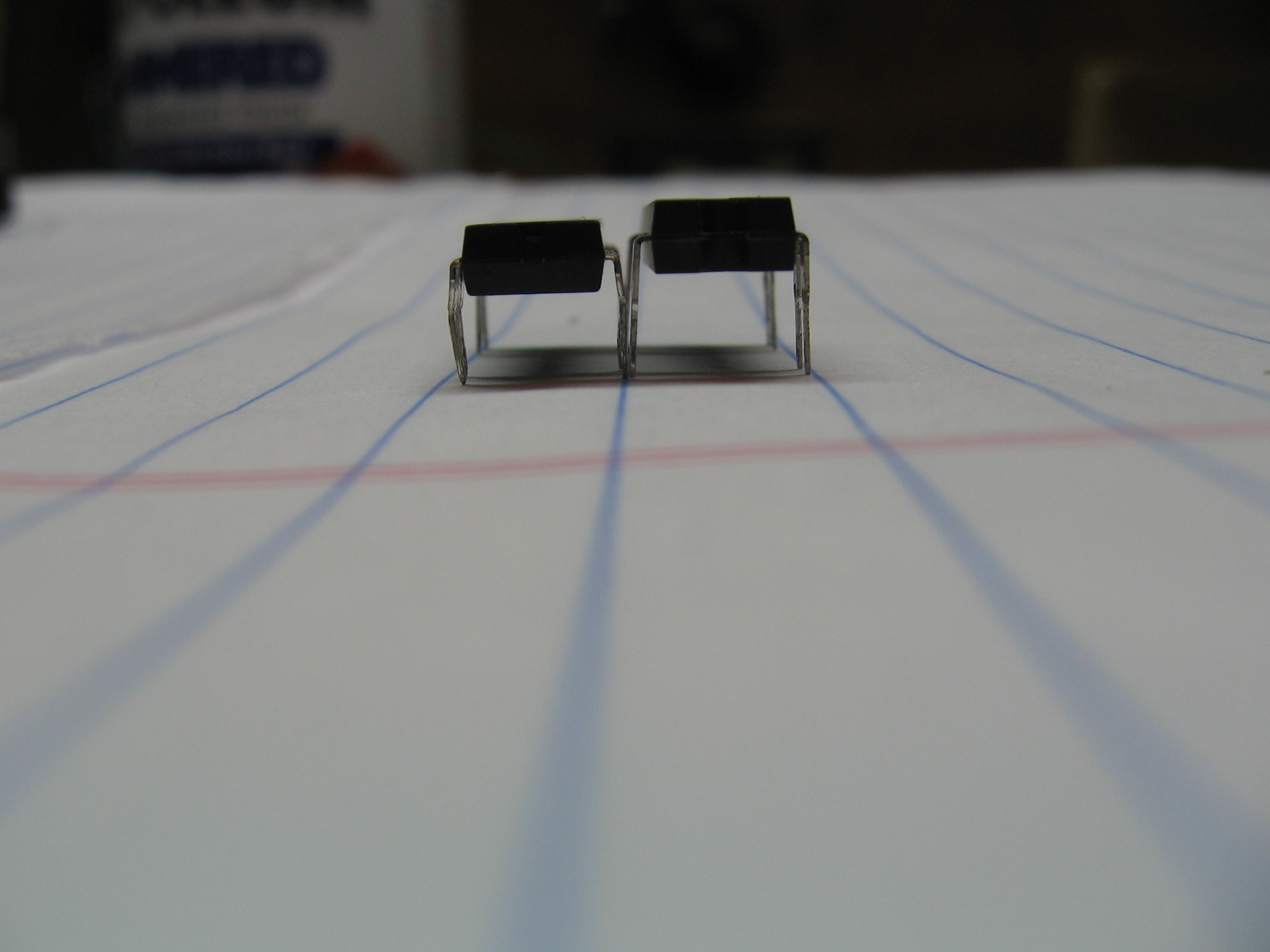

Within the last few days I've received a couple of MN3005 chips from utsource.
They do not work - they are either dead/defective or fake (tested in my Blacet Time Delay).
They do not have the circular indent on the top which David has mentioned.
They do have a circular indent on the underside which has a different number stamp for each chip.
I've pointed out the problem to utsource and have had a prompt acknowledgement for them asking for clarification of the problem and the "reason" (I cant't tell them anything more than the chips do not work when because they are either dead or fake).
Hopefully, they'll resolve this satisfactorily. I'll keep you posted.

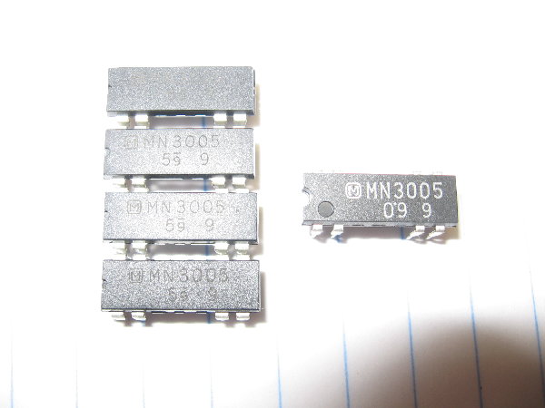

oscilloclast
Posts: 49
Location: VA
PostPosted: Sun Jan 03, 2010 7:31 pm    Post subject: MN3005 IC Reply with quote  Mark this post and the followings unread
The 4 chips on the left are the "counterfeits" that I received from utsource. The chip on the right is a real MN3005 (from my Doepfer delay). As can be seen in the photo the "counterfeit" chips on the left have very weakly printed text and no circular indentation on the top (which the real chip on the right has). I have not tried to see if solvent will wash away the text because I don't want utsource saying I damaged the chips. The chips also have different length legs (the real chip has longer legs).
David
 Filesize:  769.35 KB
 Viewed:  933 Time(s)
oscilloclast
Posts: 49
Location: VA
PostPosted: Sun Jan 03, 2010 7:36 pm    Post subject: Reply with quote  Mark this post and the followings unread
The MN3005 on the right (the taller one) is the one that works, the chip on the left is most likely a counterfeit.
David
 Filesize:  990.83 KB
 Viewed:  361 Time(s)
