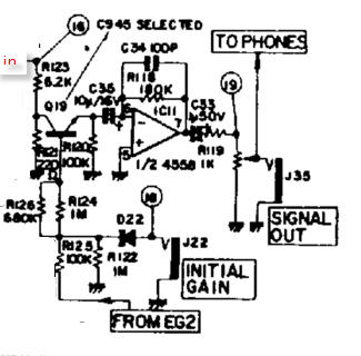

PostPosted: Thu Mar 26, 2009 3:10 pm    Post subject: Reply with quote  Mark this post and the followings unread
I've been playing around with the VCA from Roland's DR-110 percussion unit. It seems very promising. Basically a transistor, diode and a couple of resistors. R2 is 33k. For a.c. coupled input R1 is typically 1Meg. For a d.c. signal, such as from a cmos output, R1 is instead a 100k in series with the base. Envelopes are around +5V.

PostPosted: Thu Mar 26, 2009 3:21 pm    Post subject: Reply with quote  Mark this post and the followings unread
Excellent! Thankee for posting that Richard! I'll be testing it out in my Lunetta machine!! Very Happy If it works well, I'll be building a bunch of them. (Not that I'm THAT concerned with audio quality in that machine, mind you. Wink )

PostPosted: Sun Mar 29, 2009 7:02 am    Post subject: Reply with quote  Mark this post and the followings unread
Yes, but I've seen the same basic idea used with other op amps. The scrap below, using a TLO72, is from the TR909 clone rim shot. I've also seen an LM324 used.

hey gonna just bring this thread back up, because I want to discuss reasons for vca designs.
im trying to build a stackable (CV can control more that one channel) vc-mixer with the most minimal but most readily low cost available parts (ssm parts would be amazing if they weren't so rare)
I want to know what are the reasons for using a transconductance op-amp or other desgin over just a simple transistor/op-amp vca design?
im guessing its because of
lower input impedance?
is there less of a linear response or the response is less manipulative?
lower dynamic range?
more susceptible to offset and therefore distortion?
are these assumption correct or relevant?

PostPosted: Fri Jul 31, 2009 5:44 am    Post subject: Reply with quote  Mark this post and the followings unread
I don't know about your assumptions, but my assumption is that one advantage of using an OTA is that it can be D.C. coupled. With no capacitor in the signal path it can operate with lower losses at low frequencies, down to slow-moving envelopes and LFO ranges. At higher audio frequencies there would be none of the phasing effects of capacitor coupling -- unless that would be what you wanted.
All the simpler designs discussed above generally need a capacitor somewhere in the signal path, at input, output or both, like the MS-20 or the WP-20.
I'm sure someone here can correct my simplistic reasoning.

PostPosted: Fri Jul 31, 2009 7:49 am    Post subject: Reply with quote  Mark this post and the followings unread
One reason for using an OTA type VCA over a single transistor is that with the single transistor VCA, the output's voltage will always be on one side of zero volts, either above or below depending on the circuit. You can see this with the drawing above that shows input and output waveforms.
An OTA will give an output that looks like the envelope is copied on both sides of zero volts.
The main effect of this is that the control voltage will feed through to the output with the single transistor VCA and will not feed through to the output with the OTA VCA.
The feed through is usually something undesired. Your milage may vary.
