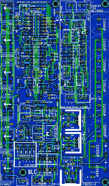

Some Mac users are not able to see the layout file. I made a 600dpi picture of the silkscreen incase you can't see the small lettering

PostPosted: Sun Jan 10, 2010 9:20 am    Post subject: Reply with quote  Mark this post and the followings unread
I'm about to finish up my LFO but there are a couple of caps that I can't find the value for. The ones marked with red.
haxster
Joined: Feb 01, 2006
Posts: 246
PostPosted: Sun Jan 10, 2010 4:28 pm    Post subject: Reply with quote  Mark this post and the followings unread
The one at the bottom is 0.1uf, that is for the GLIDE/portamento
The two Cap pairs are for the Analog LFO's. Pair them with values like this: 0.0047uf, 0.01uf. You are free to experient with values. The higher the cap the slower the LFO. For example 2UF NP will make it go really slow.
A good combo is like this: 0.00xx uF, 0.0x uF.
The Last one circled in red is an LED not a cap.

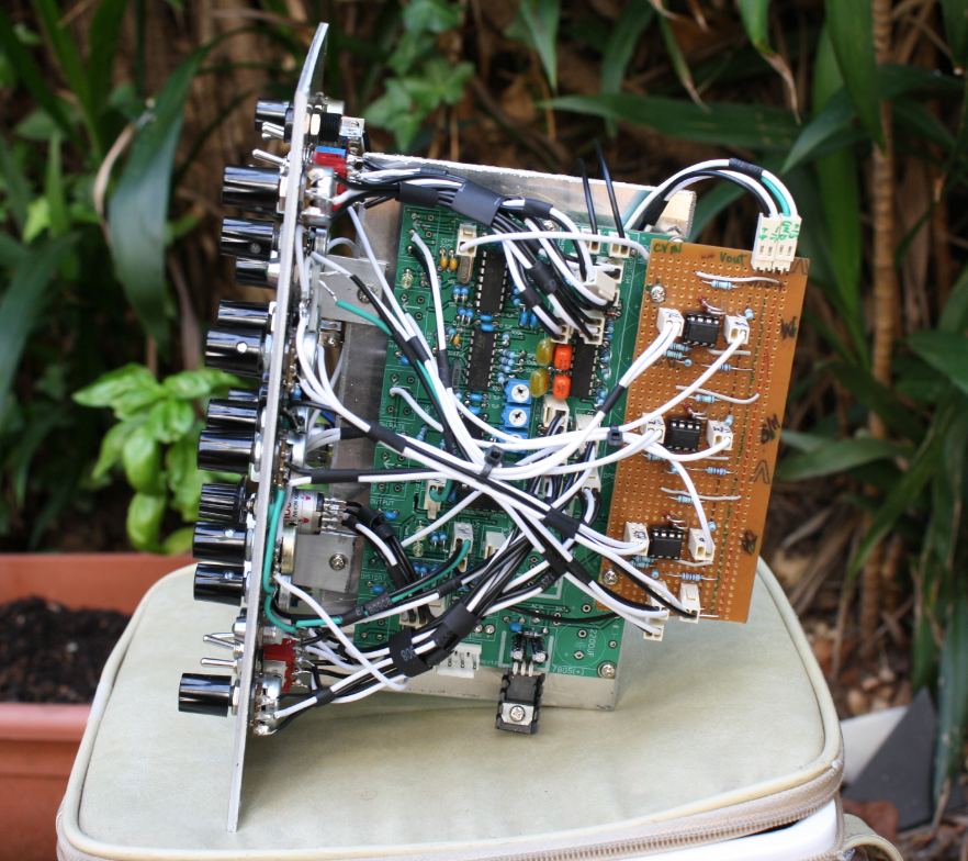

PostPosted: Mon May 10, 2010 5:42 am    Post subject: Reply with quote  Mark this post and the followings unread
so has anyone built their lfos?
i have finally got mine completed
the squarewave on the analog lfo was running rail to rail (30vpp)
i used a simple voltage divider (49k9/27k) to get it down to 10vpp
i also implemented vc-sample'n'hold, vc-waveform selection, vc-phase distortion
took a lot of work to get it going but it was worth it
im doing the 2nd one now

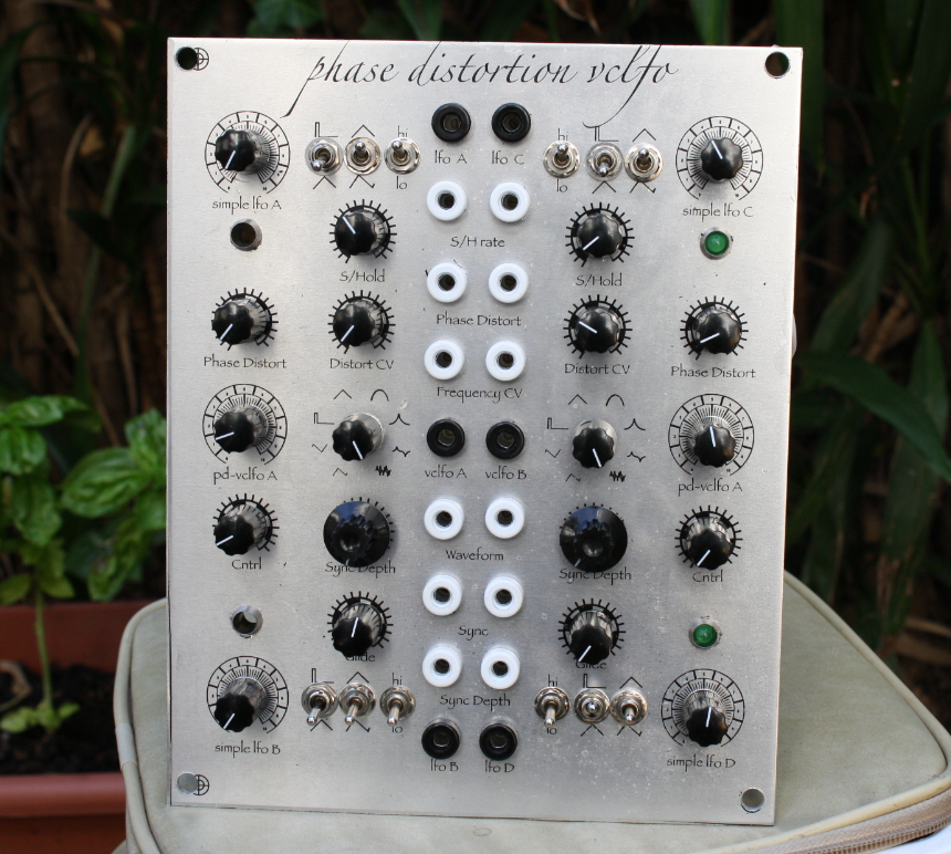

here is the panel
and the mess
