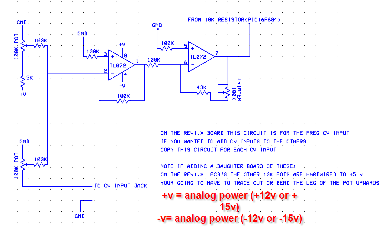

Hi,would like to ask u,if there is an onboard protected external CV input for waveform selection and distortion on top of the '5v pot CV's inputs'
cheers
haxster
Joined: Feb 01, 2006
Posts: 246
PostPosted: Mon Jun 01, 2009 5:01 pm    Post subject: Reply with quote  Mark this post and the followings unread
Looks like you have been studying the possibilities on the 0-5v inputs on the pic pins. I am way ahead of you and thought about that yesterday too. I came up with this layout and basically copied what i did with the Freq CV input. I don't know if I will make this board, I just got it out of the way for now. PM if you want the zip to have it made like right now. The difference is I chucked the Analog LFO's and laid out all the possible CV inputs for LEVEL, SH rate, and DISTORTION,
As far as CV input protection, it is going from jack to 100k, then to a TL072 ic (-) side of the op-amp, standard basic stuff. There is no ~10v Zener Diode or anything like that. i don't recommend just doing a hack directly onto the pins of the Pic with just an input jack, if your gonna add the cv capabilities jumper onto another protoboard with those TL072 buffers like on the PDF. Digital chips get easily damaged if you input more then 5v. The circuit was originally designed for 15v usage so there should not be a problem.

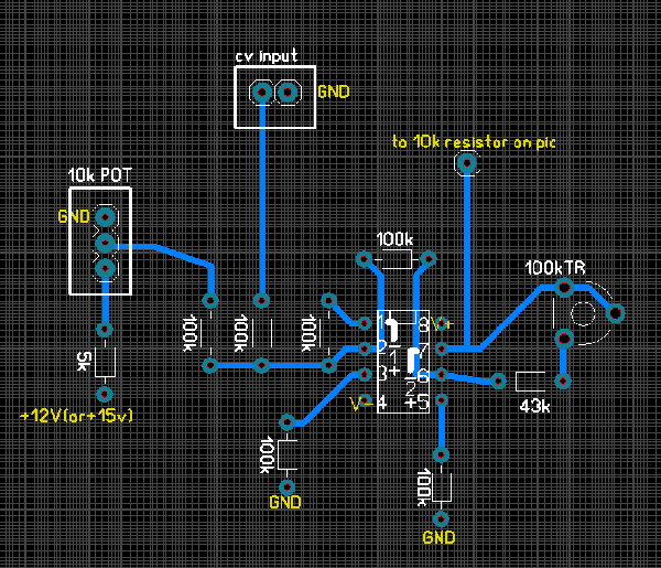

Well with the PCB layout i just posted above you could sacrifice for example the "Level CV" and criss cross that resistor that was supposed to lay straight flat and have it go to one of those CV circuits instead.
I will post the cv circuit alone, first the protoboard style picture, then later a schematic.

PostPosted: Tue Jun 02, 2009 8:05 am    Post subject: Reply with quote  Mark this post and the followings unread
Here is the CV input circuit, the control knob for that input you decide to midify goes to a 5k resistor then to Main Analog positive voltage instead of 5v. I just noticed on the PCB i posted above(not the 2nd run/don't worry) i forgot to do that Embarassed . That's already fixed.

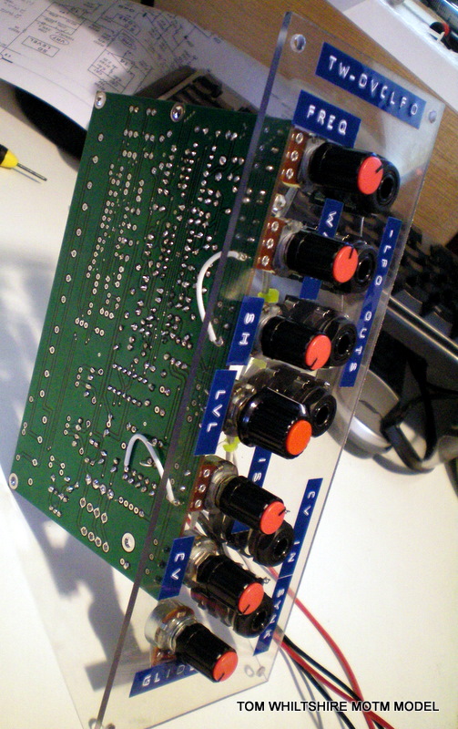

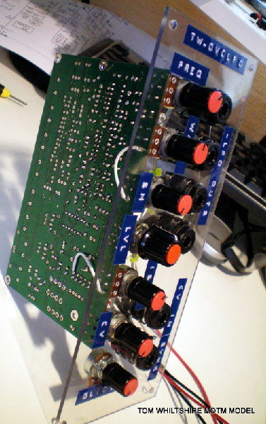

PostPosted: Sat Jun 20, 2009 10:32 am    Post subject: Reply with quote  Mark this post and the followings unread
I built a Motm style one yesterday populating the digital LFO only.
The pic shows Rev 1.1 with the 2 jumpers needed on the pots.
 Filesize:  184.86 KB
 Viewed:  191 Time(s)
 Filesize:  151.12 KB
 Viewed:  173 Time(s)
 Filesize:  198.45 KB
 Viewed:  200 Time(s)
