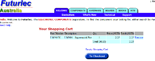

PostPosted: Mon Nov 09, 2009 3:20 pm    Post subject: Reply with quote  Mark this post and the followings unread
just to clear things up Laughing
futurlec.com.au has them in stock
tho anything you order from there comes from Thailand anyway
so???

Yep, the .au site just let me put one in the cart.
