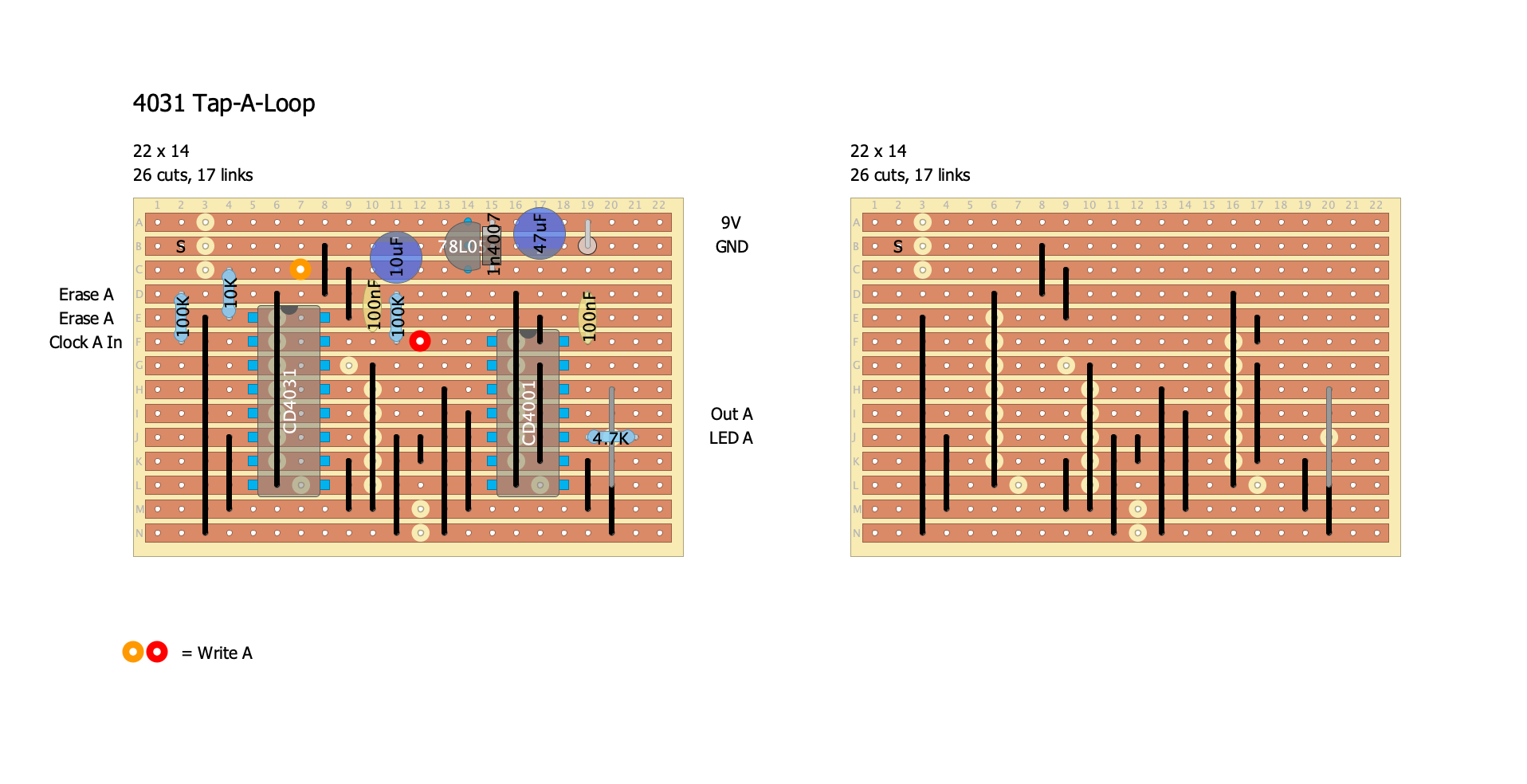

For what it's worth, I built 2 of the more complex versions and they work fine. I've attached my stripboard layout, in case it helps. You can ditch the voltage regulator and associated parts if you don't need them, and directly attach your voltage to the trace BELOW gnd. Also, beware on the right side than I have 2 jumpers sharing the same hole (not very elegant, but whatever).
4031 stripboard
 Filesize:  141.04 KB
 Viewed:  545 Time(s)

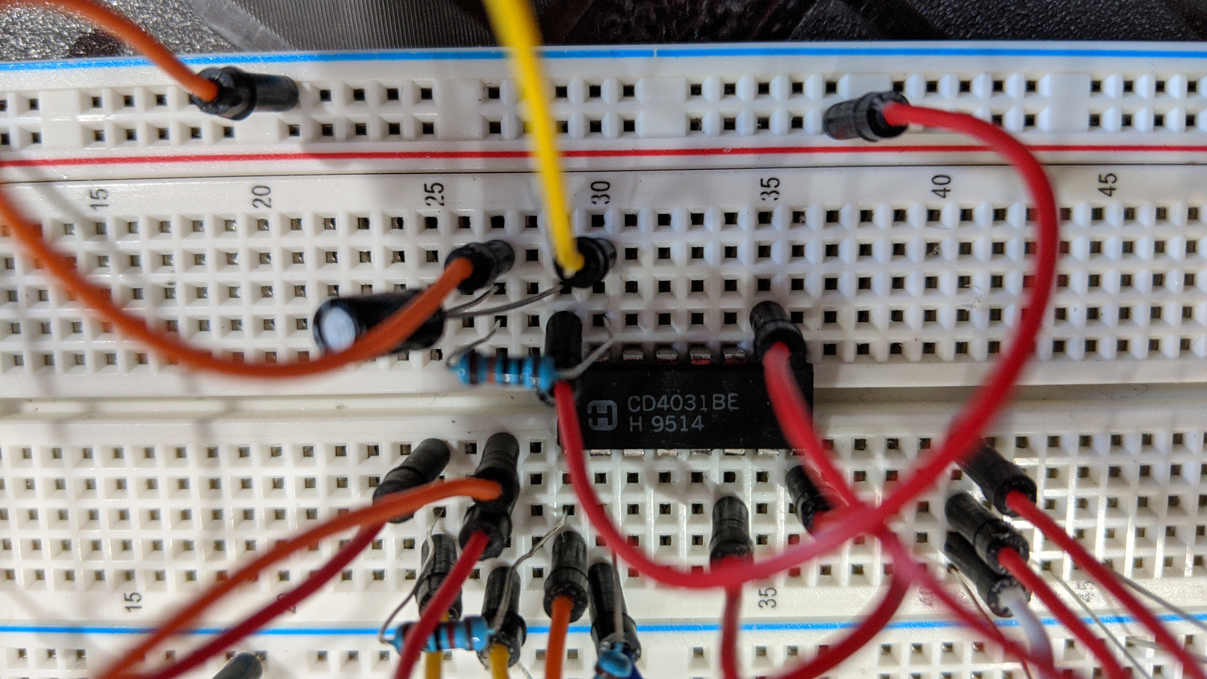

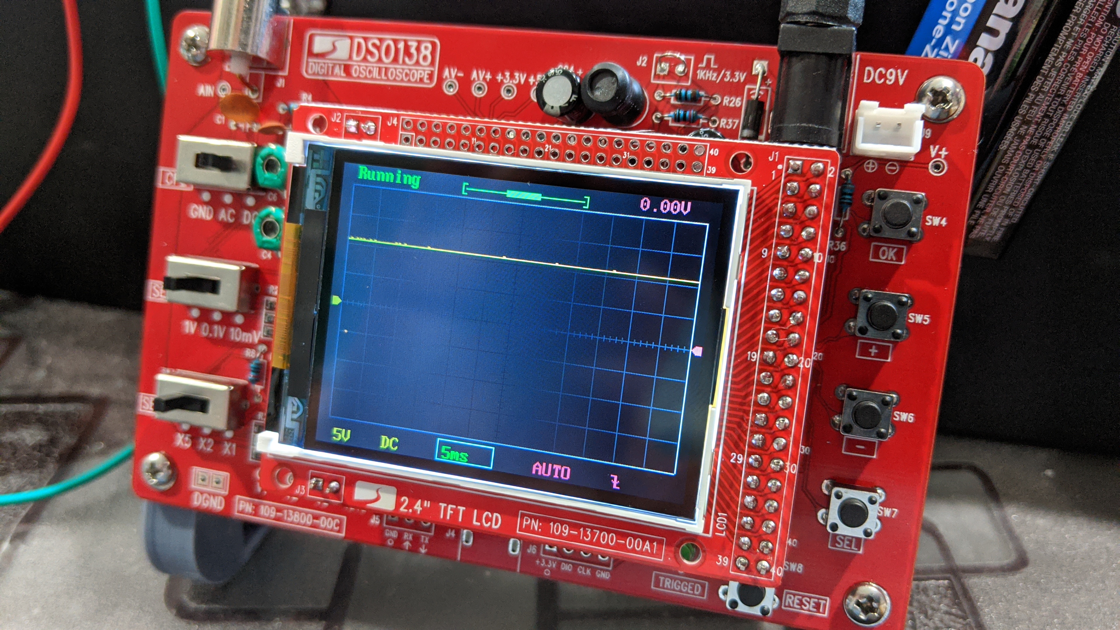

So, still no luck. The LED at the end doesn't light up, and the oscillator that is using the output as a gate doesn't activate. Using my scope on the output, it looks constantly high? Which is really weird.
 Filesize:  3.1 MB
 Viewed:  525 Time(s)
 Filesize:  2.54 MB
 Viewed:  485 Time(s)
dk
Joined: Feb 12, 2019
Posts: 115
Location: Europe
PostPosted: Wed Sep 16, 2020 7:27 am    Post subject: Reply with quote  Mark this post and the followings unread
Hard to tell from the pic, but it looks like you haven't grounded the chip? Pin 8 should go to ground, while pin6 should connect with pin 10 and your output..
EDIT: I was under the impression that between pins 6 and 8 there was a loop, but that's probably just the picture cutting it that way.

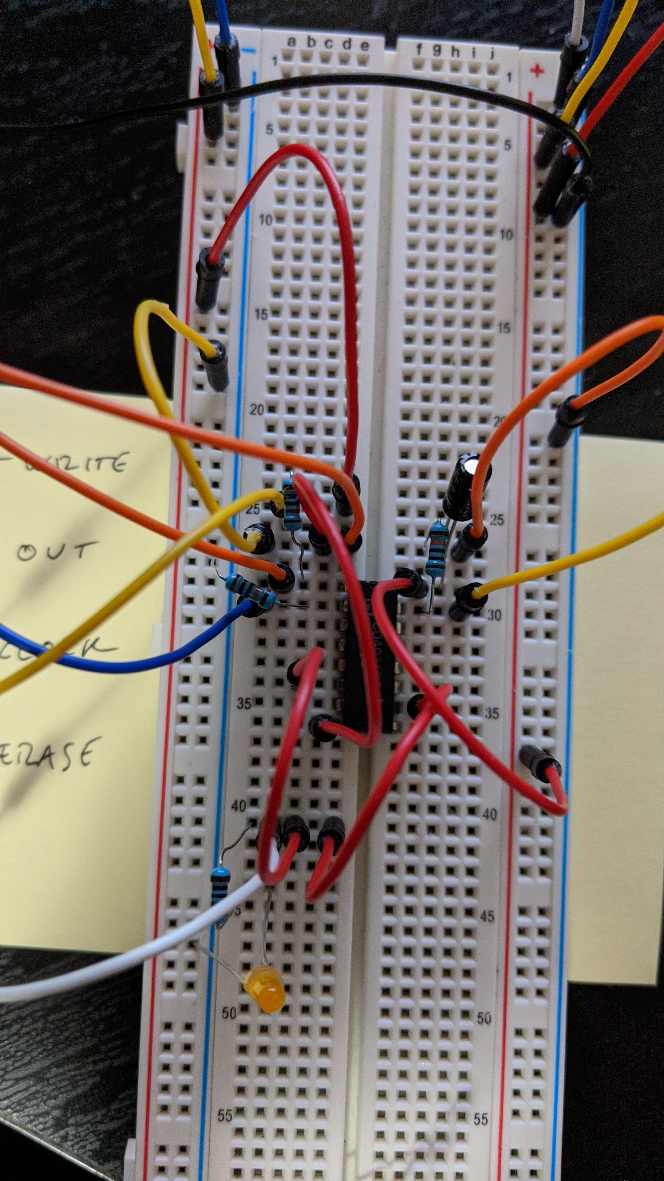

Sorry, that picture was mostly to identify the chip. Here's a better picture (pin 8 is grounded via row 27, and pin 10 to pin 6 via row 41).
 Filesize:  2.68 MB
 Viewed:  488 Time(s)

From what I can tell that looks ok.
You could try the bare minimum to see if the chip does anything at all:
pin1: GND
pin2: fast (KHz) oscillator input
pin3: NC
pin4: NC
pin5: NC
pin6: output
pin7: NC
pin8: GND
pin9: NC
pin10: GND
pin11: NC
pin12: NC
pin13: NC
pin14: NC
pin15: slow oscillator input
pin16: V+
If the CLK (2) frequency is fast enough the output (6) should pretty much follow the oscillator on the input (15).
Also move the chip to another part of the breadboard.

Good news: it works. Now to figure out what's wrong with the circuit. I even read through the datasheet and the CMOS cookbook to try and troubleshoot/test other configurations.

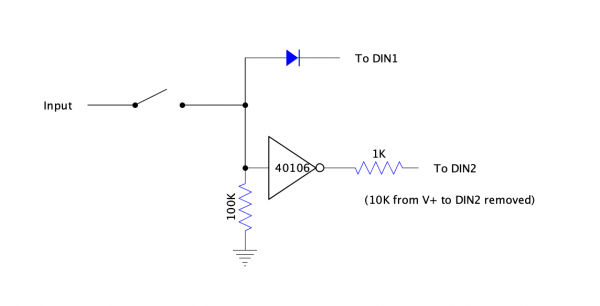

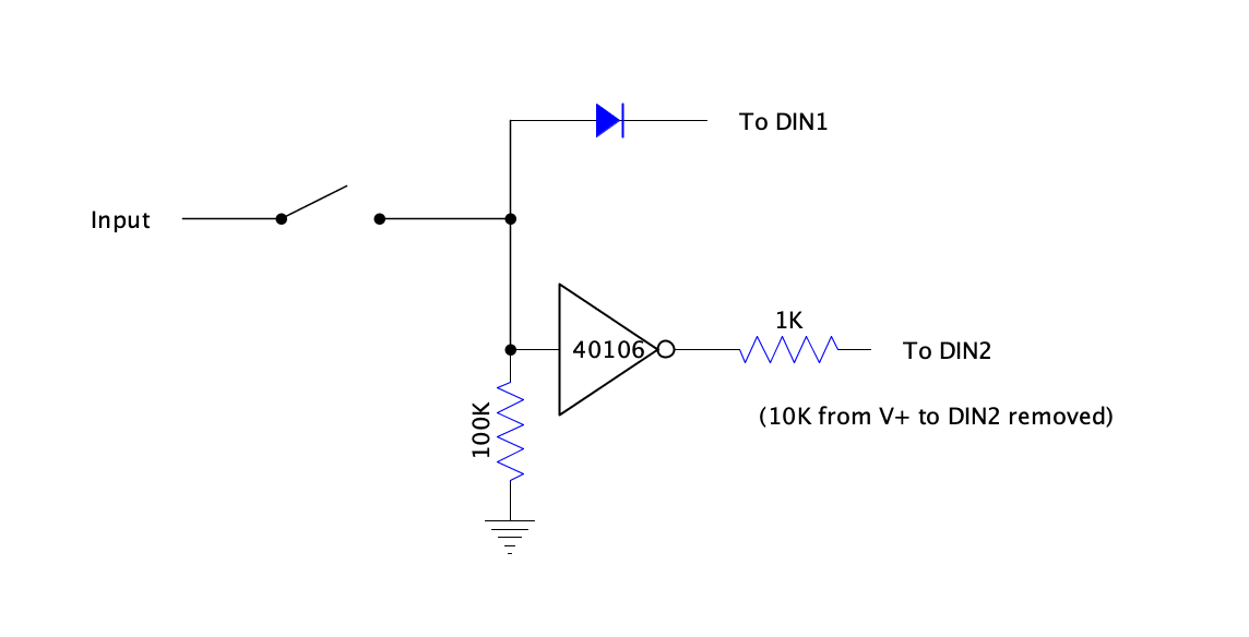

PostPosted: Wed Apr 14, 2021 6:55 am    Post subject: Reply with quote  Mark this post and the followings unread
I'm finally getting around to de-bouncing my switches and was thinking of adding a data input (since I'll have left over 40106's anyway).
Does anyone see anything wrong with this, before I tear into the module? ( besides not using a logic gate for the switch, of course Very Happy )
Edit: Sorry, I should have written that my build is PHOBoS' deluxe version.
 Filesize:  35.09 KB
 Viewed:  230 Time(s)

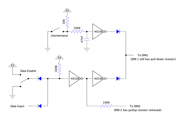

Posts: 115
Location: Europe

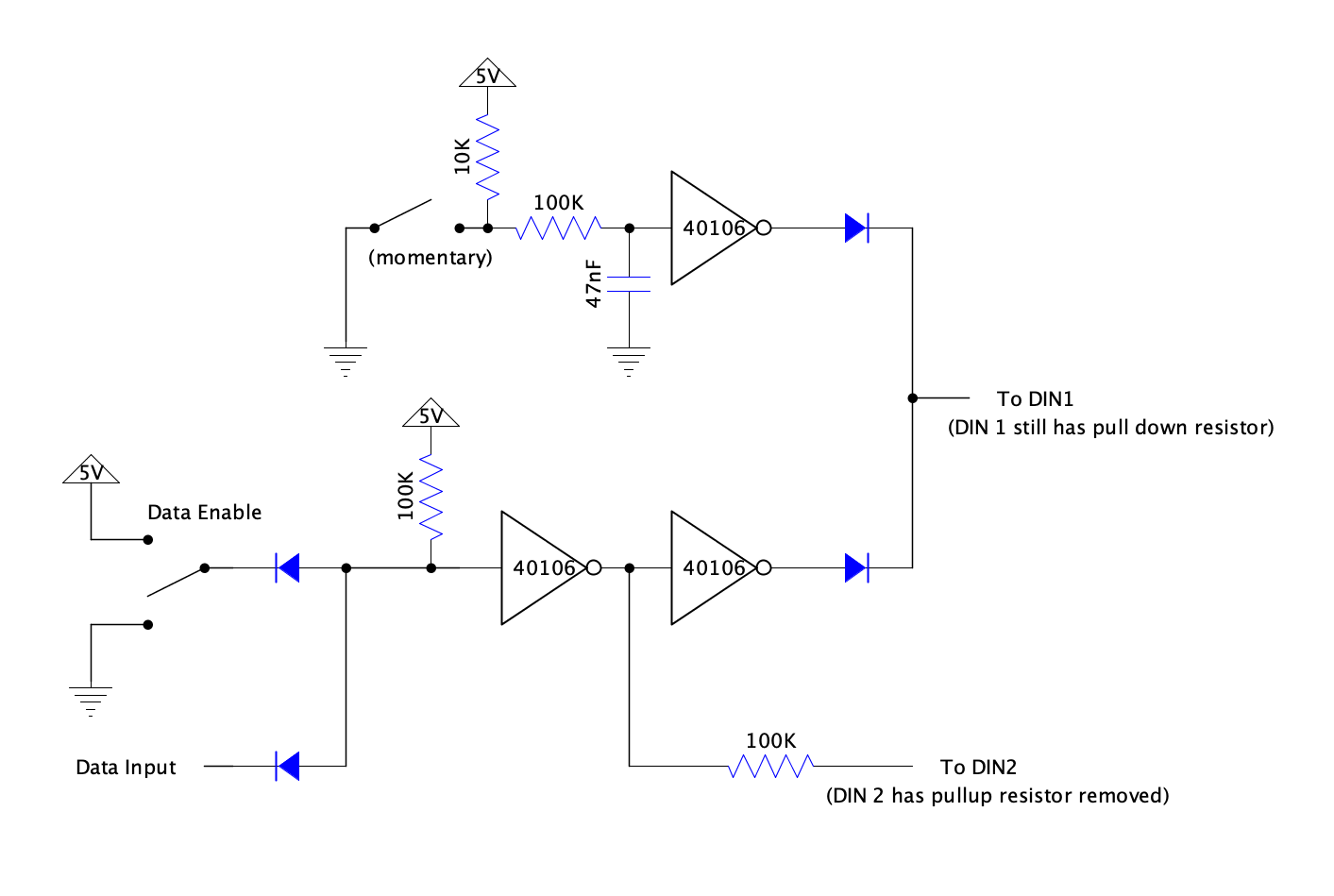

PostPosted: Thu May 20, 2021 5:30 am    Post subject: Reply with quote  Mark this post and the followings unread
Just an update to the previous post. I updated it so that the switch is AND gated with the data input and also added the switch debouncing circuit. I haven't breadboarded it yet, but theoretically it should work?
 Filesize:  80.24 KB
 Viewed:  231 Time(s)
Posts: 5907
PostPosted: Thu May 20, 2021 7:44 am    Post subject: Reply with quote  Mark this post and the followings unread
I'm not sure if that does what you want it to do. When the data enable switch is connected to GND, DIN1 is low and DIN2 is high,
which doesn't do anything so that would be ok I assume. Now if the data enable switch is connected to V+ (or not connected,
doesn't matter) and your data input is high then DIN1 is high and DIN2 is low. Which is the equivalent of pressing both the write
and erase button at the same time. I'll have to check the datasheet again to see what that does but I would think that you either
want to write a bit or erase a bit, not do both at the same time. If I ignore the CD4031 and just look at what would happen with
the output then U2c would be low, U2b would be high and as a result U2d and U2a would be low.

PostPosted: Thu May 20, 2021 2:01 pm    Post subject: Reply with quote  Mark this post and the followings unread
Oh, you're right!
The momentary at the top is just the write switch. I was hoping (with the now-obviously incorrect bottom section) to be able to enable and disable the data input without interfering with the buttons. Do you have any ideas how to accomplish this? My first thought was to use a switch (4066), but I was trying to skimp on using an extra chip .... or perhaps I need to?
