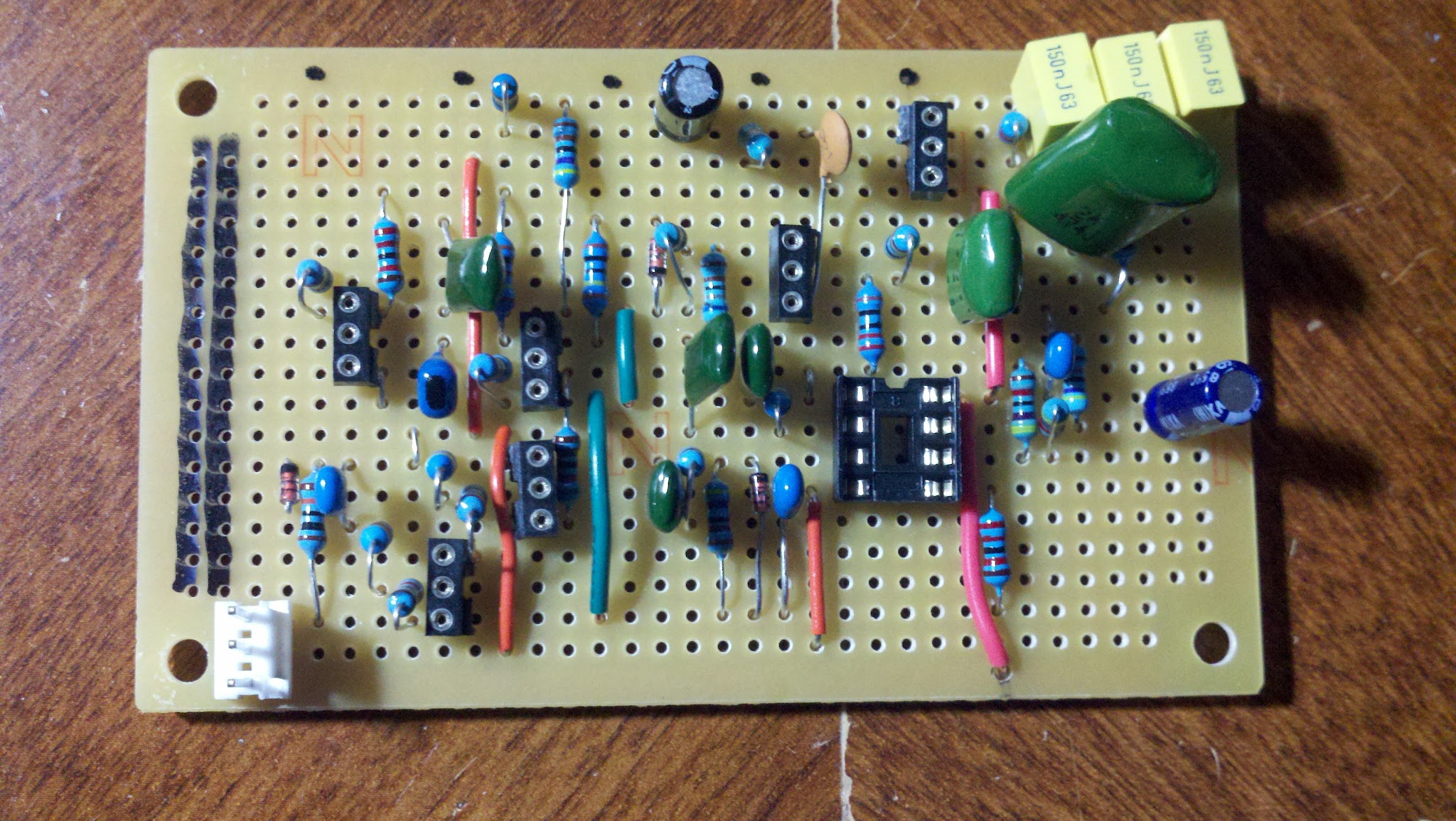

In other news, I built the kick from this other thread last night.
http://electro-music.com/forum/topic-37646.html
Thanks again to minus for making these layouts available.
You may notice weirdness in the upper right; I didn't realize before starting that I had no .47uF electrolytics. First approximation was to substitute a mylar cap. Then I found I needed another and had no more of that either. So I put 3 of those yellow box caps in parallel, and we shall see how it sounds once I get there. I also did sub mylar (or in a couple cases C0G ceramics) for the other polystyrenes, everything in the circuit was bigger than I have in my PS bin....which is entertaining since I just bought two kits to try and prevent that problem Smile.
I'm planning to just walk through the boards so far, and considering using an arduino or something to drive it all.

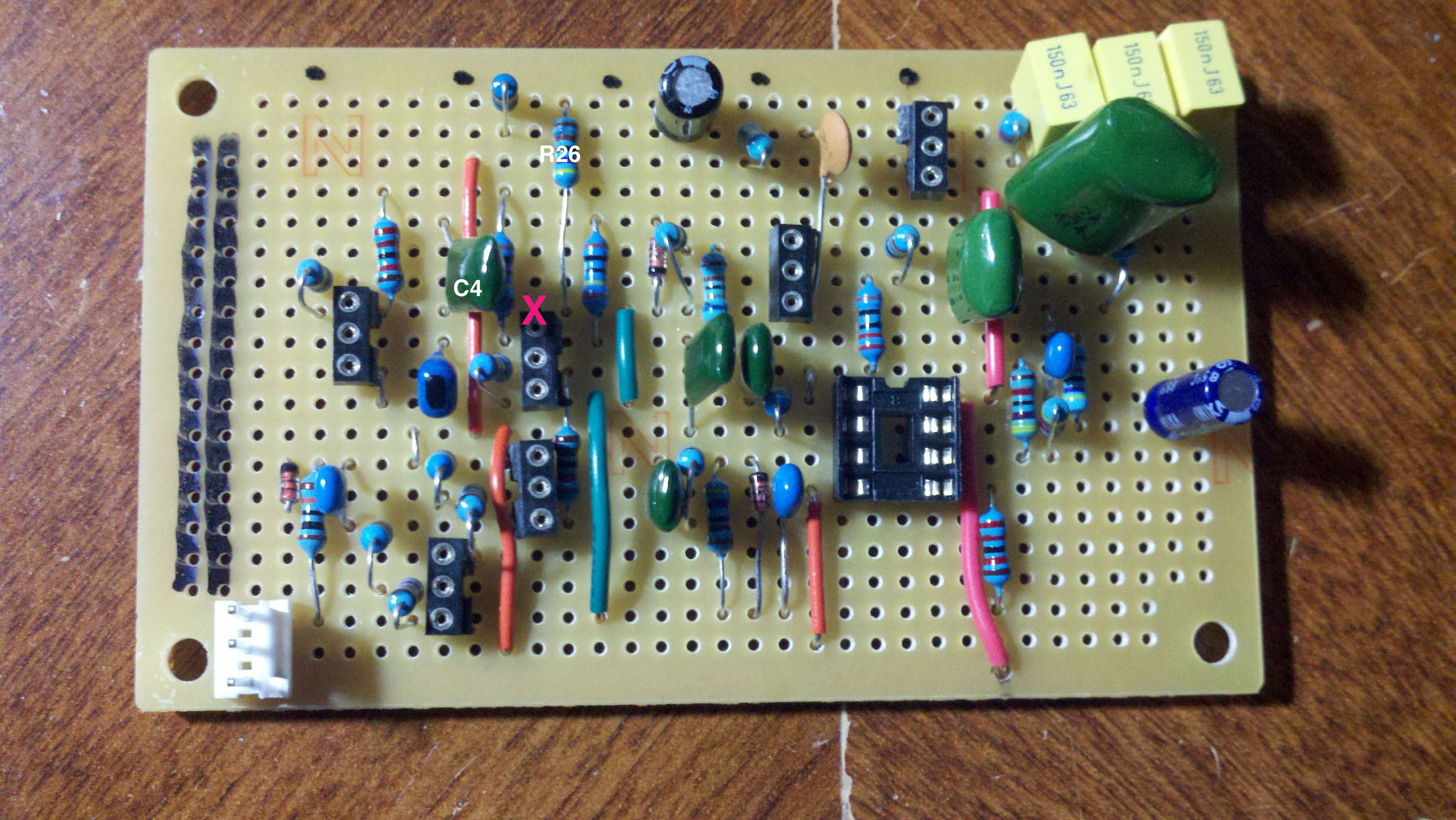

PostPosted: Fri Sep 07, 2012 5:34 pm    Post subject: Reply with quote  Mark this post and the followings unread
elmegil, the track apparently is where C4 and R26 are joining. You need to cut this. I've marked it with an X. I'm going to look at my old 808 BD board later on if I get time and see if I can get it working better. It never was quite right. Also, those caps might need to be bipolar/electrolytic. Not sure if that would be causing problems. Oh, and you could just temporarily tie the accent to the + to test the circuit without feeding anything into accent. You may already know this! I'm no expert myself. Laughing

PostPosted: Fri Sep 07, 2012 6:10 pm    Post subject: Reply with quote  Mark this post and the followings unread
I have always assumed that electrolytics were used because that was an easier way to get the larger capacitance, and their technology required them to be polarized. That's why I figured subbing other non-polarized caps of the same value ought to work.
Of course I could be way out in the weeds too Very Happy
I made the cut and I have no better response from the circuit; it was quick and easy to test. I've got the service manual, so I'll compare to the diagram while the cake bakes, assuming I don't get shanghaied into other stuff by my wife Smile

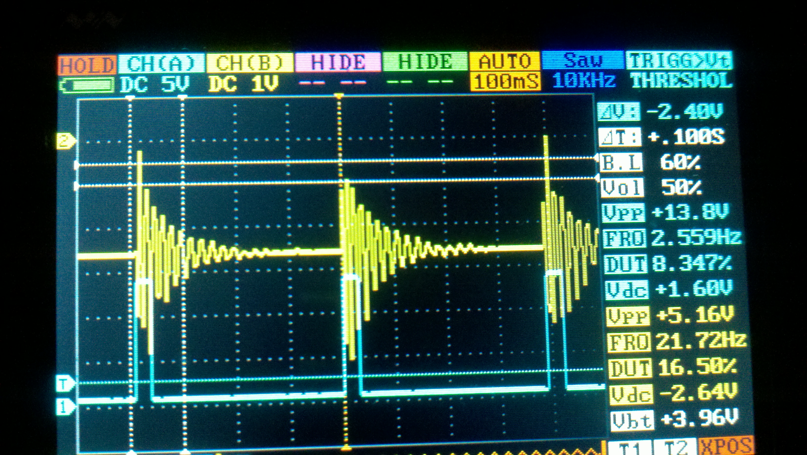

PostPosted: Fri Sep 07, 2012 8:19 pm    Post subject: Reply with quote  Mark this post and the followings unread
Cake is in the oven Smile
I am looking at it on my scope now, and either it's not going on both transitions, or else they are close enough together you can't really see it. It's a 25ms pulse...
I'm not getting the ringing you talk about minus...
-My output is nowhere near 5 V although I'm still using the originally specified output.- Never mind, I can't read my scope when I'm running from the kitchen to the office. It's 5Vpp
Using the second from the top track, I get the same amplitude, and the same behavior from the accent input. Time to go spend quality time with the circuit diagram Smile (Cake is out of oven now)
 Filesize:  2.18 MB
 Viewed:  653 Time(s)

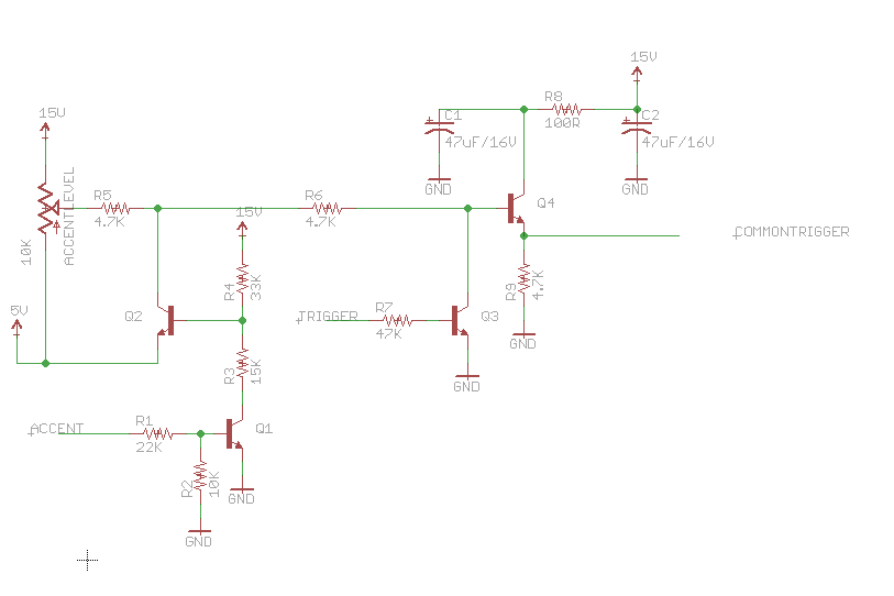

PostPosted: Fri Sep 07, 2012 8:56 pm    Post subject: Reply with quote  Mark this post and the followings unread
Ok, I'm looking at Eric's PDFs, specifically:
http://ericarcher.net/wp-content/uploads/2009/07/tr-808-bass-drum-diy-project.pdf
And... I don't see how the trigger could possibly do ANYTHING if there is no voltage in to the accent. There's nothing to drive those first two transistors!
The way the service manual shows it, the trigger goes into what we have marked as accent, and something labelled "BD" goes in to what we have labelled as trigger. Tracing it back, that's coming from the "BD" line of the microprocessor; I'm wondering if that isn't an enable/disable, since the block diagram shows BD and TRIG going into one of those circular X things (a technical term) which I usually see in Ring Modulators.
Additionally, if you trace that trigger back, it combines with the accent. So I think that what happens is that the trigger peak level is set with the accent, so a higher peak gives an accented beat? I'll draw up an eagle version of this subcircuit which will be easier to read than the original service manual.
PostPosted: Fri Sep 07, 2012 9:31 pm    Post subject: Reply with quote  Mark this post and the followings unread
Here's the schem, I don't grok it yet.

Setting up a voltage divider to drive the accent input, I lose all my bass thump with an accent voltage below about 9.5V. There is a distinct volume (and to some extent tone) difference between there and 15V. The whole drum-like flatting of the tune becomes less noticeable, which would make sense. My trigger pulse, as noted before, is 25ms and 15V.
