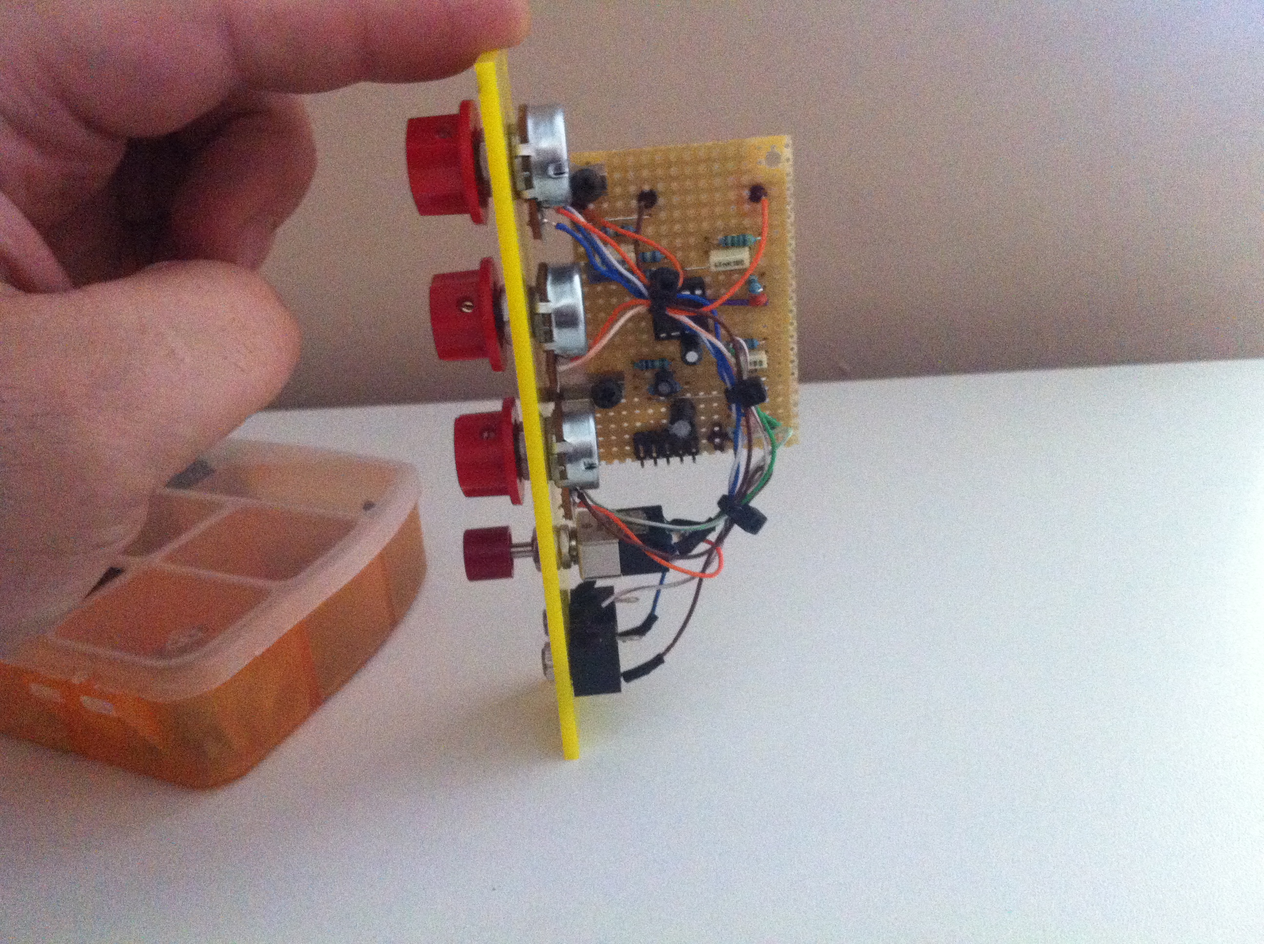

PostPosted: Mon Apr 18, 2016 9:16 am    Post subject: Reply with quote  Mark this post and the followings unread
so i built this and theres something wrong.
when i turn the distortion pot up and down it just turns the voume up and down, there is no distortion to be heard at all.
the signal is travelling stright through without effect. when the switch is switched it only allows the distortion pot to adjust volume.
ive re-flowed the whole board but nothing
any ideas?

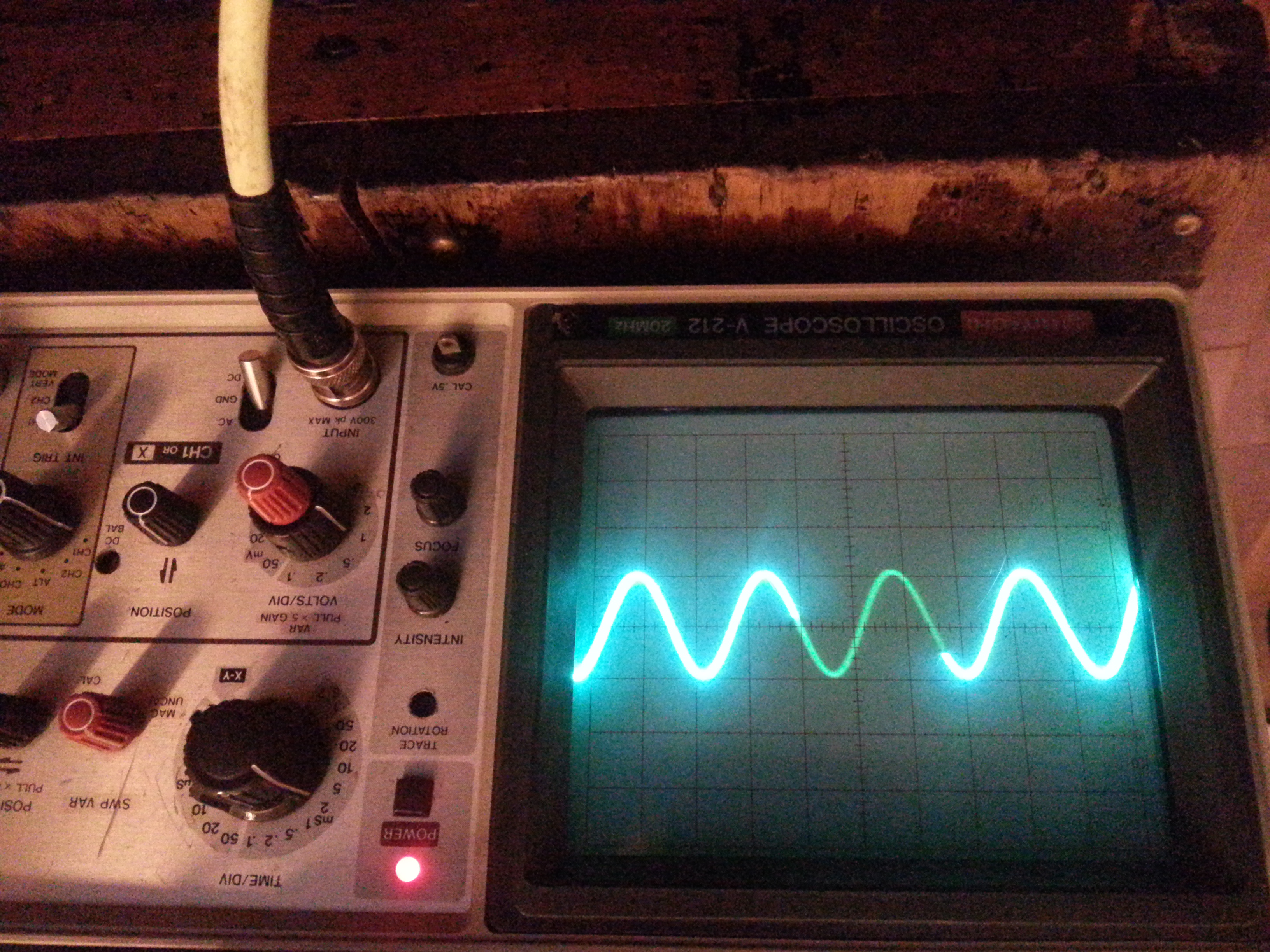

PostPosted: Mon Apr 25, 2016 2:11 pm    Post subject: Reply with quote  Mark this post and the followings unread
Here are a couple of pics. First one straight from the sine output of the 555 vco
Second one is with all pots cw. Input and output pots adjust level as expected. Distortion switch and pot do nothing , sorry this is different from what I thought I had observed in that the dist pot doesn't work at all. Even when bridged at the lugs with a wire to test.

Posts: 5888
PostPosted: Wed May 25, 2016 2:27 am    Post subject: Reply with quote  Mark this post and the followings unread
oh dear almost forgot about this. Maybe you already built a new one but what I see on the scope is petty much what I would expect.
but since you can't control it you probably get full distortion all the time.
Could there be something wrong with the pot ?!
