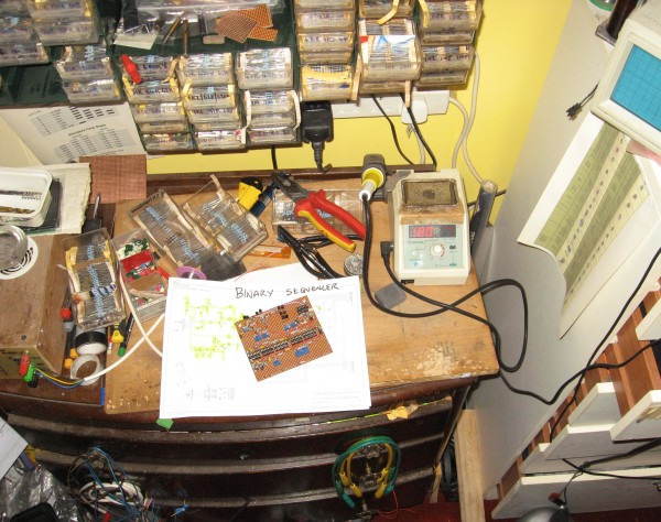

PostPosted: Wed Jan 14, 2015 11:13 am    Post subject: Reply with quote  Mark this post and the followings unread
I threw some components onto a bit of veroboard , almost done , just the transistor buffer outputs to finish then ready to wire up for testing on an old panel, I started with the IC sockets first , then worked away from them populating each section of the circuit. I love the tense moment when populating out from the chip sockets " have I cut the veroboard big enough"
hehehe it usually works out fine , just like this one did Smile .
I hopefully should be hooking this up to the modular for tests early next week.
Dave.

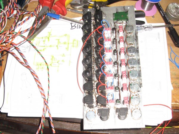

PostPosted: Sat Jan 24, 2015 2:07 am    Post subject: Reply with quote  Mark this post and the followings unread
Wire hook up stage now Smile Smile
 Filesize:  847.94 KB
 Viewed:  594 Time(s)

PostPosted: Sun Jan 25, 2015 7:54 am    Post subject: Reply with quote  Mark this post and the followings unread
Matthias.....
Smile
Got it powered up yesterday but had a little trouble with clocking to begin with.
I had a 5v square clock going in to the socket , no cycle , checked with scope nice square going into D1 , cut down by R3 (47K) into base of Q1 , collector outputting nice 0 - 5v square .
At the point where D2 & D8 & R12 join to clock in on 4024 the clock was up at nearly rail level clocking away, but not cycling the sequencer , for an experiment , I unhooked R67 from the +V and it started clocking normally , cool .
Rotary encoder , with this circuit disabled I tried hooking the return cable from the encoder, through a signal diode to the base of Q1 , it started working via that path , great Smile.
Could I ask what the best way is, to set up the trimmers on the TL074's for the cv.
Thanks Smile.
Dave.

good find, and a good move! i just doulbed the clock circuitry for both the actual clock input and the rotary encoder, which is nonsense obviously. the pull-up resistor of either the clock or the ncoder ciruitry would keep the the CMOS from counting, haha.
well done, you!
T1 through T7 are to trimm the attenuverters to 0V at center position of the pot. these trimmers are only needed when using push on knobs. when using knobs with a set-screw you could 'calibrate' just by putting the know into the correct position.
and now i am going to listen to your demo!

PostPosted: Tue Jan 27, 2015 4:00 pm    Post subject: Reply with quote  Mark this post and the followings unread
Ah thanks Matthias Smile Smile , I used splined shaft push on knobs , cool ,......... Just been at workbench and tried trimmers , I'am powering this using +/- 12V, the trimmers didn't quite allow the zeroing to adjust 0V to center knob position , tried a 33K in place of the 100K feedback R on the attenuverter , cool , can adjust to 0V center pot.
-10v to the left and +10v to the right and 0V in the middle Smile Smile , will change the other 6 to 33K as well Smile (even number resistors R70 to R82) .
many thanks for your help, Matthias.
Dave.
