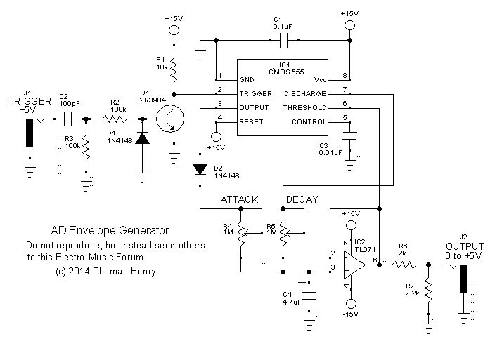

Hi Gang,
I saw a circuit for an AD envelope generator elsewhere on this forum and instantly thought it was way too complicated:
So, just as a diversion, I decided to come up with one that does the same thing, but with far fewer parts.
Here's the scoop. Most people think of the 555 as a timer, either astable or monostable, which tends to lock one into a rigid way of thinking. I prefer to think of the chip as a collection of parts. In particular, the circuit mentioned above requires an RS flip-flop, a comparator and some steering logic (diodes). In fact the 555 contains these. (Well, I did have provide one steering diode, the other imitated by the internal open collector transistor).
In one fell swoop (the only kind of swoop worth having), the circuit shrinks by leaps and bounds.
My good buddy Scott Stites gave it a shakedown with the test instruments and measured:
Minimum attack: 692 us
Minimum decay: 248 us
Maximum attack: 4.6 s
Maximum decay: 25.8 s
Max voltage: 5.04V
These are pretty specs, if I may be so immodest. It would also make a fine drum envelope generator, methinks.

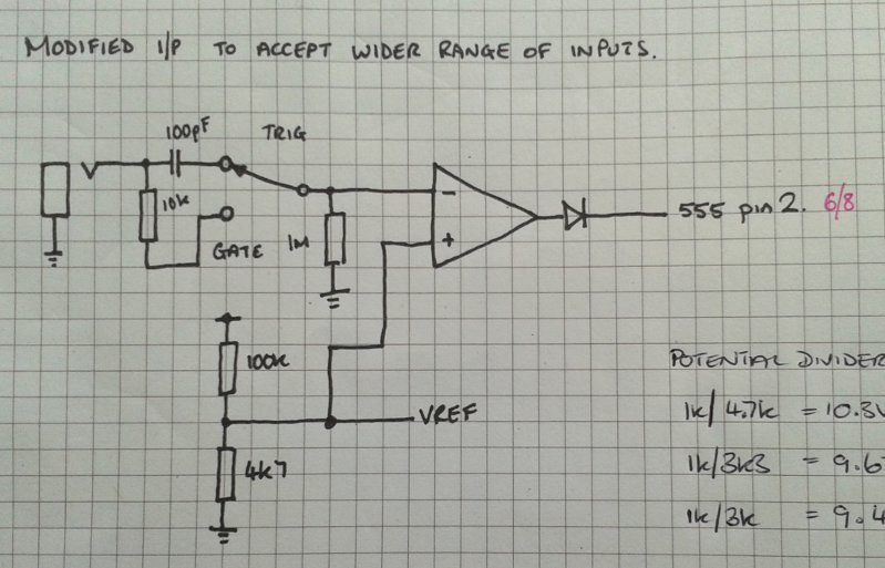

Tried this out this morning as I have a day off work and this envelope works beautifully.
Have replaced the input with a comparator which gives it the ability to work with a gate signal or extract a trigger signal from a gate.
Excuse my drawing!

Thanks for the comments.
The comparator add-on is unneeded; the original circuit will work directly with a gate input. The cap and transistor already differentiate whatever is applied, gate or trigger.

PostPosted: Fri Mar 07, 2014 10:07 am    Post subject: Reply with quote  Mark this post and the followings unread
Quite right, I wasn't trying to find fault with your design, I'm not in your league knowledge wise.
The reason I added the comparator was for a couple of reasons. The main reason was so I could trigger it with samples of trigger pulses from my Akai MPC as well as from my modular. Hence the low threshold voltage on the comparator.
The other was so I could feed it a gate signal and either use it as an AR envelope where the envelope stays high (once the attack reaches maximum) for as long as the gate lasts. When selecting the input through the original capacitor it stays as a AD envelope regardless of gate length.
Could I have achieved this simply by putting a bypass switch on the 100pF capacitor? As I trigger from my MPC manually the velocity and hence the level of the trigger pulses vary and I wanted to account for this.

Hi Tom, great circuit as usual! From a guitarist's viewpoint, could the peak voltage level of the attack phase be controlled by a voltage extracted from a "pluck follower"? (Craig Anderton's AMS 100?) The point being that if the AD output drives a VCF, the smooth decay phase should be completely ripple free.

Hey Mcop,
Try this. Just wire a SPST switch across the input cap. When closed, the unit becomes an AR envelope generator, when open it is an AD type. I find I can fire it either way with a gate or trigger whose amplitude is at least 1.8V.
I'll add the switch in the next draft. Thanks for suggesting it.

Sorry, I kept overlooking your question somehow.
If I understand it properly, I do believe the answer is no, at least for this circuit. The envelope peak is set by those three series resistors inside the 555. This is the divider that sets the comparator thresholds. Look at a block diagram for the 555 and you'll see how 10 volts is the magic number for the peak.
I will be incorporating this circuit within a complete synth voice, and providing artwork myself for a PCB, possibly for an article. But, Bubzy, you can leave what you have done up for others to play with.
And Wackelpeter, this is such a small circuit, that the easiest way to answer your question is just to breadboard it and see if a bipolar 555 will work. There will probably be some difference in how the internal transistor on pin 7 behaves which might affect the decay, but logically the circuit should work the same.
