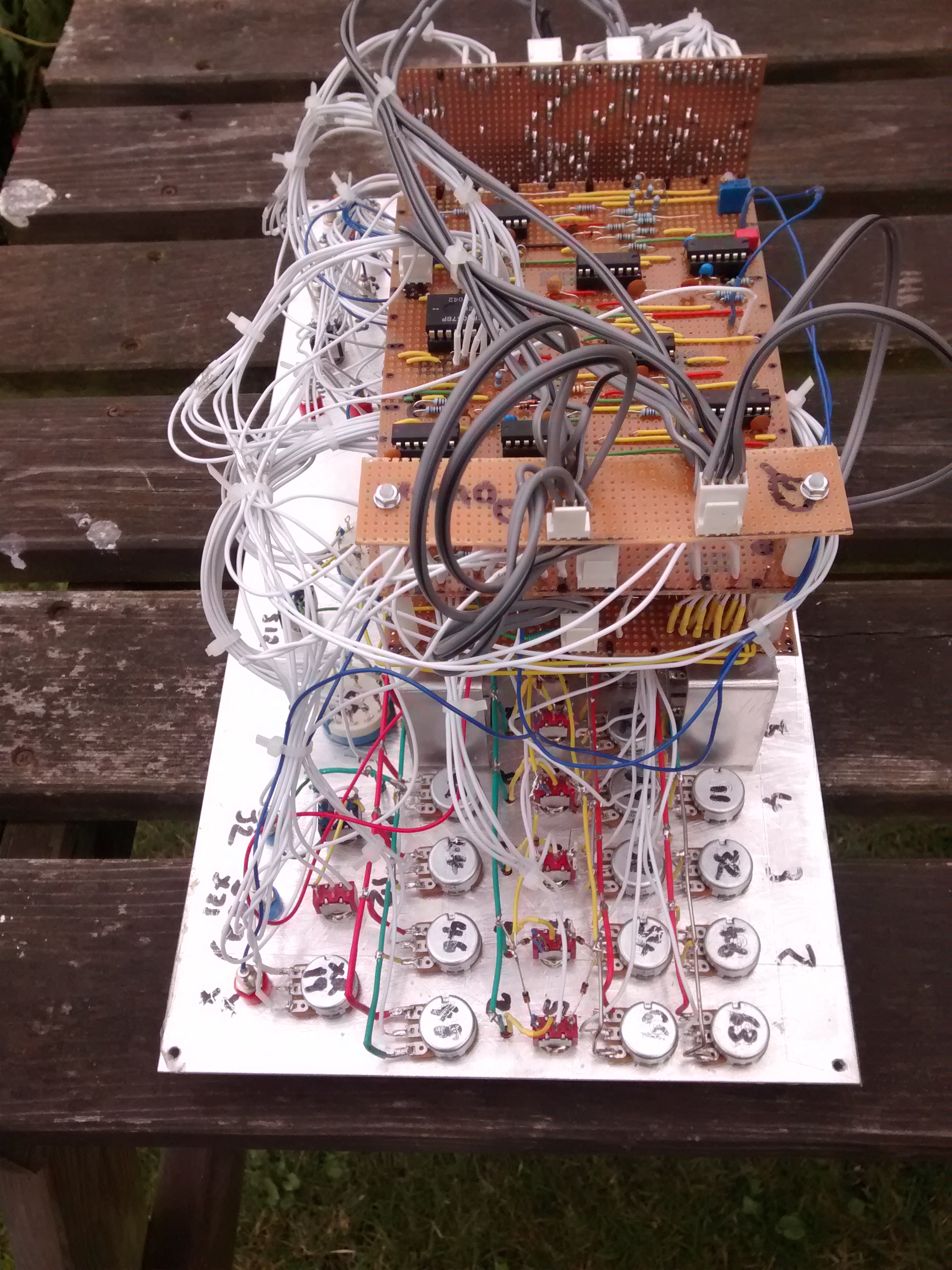

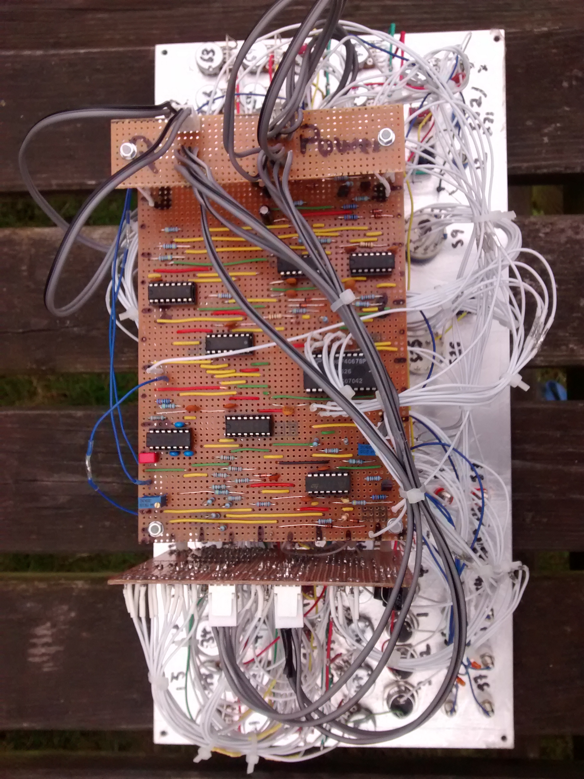

Finally completed building and de-bugging my MFOS 16 Step Quantized Vari-Clock Sequencer! Definitely the most complex module I've built - three boards: digital, vari-clock (stacked above each other) and analog, plus a small distribution strip.
I added a second channel (which just required a few more diodes), and also replaced the D-to-A clock rate resistor with a 50k trimmer. Getting the timing to work properly so that no and one steps behaved was a nightmare even with an oscilloscope.
A lot of board to panel wiring....
Well worth the effort though!
Peter

That looks fantastic. MFOS builds have lots of offboard wiring but they're fun to build and fun to play with. I'm currently building some MFOS modules that I think I'll put in a FracRak.

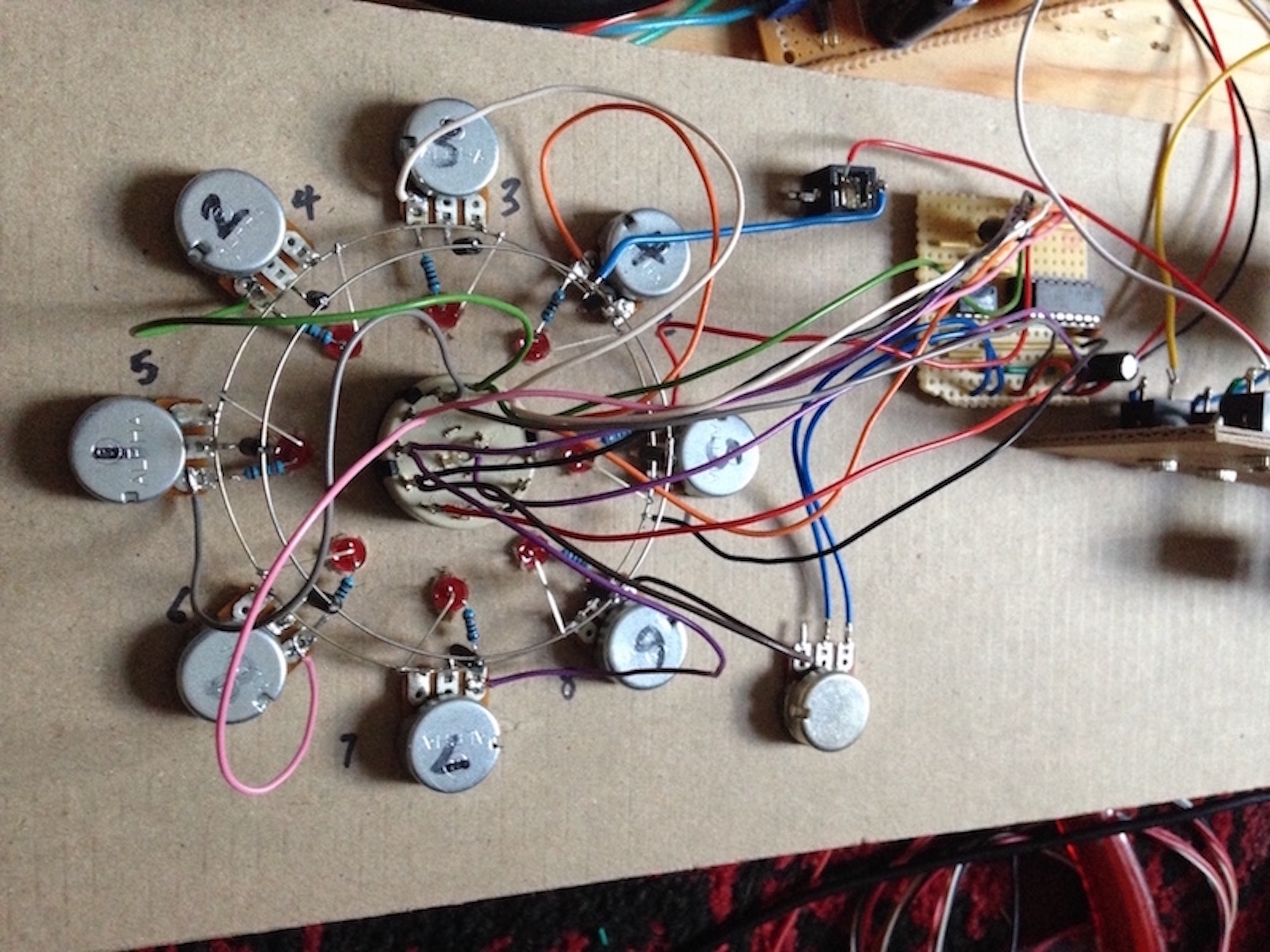

I've started to build a simple modular synth (my first one!) Everything is built on veroboard so far, mostly layouts from others here...for the VCF I made the layout as I couldn't find one anywhere else. The front panels are currently made from corrugated cardboard, and when I decide that I like a module I will make some proper panels up.
I have also started to make the PCBs for a MiniMoog clone and designed an 'in the style of Model D' mod wheel which i've 3d printed, I'll put some pictures up if anyone wants to see them. For the PCBs I tried toner transfer first but wasn't getting on very well so bought some cheap photoresist film and am really happy with the results but it is a bit tricky to apply it.

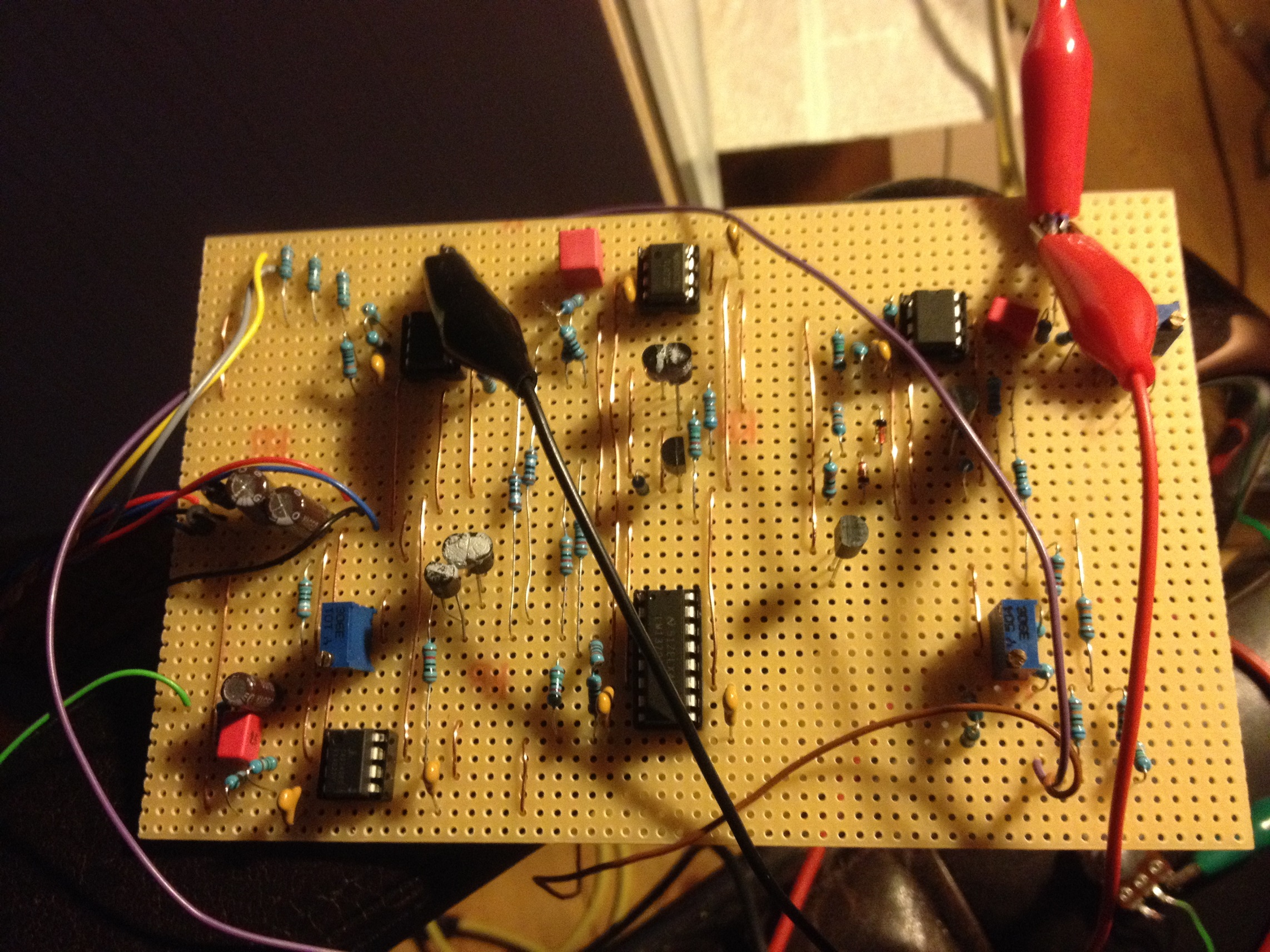

As you will see things aren't very pretty at the moment, but it makes noises! The VCF is the state variable one from Ray Wilson's Make book.

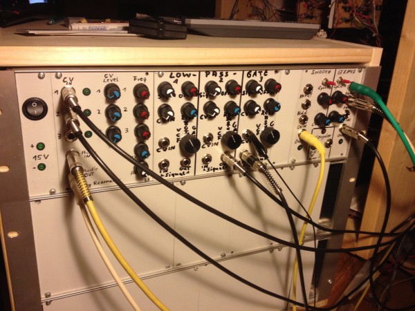

I have rested my soldering iron for a few months this summer, but now started to fill the next "cabinet" with modules.
So far there's one of Ray Wilsons (R.I.P.) Bipolar Wallwart PSU's, the Korg Ps3100 Triple-Resonator Clone based upon the schematics by Fonik (did a mix of some of some components from the schematics), 3x resonant LPG's and a Serge style Smooth and stepped Generator.

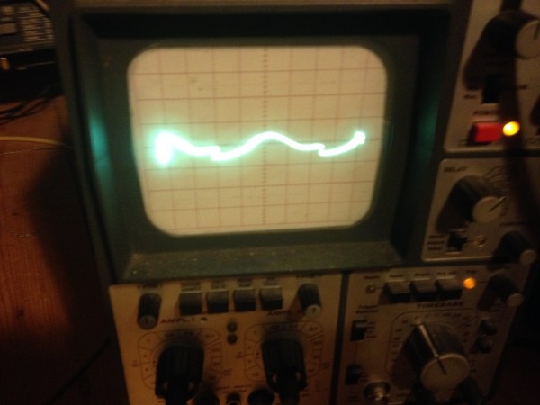

Started monday to build a clone of the Buchla 258 VCO based on the schematics floating here somewhere around (those with some notes by Jerk)
Well tracking over 5 Octaves was no problem... used only 3906 unmatched and with an KTY sensor instead of Tempco and as i want to save my remaining CA3080 for an TZ VCO somewhere in the future with an half of a LM13700. For the other trannies i used another 3906 and the other pair was two 3904... both FET's i used SK30.
Here i guess starts my problem... the waveform switching i solved with reducing the 680K resisitors down to 430K. Well the Saw is not as much wavy and fold as in the original but you can see those 2 humpbacks. The one thing i can't get work is getting a nice sine wave otu of the shaper with the other FET.
I always have at one edge a small steep flank on the signal... as can be seen on the scopeshot...
Anyone used 2SK30 for this and solved it or any other recommendations for easily obtainable and cheap FET's?

PostPosted: Tue Sep 13, 2016 3:18 pm    Post subject: Reply with quote  Mark this post and the followings unread
The Buchla Sine is not very perfect anyway. The various trimmers all interact as well, so it's a case of tweak one, then the other till you find a waveform you can live with.

Ah Okay, thank you.
As far as i noticed only the trimmer for the sine affects the sine really in my built. When the waveshape control is turned fully in the direction when it's a "sine" it stays a sine, no matter if i input a CV for Waveshaping or not vice versa goes with the saw... when i turn the pot slowly into the middle direction the effect of the Waveshape CV get's bigger and in the middle it is at it's highest effect turning form one to the other shape and then turing the pot further the effect goes smaller until it's only a sine or saw depending in which direction you've turned the knob.
Is this common within this VCO...? Well i think it's fine it safes me a pot for Waveshape CV amount if it works this way.

PostPosted: Wed Sep 14, 2016 4:40 am    Post subject: Reply with quote  Mark this post and the followings unread
It's been a while since I built a J3RK 258 but I definitely remember there was another trimmer that had significant impacton the sine shape.
And also that none of the wave shapes were anything like ideal.
I'd suggest looking on muffwiggler for the notes about J3RK's PCB offering to see if you can find other details.

Tried it again with matching my diodes and also the 1% resistors i already had as close as possible... didn't changed anything...
then tried to trim again and looked at the scope when these edge got smaller... after a time it didn't changed anymore... so i was at the end of my trimpot... now measured what i had between the wiper and the outer lug not used in the design... 0R so i possibly needed more than 20k... changed to a 50k trimmer and voila the edge went down an down and closer to a perfect sine... well 50 wasn't enough to close the gap but 100k i guess will do, try this later maybe... now also the saw is more closer to the original... fine Very Happy
Edit:
I realized that i build a mechanical vibrato in my 258 VCO clone.... When i wiggle my cabinet i have a slight vibrato on my tone... looks like a cold solder point... Rolling Eyes Laughing party!
