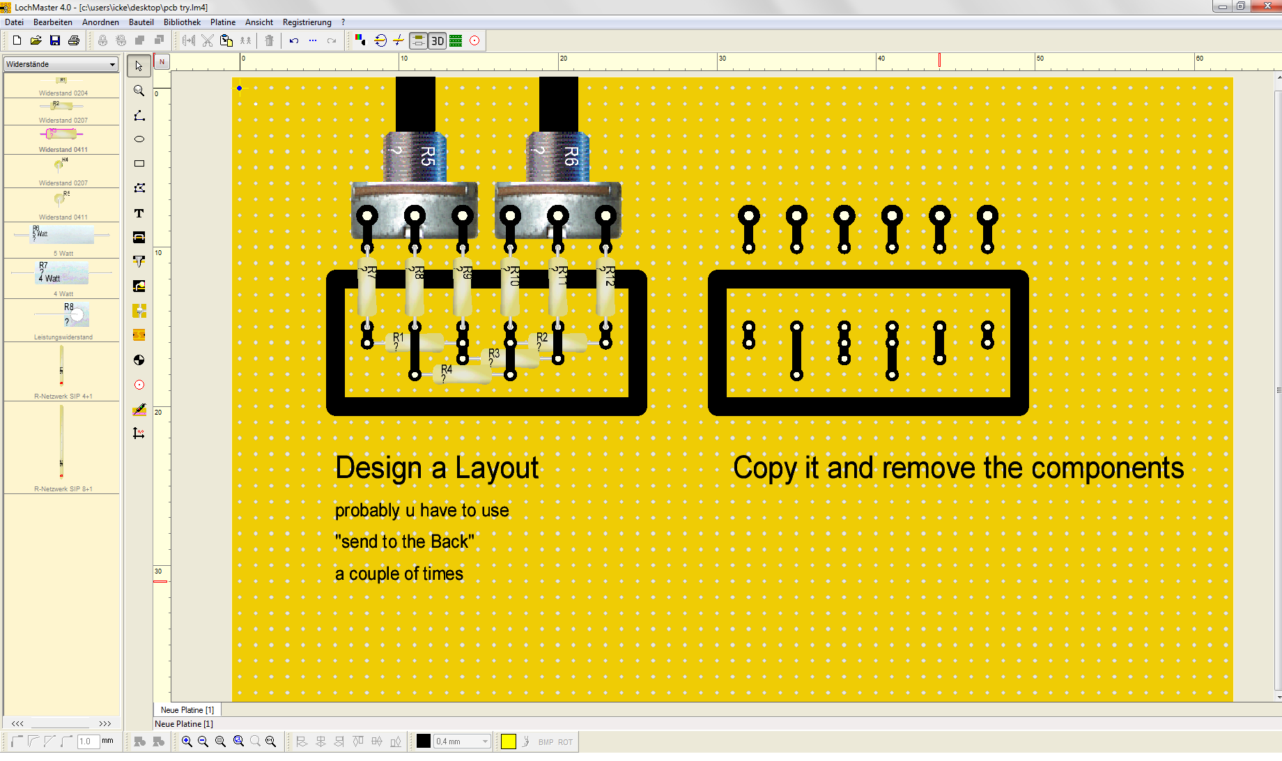

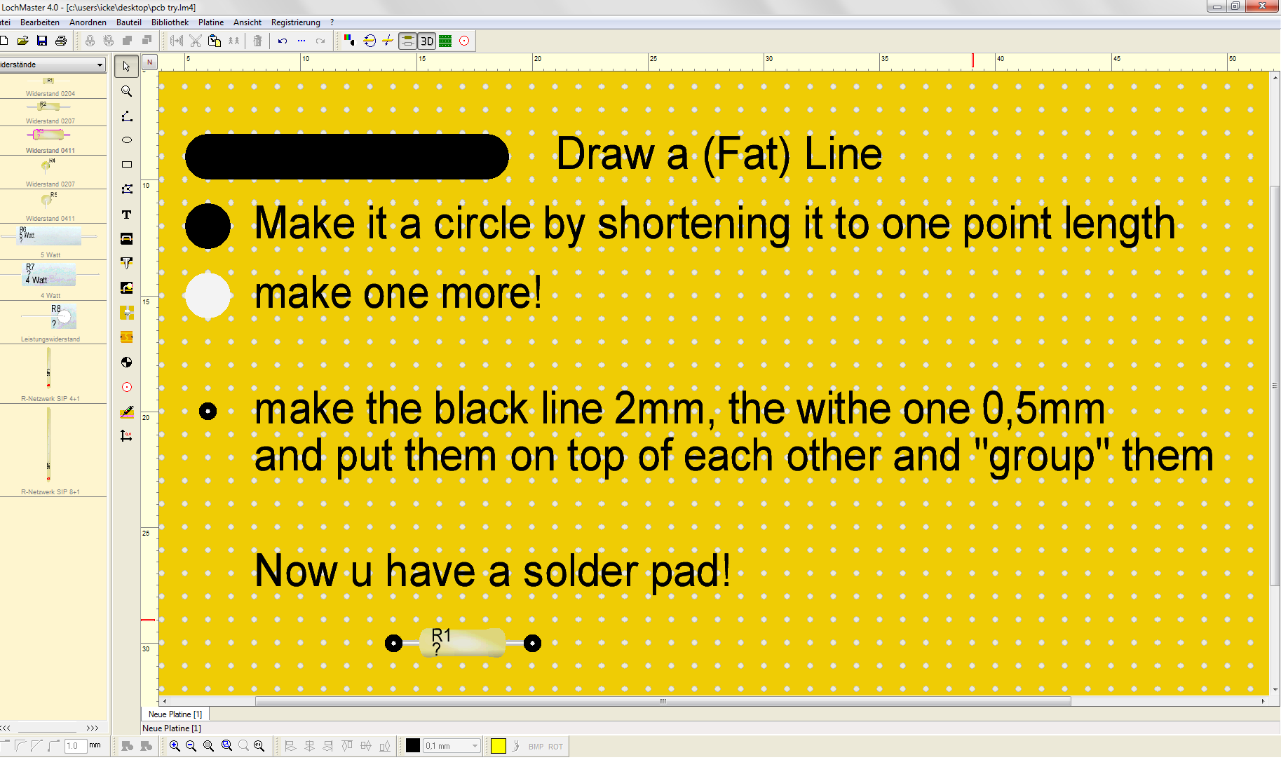

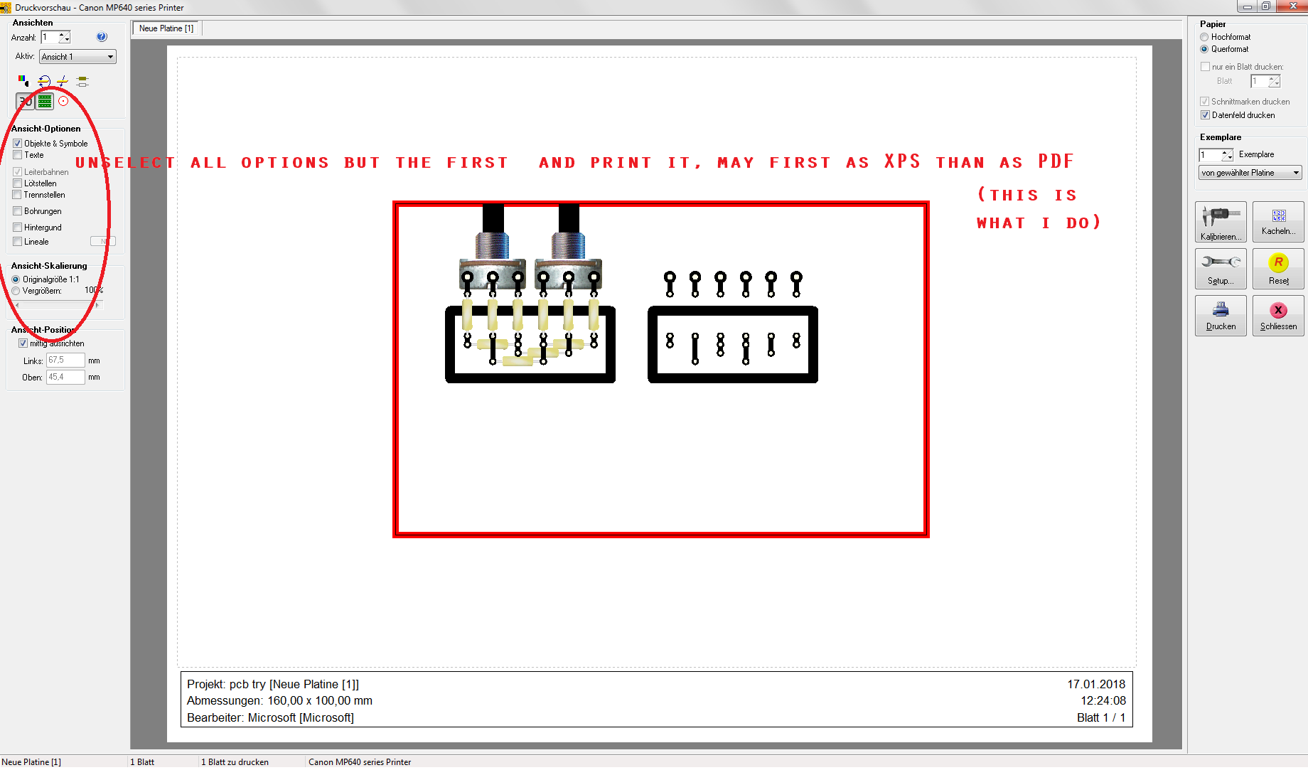

how to make pcb with Lochmaster
means u could make a stripboarddesign same time a pcb

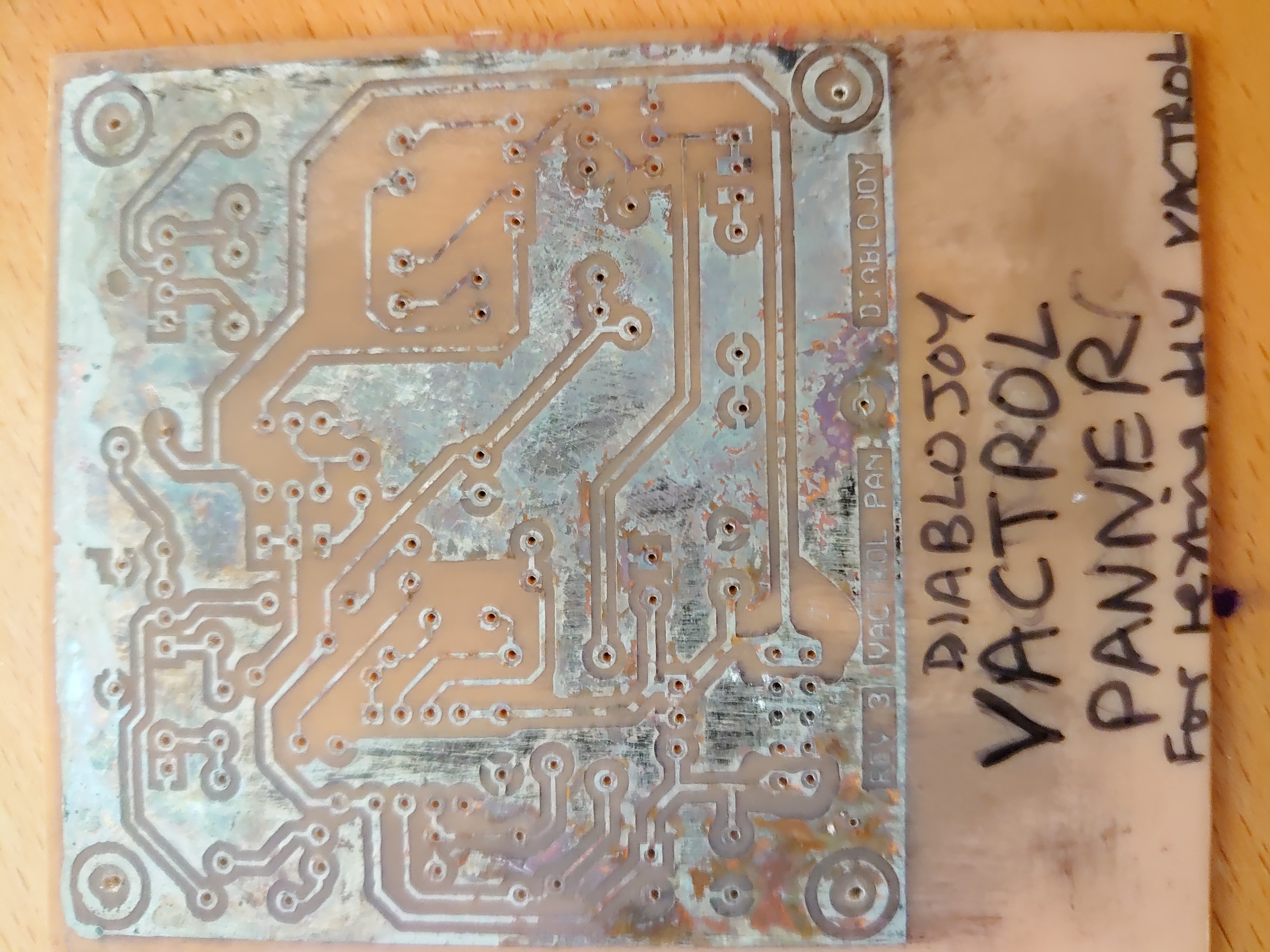

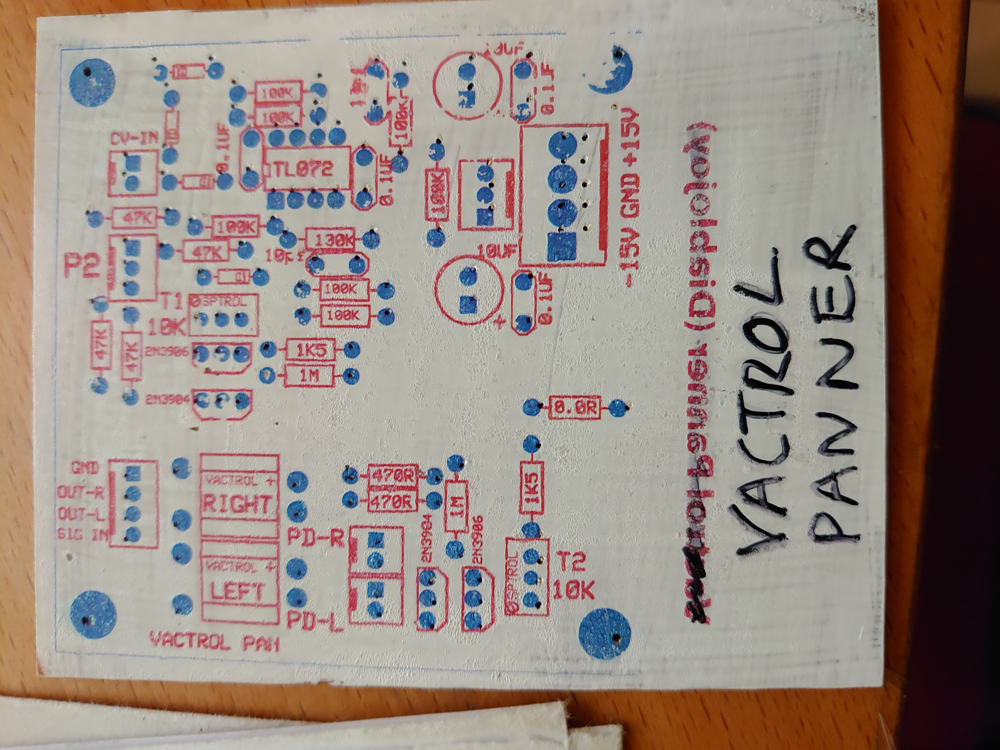

Laser print onto radiator paint with cheap chinese yellow transfer paper is quite reliable. With the right heat of iron for the right time (short as possible but so the transfer still works - obviously).
The paint sometimes melts into the holes & some have to be drilled out again.
But I really like to have a components guide.
Maybe if I got more used to not having a "silkscreen" on etched boards it would be better. Maybe it saves time. I don't really know but it was kind of fun trying (?!)
And needed longer in tinning solution! All the traces are fine just not showing well in picture if they are not tinned enough.

looks good, props
ive never heard about "Laser print onto radiator paint with cheap chinese yellow transfer paper"
is this completly new? or you have some links to read or watch about?

Thanks for the kind words. I did not see it anywhere but was inspired by the acetone transfer method - which is ok but does not always result in a very clear 'silkscreen'.
So I thought white paint on the back of the pcb would help toner transfer to stick and be nice and clear. I tried radiator paint as it should be more heat resistant.
Toner transfer onto radiator paint with just normal laser printer paper was ok but the paper did not rub off so easily. I tried the cheap yellow transfer and it was much better. Make sure you tape the cheap yellow paper onto a sheet of normal laser printer paper as "carrier paper" or it gets caught up in your printer (as I discovered)
(Only drawback is the paint can melt, into some holes, when ironing the transfer on but I reckon it is possible to do it to just avoid melting into holes).
Let me know if you want further details and I am happy to describe the method. It is very easy.

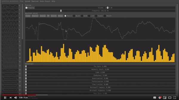

http://synthtech.com/waveedit/
A very nice website to get acquainted with wavetables, how they sound and look like.

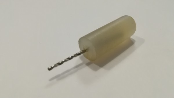

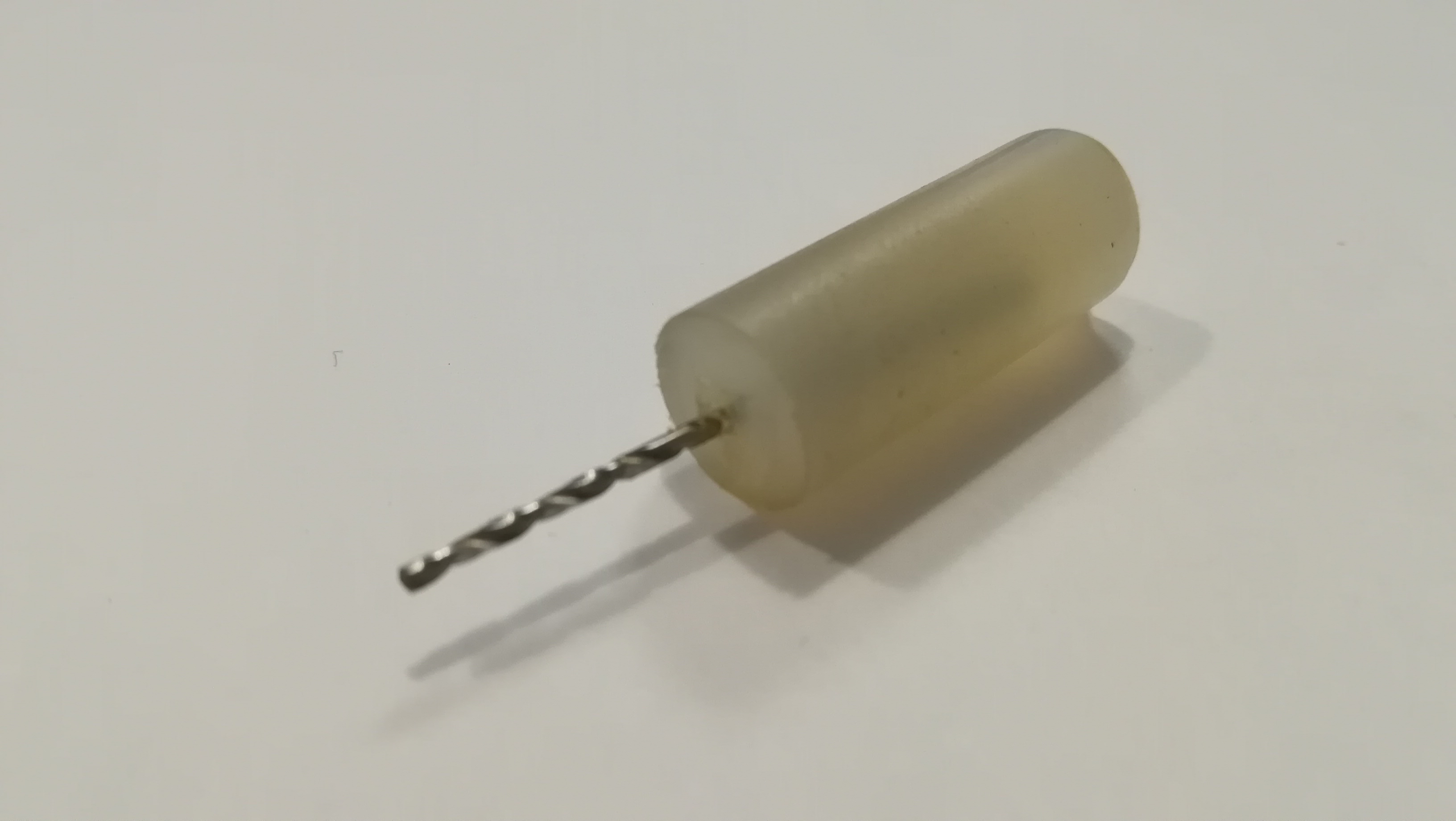

sometimes we use drills by hand
always wanted to have a kind of handle for the drills
found one which is in my pricerange Very Happy
it works better then initially expected
heat up the drill and press it then into a hotmeltgluestick
Shocked Very Happy Shocked Cool
cheers

neat, that might come in useful some day Very Happy
I usually just wrap some tape around it but for very small drillbits this seems more practical.

I use a rubber band doubled over a few times works well.
