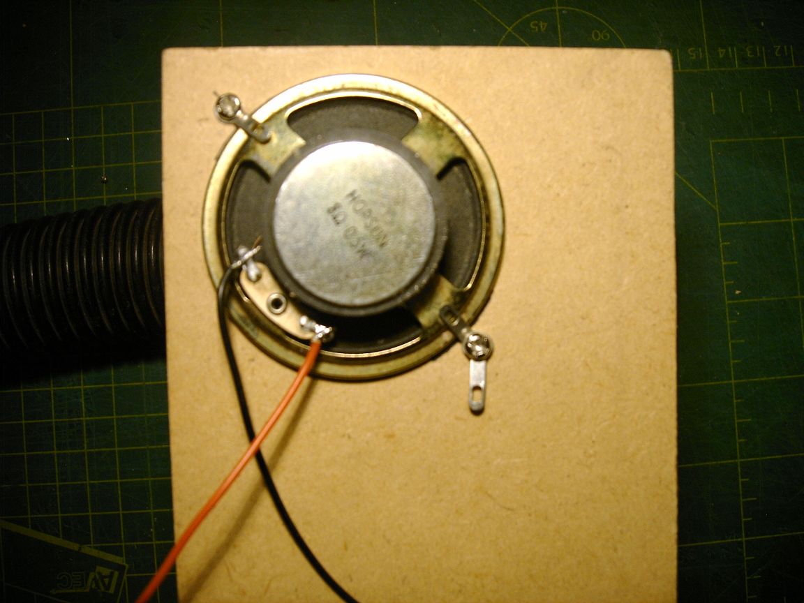

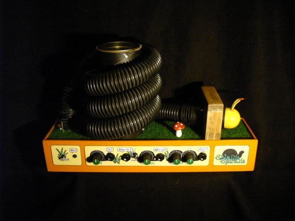

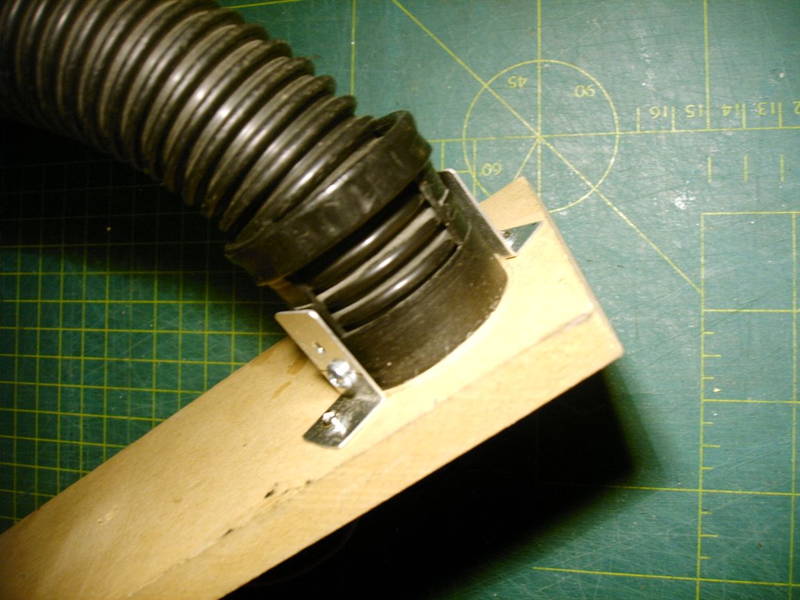

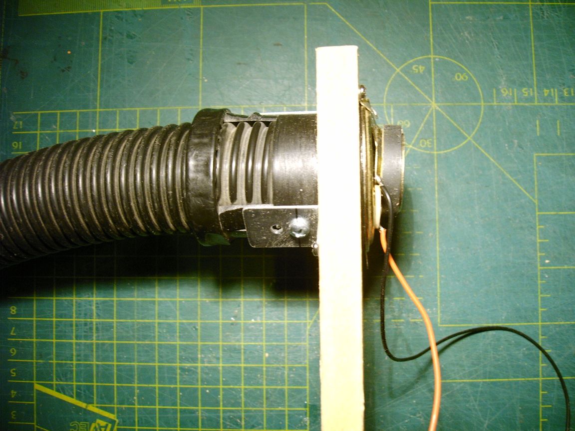

my vacuum cleaner broke and while I was disposing of it I noticed the sound the tube (or rather hose, but vacuum tube sounds nicer Wink) made.
Being the professional scrap collector that I am I couldn't just get rid of it without trying something with it first. So inspired by the cooper time
cube I wondered what it would sound like with a speaker on one end and a microphone on the other and that's what I am working on now.
Unlike the time cube my goal is not a delay but rather the resonating sound you get when sounds travels through a tube
I started by mounting a small speaker on a piece of wood and adding the tube to the other side. I glued part of a rubber band on the end,
which was quite a challenge, for a snug airtight fit. After that I breadboarded an amplifier for the speaker and a small microphone amp
to do the first test. That actually worked quite well, the sound isn't very profound but it does definitely add something and I thing it could
work great for drums.

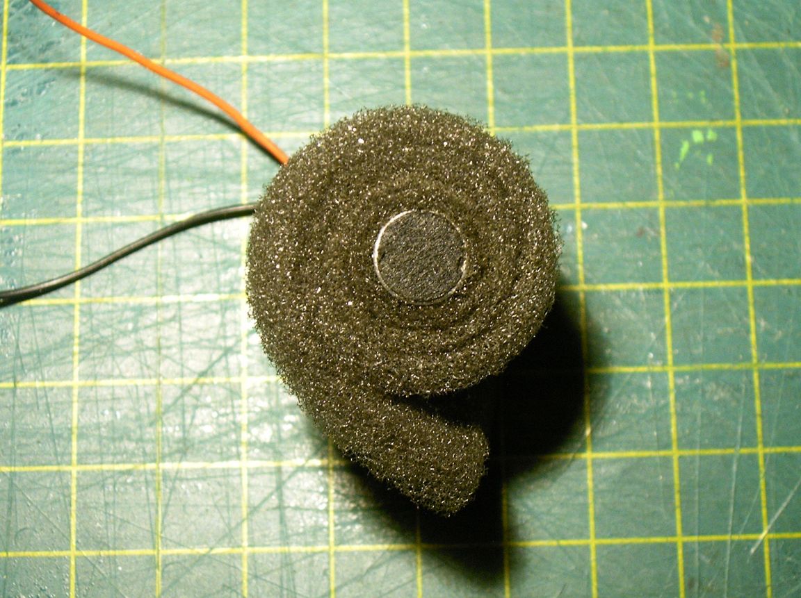

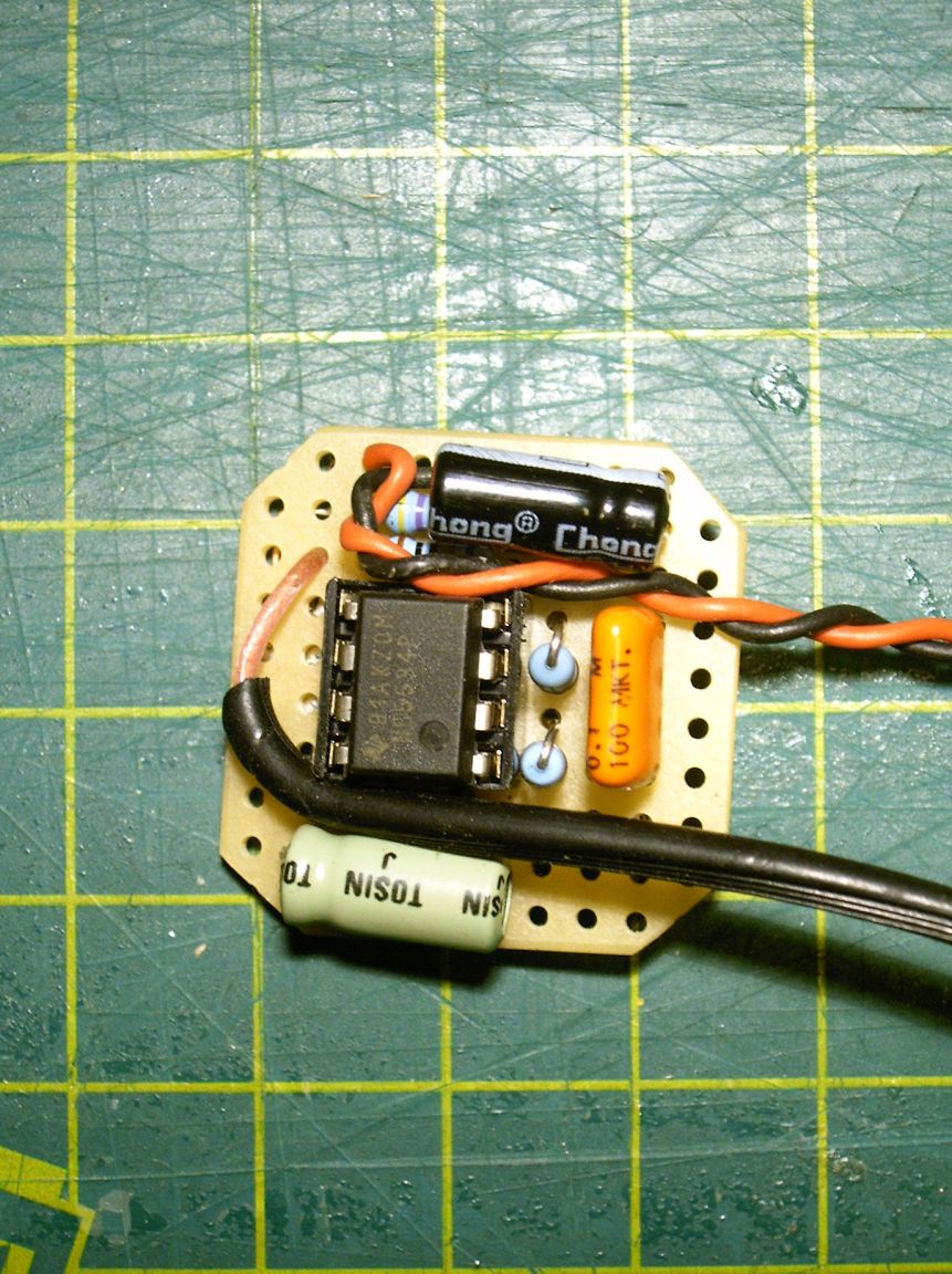

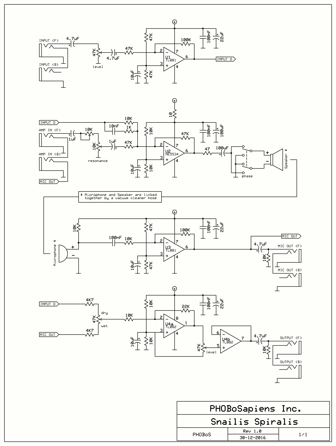

Posts: 5881
PostPosted: Mon Dec 19, 2016 1:29 pm    Post subject: Reply with quote  Mark this post and the followings unread

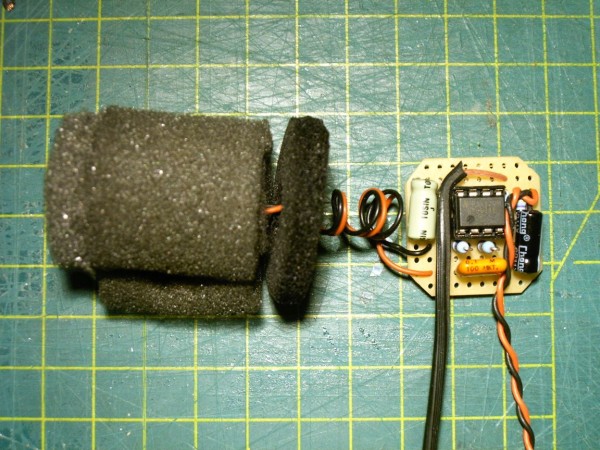

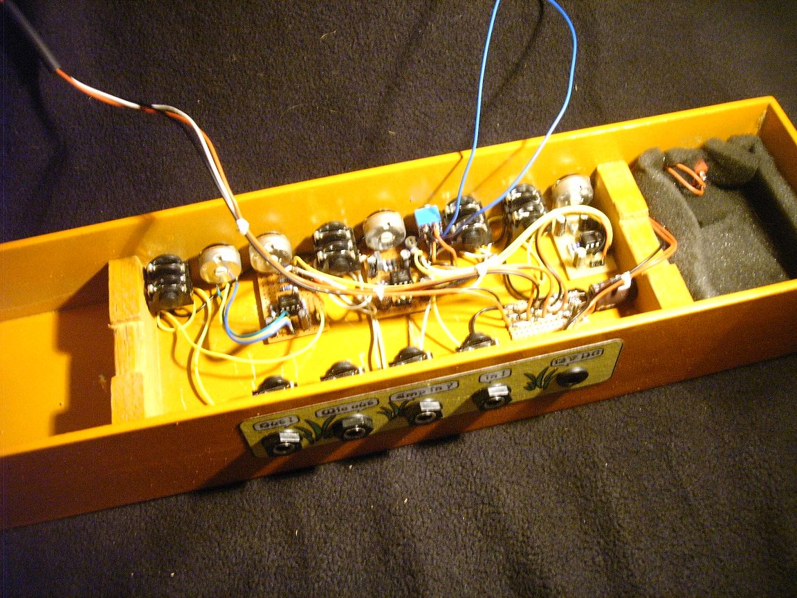

here are some photos from the mic and preamp (will post schematics later). the microphone is an electret type
which I rolled up into some foam which fits loosely in the tube but just tight enough so it doesn't move.

Posts: 24499
PostPosted: Mon Dec 19, 2016 2:00 pm    Post subject: Reply with quote  Mark this post and the followings unread
Ah! a vacuum tube filter Cool
Posts: 5881
PostPosted: Mon Dec 19, 2016 2:28 pm    Post subject: Reply with quote  Mark this post and the followings unread

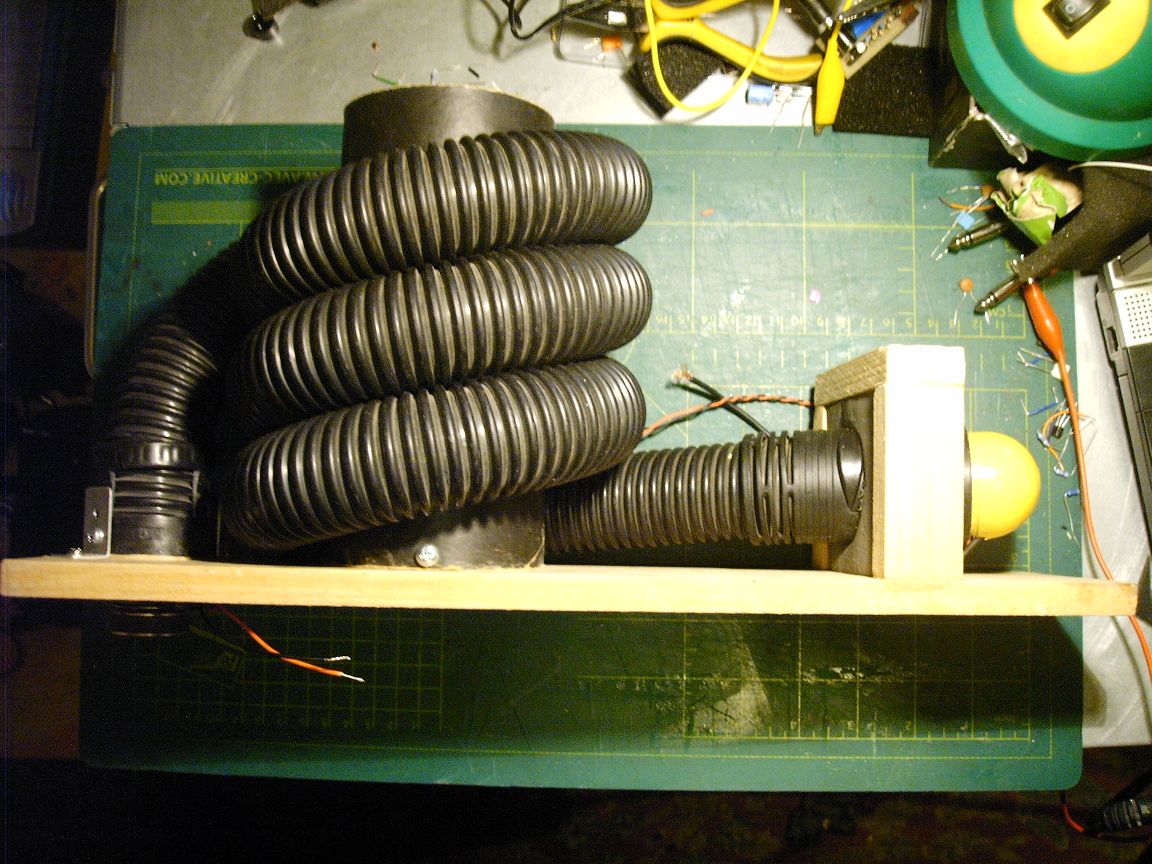

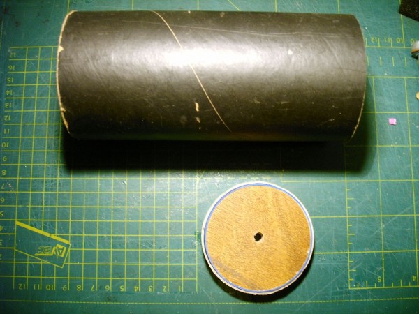

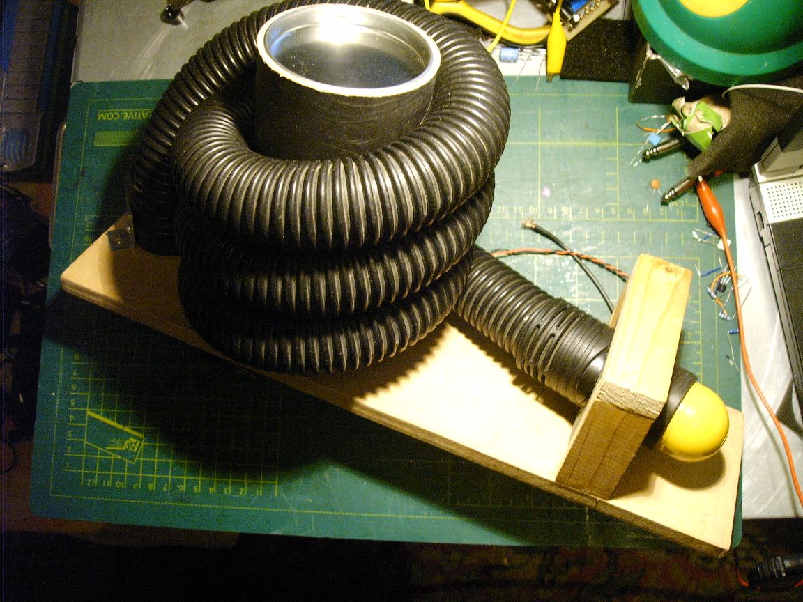

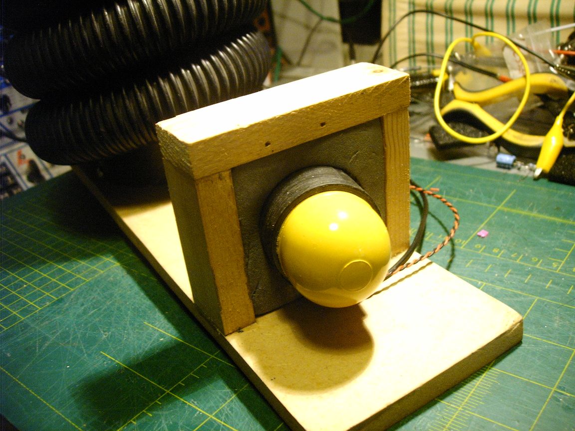

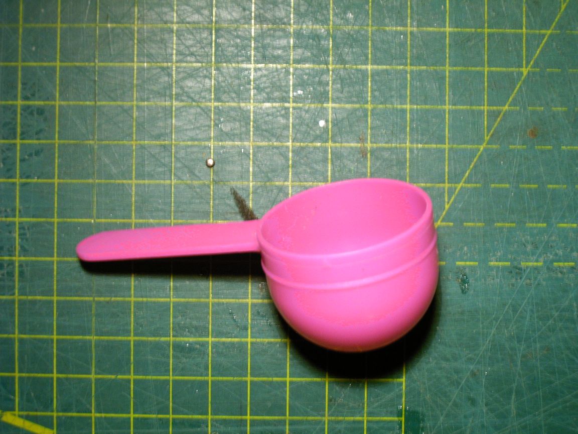

to hold the vacuum tube in place I mounted a carboard tube on the board by screwing it to a wooden disc. I used a hole saw to cut out the
disc and it was a bit too small but with the help of some tape and a ring of another cardboard tube (which fit right in the other one)
I got it mounted to the board. The microphone end of the tube is held in place by some thick foam and I used part of a measuring
spoon to cover that end up. I painted it yellow because the pink head at the end of the tube just looked, well, VERY WRONG Embarassed
so now I have some more testing and soldering to do. I did already solder up the amp though but haven't tested it yet, so that's next.

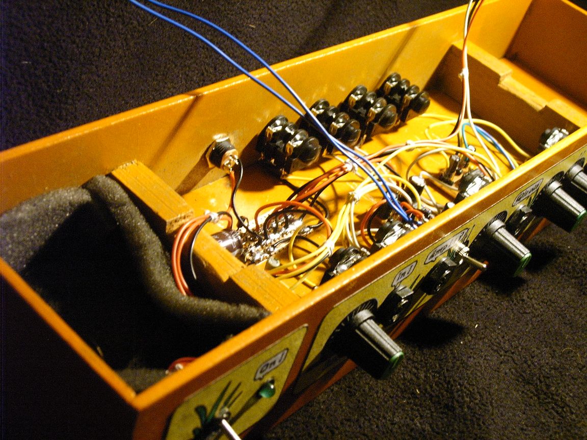

Posts: 5881
PostPosted: Wed Dec 21, 2016 6:14 pm    Post subject: Reply with quote  Mark this post and the followings unread
oh 2 speakers Razz I think I might have another hose somewhere, unless I actually threw it out, will check tomorrow but first have to finish this one.
Could indeed be very nice!
Posts: 5881
PostPosted: Wed Dec 21, 2016 6:42 pm    Post subject: Reply with quote  Mark this post and the followings unread

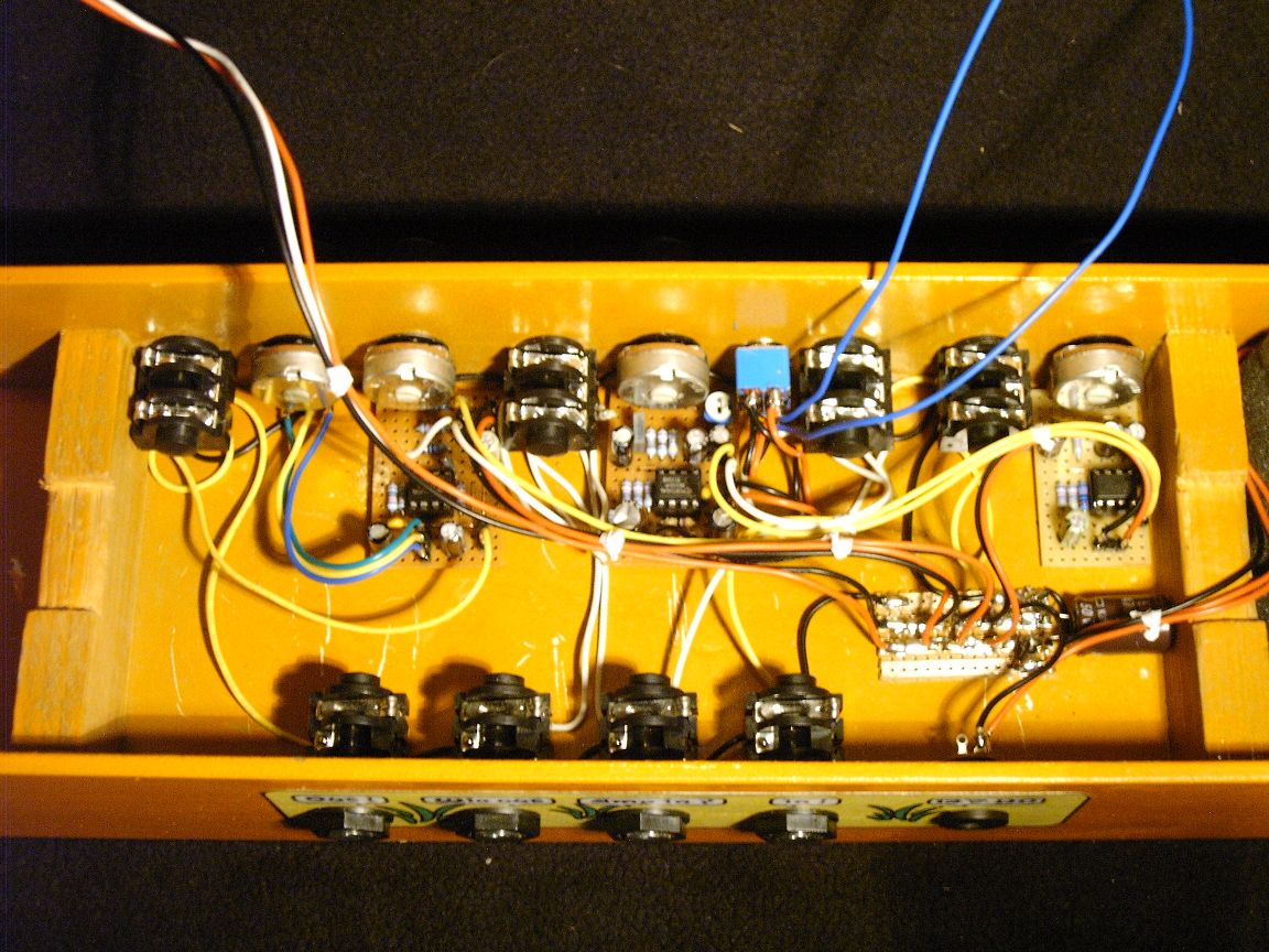

soldered up some more circuits, from left to right: input buffer/amp, speaker amp with resonance control (feedback from the mic), output mixer/amp.
The output mixer hasn't been tested but it worked on breadboard, the rest works ok. Cool I have an idea for the design but for that I'd probably have
to temporarily remove the hose and I am not sure if that will be very easy because of the rubber band, but I will give it a try.

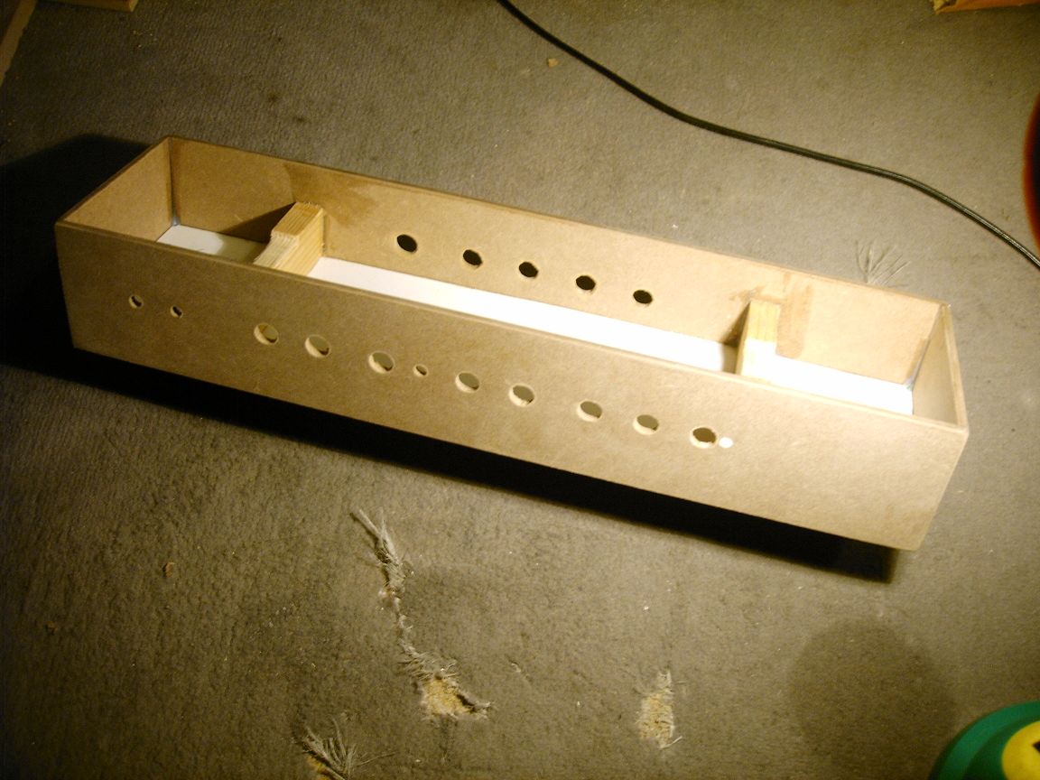

In the meantime I made a base for it which is actually painted by now (but still drying). So maybe I can start putting it together a bit tomorrow.
I also did some other small things but you'll get to see that when it is done or at least in another photo.

Posts: 5881
PostPosted: Fri Dec 30, 2016 12:41 pm    Post subject: Reply with quote  Mark this post and the followings unread

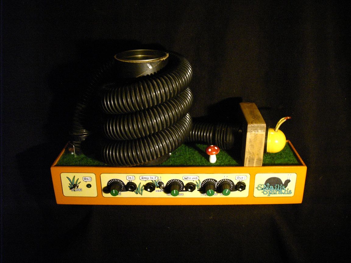

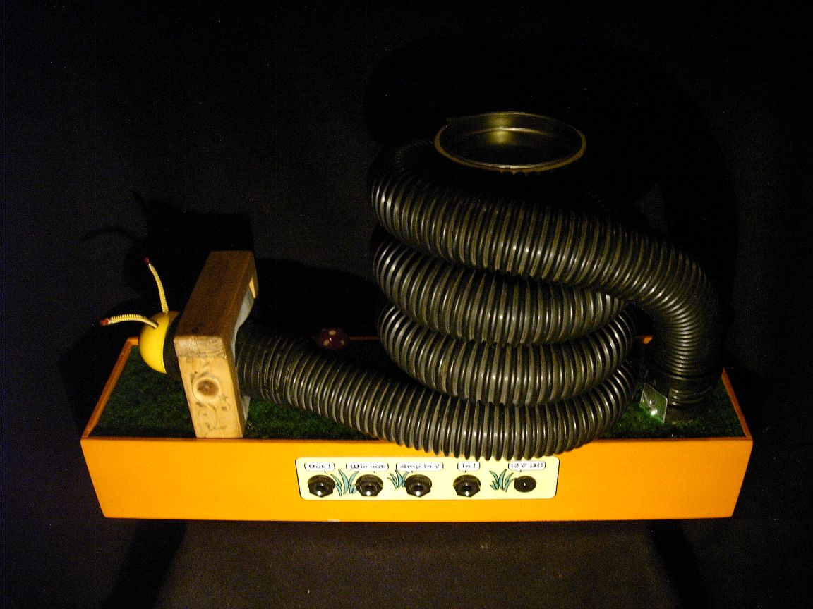

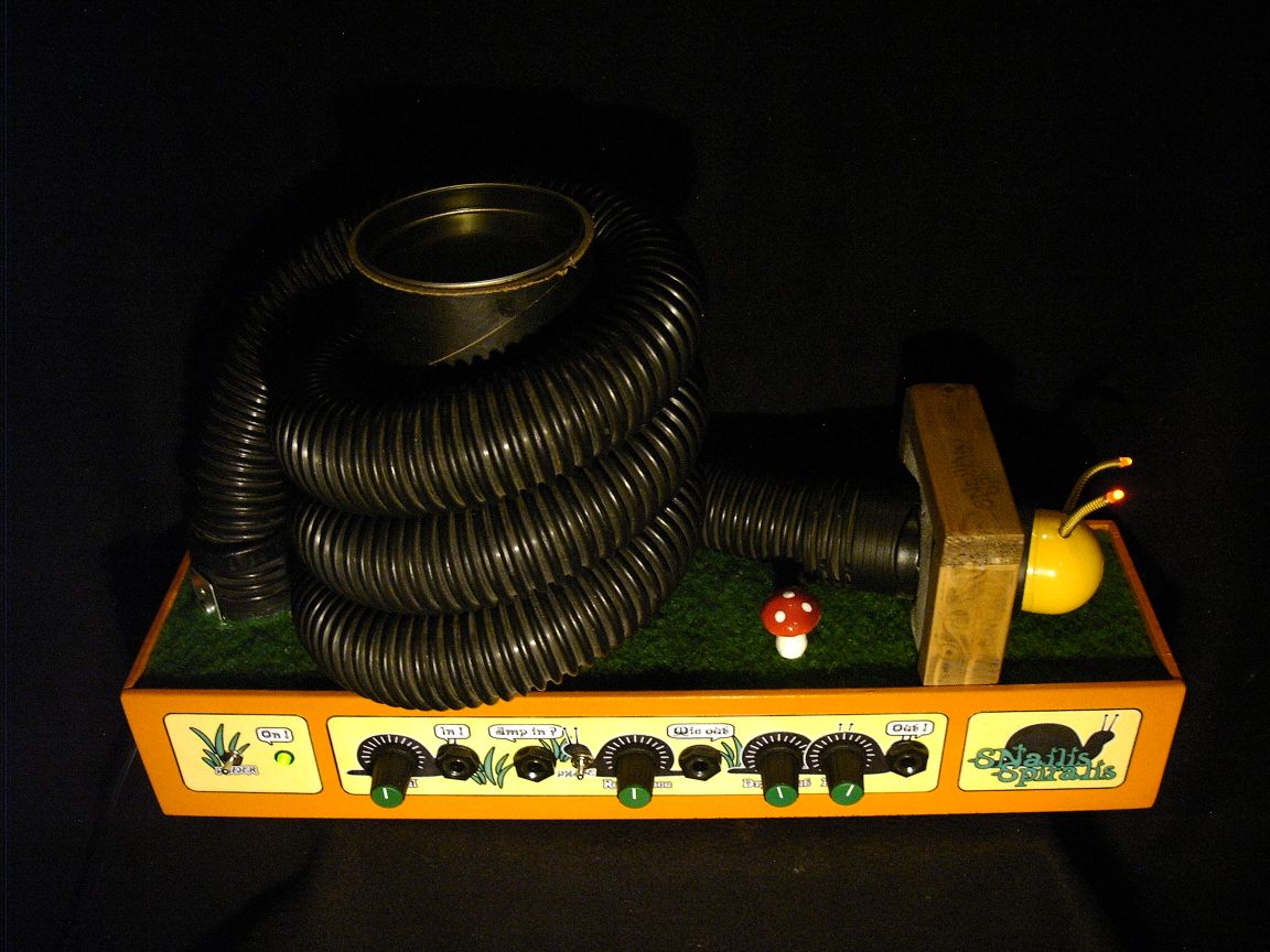

Finished it just before the end of the year Razz . Here are some snailgut photos and the schematic. I added a switch to change the polarity of the output for
the speaker and the result is that it actually seems to change the resonant frequency. I guess this has to with it being mixed with the original signal. For
power distribution I used a piece of stripboard as a busbar. I'll record some sounds too but I first have some other things to do before NYE.
