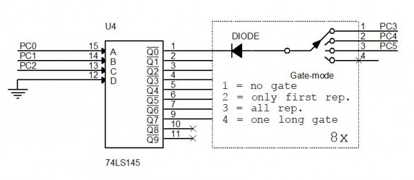

Next will be the 4 position switches for the gate modes (no gate, a gate for every step, one gate at the start of the repetitions per channel, and a long gate covering all the repetitions in one channel). And the on/off switches for the glide.

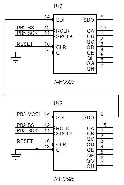

I need a lot more outputs as available on the Arduino I used. Therefore I made this small circuit that gave me an additional 16 digital outputs.
They will be used for gates, LED's etc.
So I connected two 74HC595 in series (the serial in from the first 74HC595 is connected to the MOSI of the Arduino, while its serial output goes to the serial input of the second one).
The program settings in the Arduino code for this circuit are:

Writing to the 74HC595 goes like this:
void send_to_parallel (uint8_t byte_one, uint8_t byte_two)
PORTB&=~(1<<PB2); // drive SS low
SPDR = (byte_one); // send Byte
while ( !(SPSR & (1<<SPIF))) {};// ready?
SPDR = (byte_two); // send next Byte
PORTB|=(1<<PB2); // drive SS high again

As you can see in the timing picture it takes about 4.7 uSec to write a 16 bit word to this circuit, not too bad.
But: I have placed the 74HC595 close to the Arduino and have a 100NF cap close to the power connections of these chips.
Now I have used 2 74HC595's in this circuit, but you may add as much as you need, you just have to add more data to be sent.
Schematics for the to parallel section

I have added 4 slide switches for the gate control. Now I can choose for each channel what kind of gate I want: no gate (duh..), only the first repetition has a gate, every repetition has a gate and a gate covering all repetitions.
Here a short demo of the switches: https://youtu.be/QPUI9k5kWKM
The 8 switches with their BCD to DEC decoder.

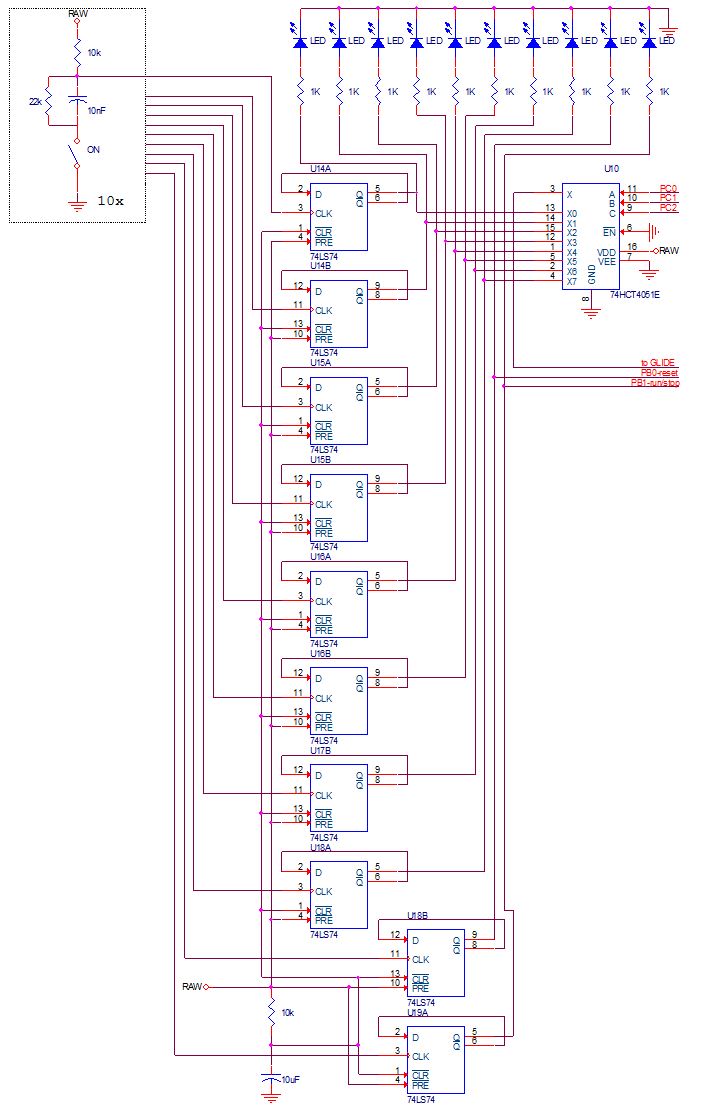

I am working on the switches, used to switch the glide on/off for each step of the sequencer.
When pressing the switch there will be a short pulse going into the clock, the 74LS74 has it's inverted output connected to the D-input, so every time the clock gets a positive going pulse the output will change it state, turning the push-buttons into on/off switches.
Circuit of the switches used to switch glide per step on/off, and two switches for run/stop and a reset switch
