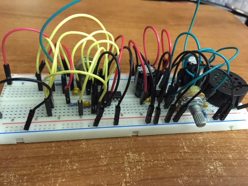

Thanks for the links. The first one has a nice minimal 555 timer that acts as a Mr. Microphone all by it's little self! Very cool. The second one shows how to calculate a 1/4 wave antenna length for FM dipole (not AM coil) and other similar frequency bands. The height of the driven element is the same distance as the radial length the ground wire array. Definitely two resources worth a look to anyone following this thread.
I had begun work on a simple circuit to act as an audio-oscilloscope. The attached photo, repeated from prior mention, shows the first rev of the device. The plan is to use a diffamp circuit followed by an LM386 speaker amplifier. It's a classic that I'd like to include in my toolbox of audio circuit dev toys. It allows us to hear any probed node or probed differential nodes as an audio stream on the speaker.
Also in mind is a simpler version using a discrete diffamp. It's a bit of a wander from the original chained oscillator topic, isn't it? We can get back to that later.
