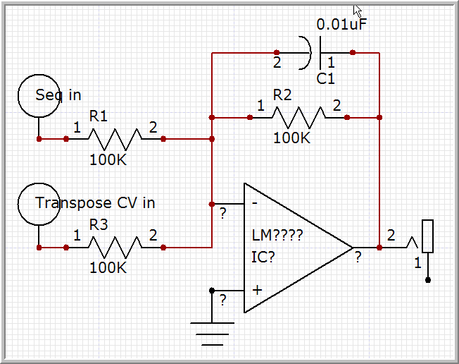

You probably should put a buffer amplifier on the output of this circuit because different valuses of loads will change the voltage.
To answer Pehr's question, it's not a great idea to just put a pot in series with the output of this devices because it will load the output and also, you can only attenuate the output. This will have the effect of changing the scale.
If you want a transpose, you should use a mixer.
I'd suggest using one opamps, for a mixer of the sequencer CV and a a buffer (from a pot of any other module) and one to invert and buffer the mixer. You will have to switch the connections of the step pots around because mixers invert, but that's no big deal.

Pehr
Joined: Aug 14, 2005
Posts: 1307
Location: Björkvik, Sweden
PostPosted: Sat Aug 27, 2005 6:53 am    Post subject: Reply with quote  Mark this post and the followings unread
Aha, I see. So the seq. CV and the transpose CV (from a keyboard CV?) is added together, right? resulting in a transpose of the sequence... Confused
YouTube channel
flickr photostream
http://loxodrom.blogspot.com
Posts: 18260
Audio files: 228
PostPosted: Sat Aug 27, 2005 7:14 am    Post subject: Reply with quote  Mark this post and the followings unread
Yes. The transpose signal can be a keyboard, and osc, LFO, or even just a pot.
Add more 100K resistors on the left side of the drawing and you can add more things to mix in.
