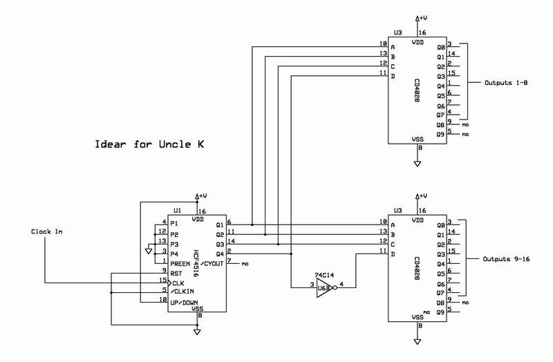

Uncle K,
Well - hope the attachement works.
Anyway, here's an alternative to your design. This is the core of the ARP 1601 sequencer and what I'm using for my current 32 step sequencer project. I've changed it a bit - ARP didn't use an up/down counter. It works like a bat out of hell. It's not much more complex than what you have and offers some flexibility in what the sequencer can do, with little added circuitry.
Using the U/D counter will allow you to step up or down in your sequence. You could put in a switch that directed your 'reset' command, which is used to set the number of steps, to instead change the direction of the sequence. That's where another stage of the Schmitt trigger (hell, you have five left over) would come in handy, in addition to a flip flop.
The CD4516 would let you pull a lot of stunts (preload, reverse count, etc), but of course you cold just use a simple up counter, too. I've found this general setup to be a lot easier than the CD4017 route.
If you set up a switch to disallow the inversion on the 'D' input of the second CD4028, then badda-bim, badda bam, you have two 8 step rows in parallel.
Cheerio,
Scott

Note - to get the two 8 steps in parallel, you'd actually want to prevent both CD4028 input D's from going high - a simple enough matter. You could do it with a simple switch and MML logic using the same 74C14/CD40106 package that the selection toggle resides in. Just diodes and a couple of resistors configuring up some AND gates.
Scott

Yes, that's why a 4516 is in there. The schematic is rigged that way for simplicity in getting started.
Preload is something to look at too - makes a good way to randomize a sequence with additional circuitry.

Having the ability to parallel the two decoders (creating two 8 step sequencers) would come in handy in a number of apps.
The first would obviously be that you could have two separate notes per step.
The second would be that you could have a preset cutoff for a filter per preset note. Reference Tomita's rendition of "Golliwog's Cakewalk" from "Snowflakes Are Dancing".
The third would be that you could accurately tune an operator and carrier VCO for tuned FM sounds (bells, etc.) - this can be problematic otherwise. It's fairly difficult to get linear tuning of FM with analog synths for a single CV driving the operator and carrier. That takes a high degree of accuracy on the VCO's. being able to tune the differences out per step makes it a very doable thing.
Of course, two separate decoders would not be necessary for this. One could just as easily rig two or more outputs per step with any number of steps by sending each decoder output to two or more tuning pots and having separate CV output busses. Peter Grenader's "Milton" sequencer does this with 16 steps and four separate tunable CV's per step.
Cheerio,
Scott

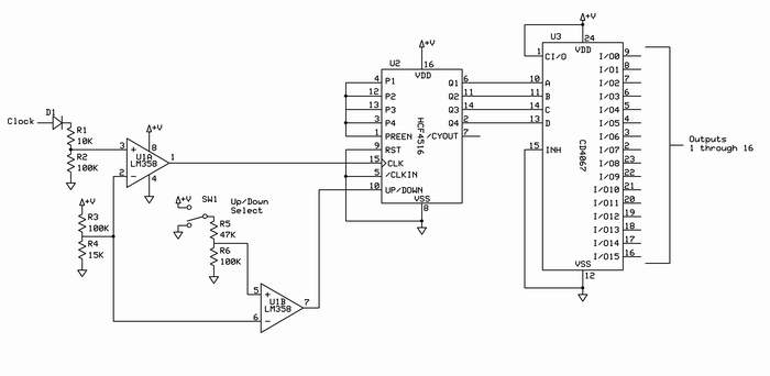

Here's another way to get a 16 step sequence with relatively few components. The CD4067 16X1 mux seems well suited for it. A bloody big IC, though - it's a 'double wide'.
In the schematic, I've got a dual comparator set up - one section handles the up/down switch, and the other section allow you to use an LFO (preferably sharp edged) from the SL to clock it. It'll accept a bipolar LFO.
Of course, missing is a manual step, and also a manual reset would be nice. Both of these come in handy when programming the steps. That would be fairly easy to put in with another dual comparator, though I'd have to play with it to see if diodes would work suitably as an OR for the clock and step inputs, or if it would be better to resort to an IC (which means, um, another IC would be needed). A debounced momentary switch would be good for both a step and reset function. Check out how Ken Stone handled momentary switches on his Pulse Divider/Boolean Logic module here:
http://www.cgs.synth.net/
That's where I lifted the comparator scheme anyway Very Happy . I've built the Pulse Divider, works pretty well (and comes in handy for sequencing, too).
The same thing could be applied to the dual decoder schematic I previously uploaded. That configuration would make it possible to switch from a 16X1 sequencer to an 8X2 sequencer. If you don't have CD4028's, then a pair of CD4051's could be made to do the same thing by feeding +V into the input (as done with the CD4067 on this schemo).
For the solution to the CD4017, I'll leave it up to you guys to get it purring. I've run a single 10 step sequencer using a CD4017, but I got lazy trying to figure out how to make it do anything higher than that (using two of them). The parts count to make it work made other options look more appealing to me.
Scott
